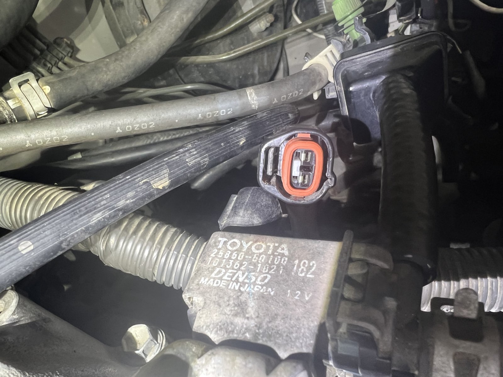

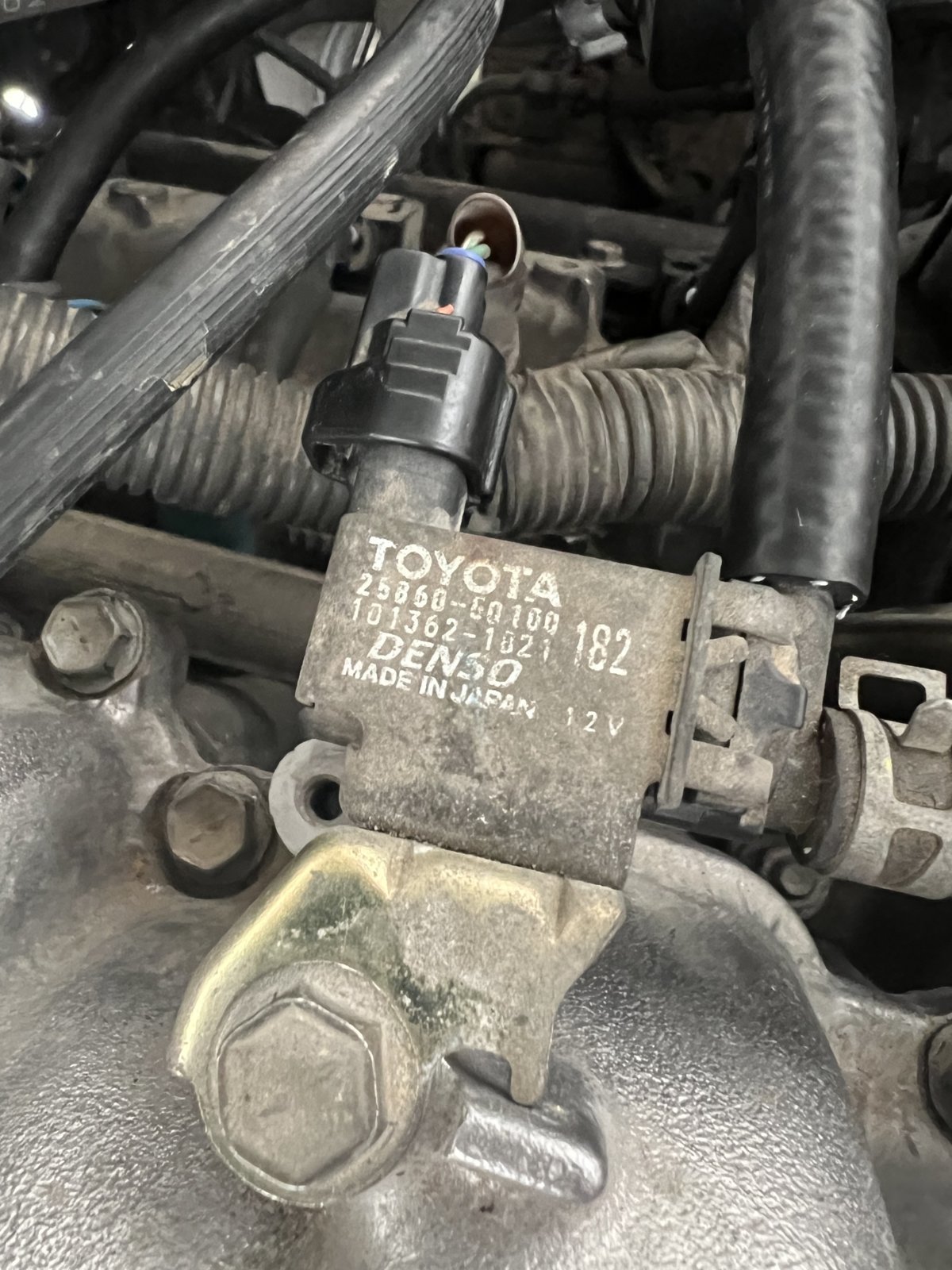

    The water temp connector is easy enough to order. The other connection that cracked that I’m attempting to order is proving elusive. I’ve spoken with 3 Toyota dealers and nobody knows what the part number is for the connector in the pics attached. It connects to the vacuum valve switch bolted to the top of the manifold. It has two wires coming out, a white and green and a brown and green. Any assistance there is appreciated.

    I think that is for the vacuum switching valve. Try 90980-11156. If that doesn’t work PM me your email and I send you a pdf with connectors from the catalog.

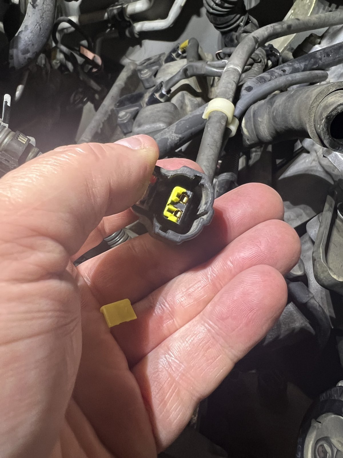

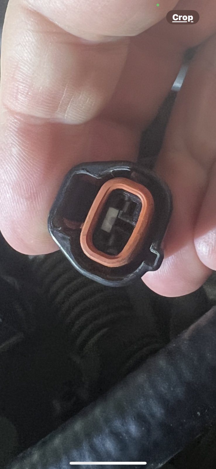

    @daveeasa you seem to know connectors well, any idea what this one is?

    Yup that’s the same as the 11156 connector. I’m gonna order 1 too as mine cracked taking it off today. Thanks Dave

    Definitely seems like you identified the Toyota part number. I searched off mental history as this connector is used for 3rd gen Tacoma fog intercept as well as sidemarker duty on 2nd gen Tacoma and whatevergenisthecurrentone T4R.

    After many attempts that was the same part number the closest dealer ordered so it looks like we got it right. Thanks for the help!

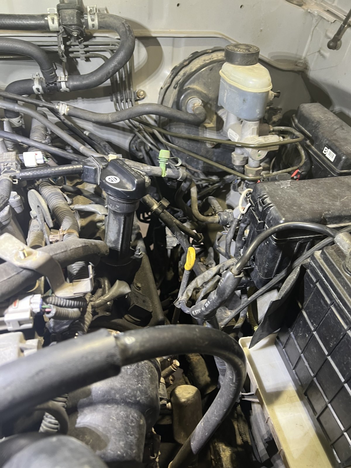

  28. Jul 1, 2024 at 1:33 PM
    #118
    MannFrank86
    MannFrank86 [OP] New Member
    Apr 12, 2023
    #95360
    148

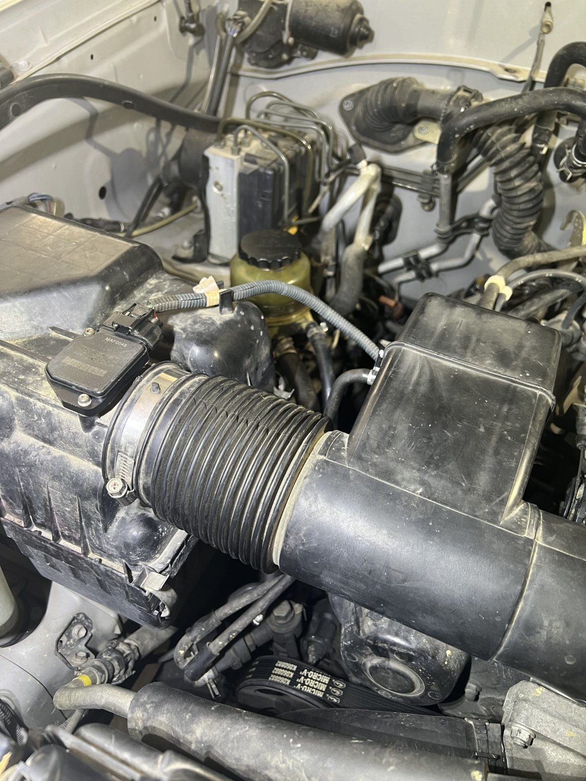

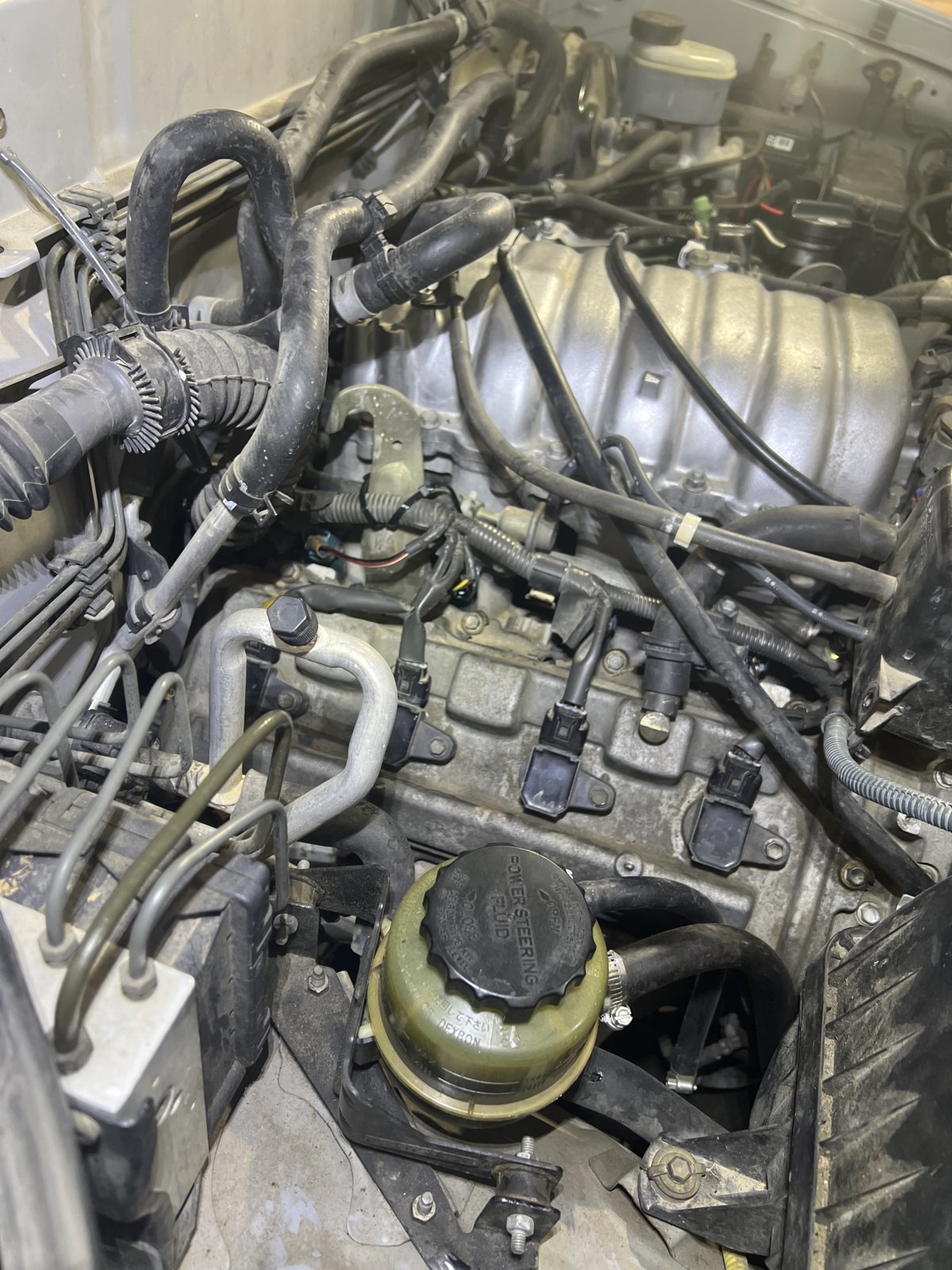

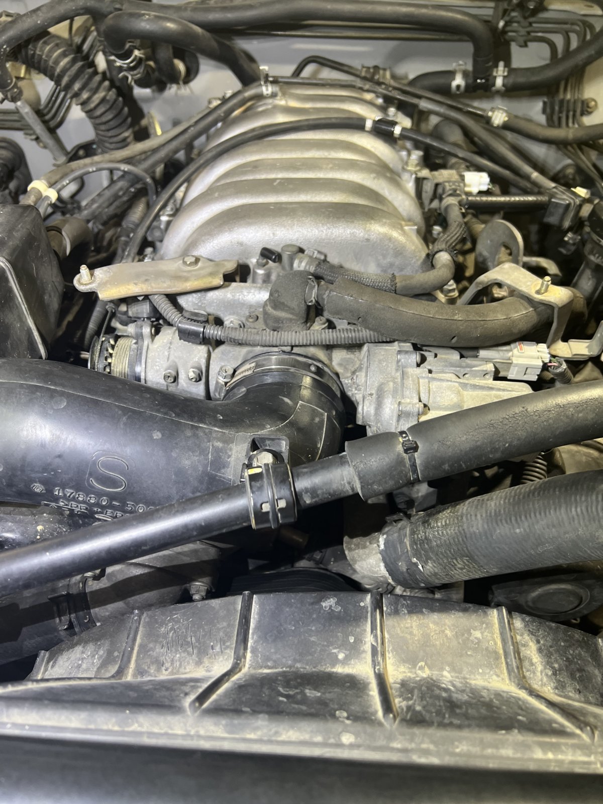

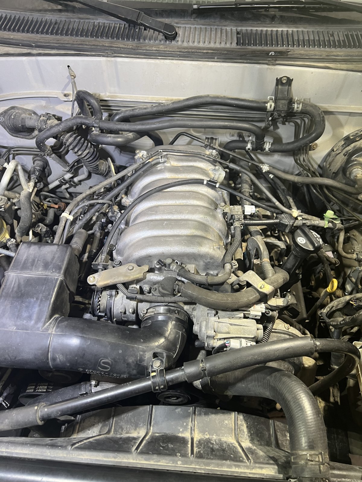

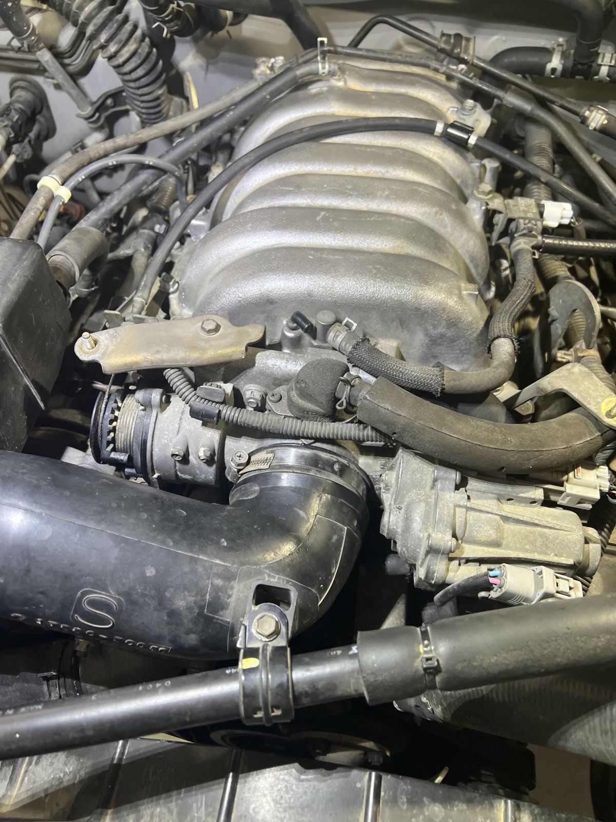

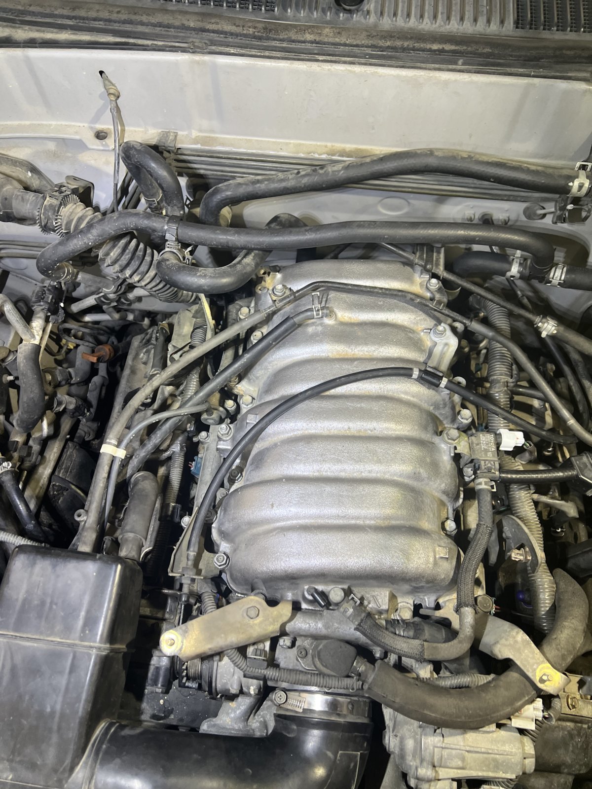

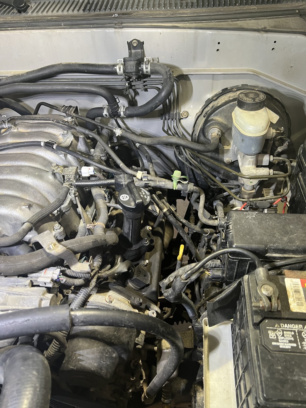

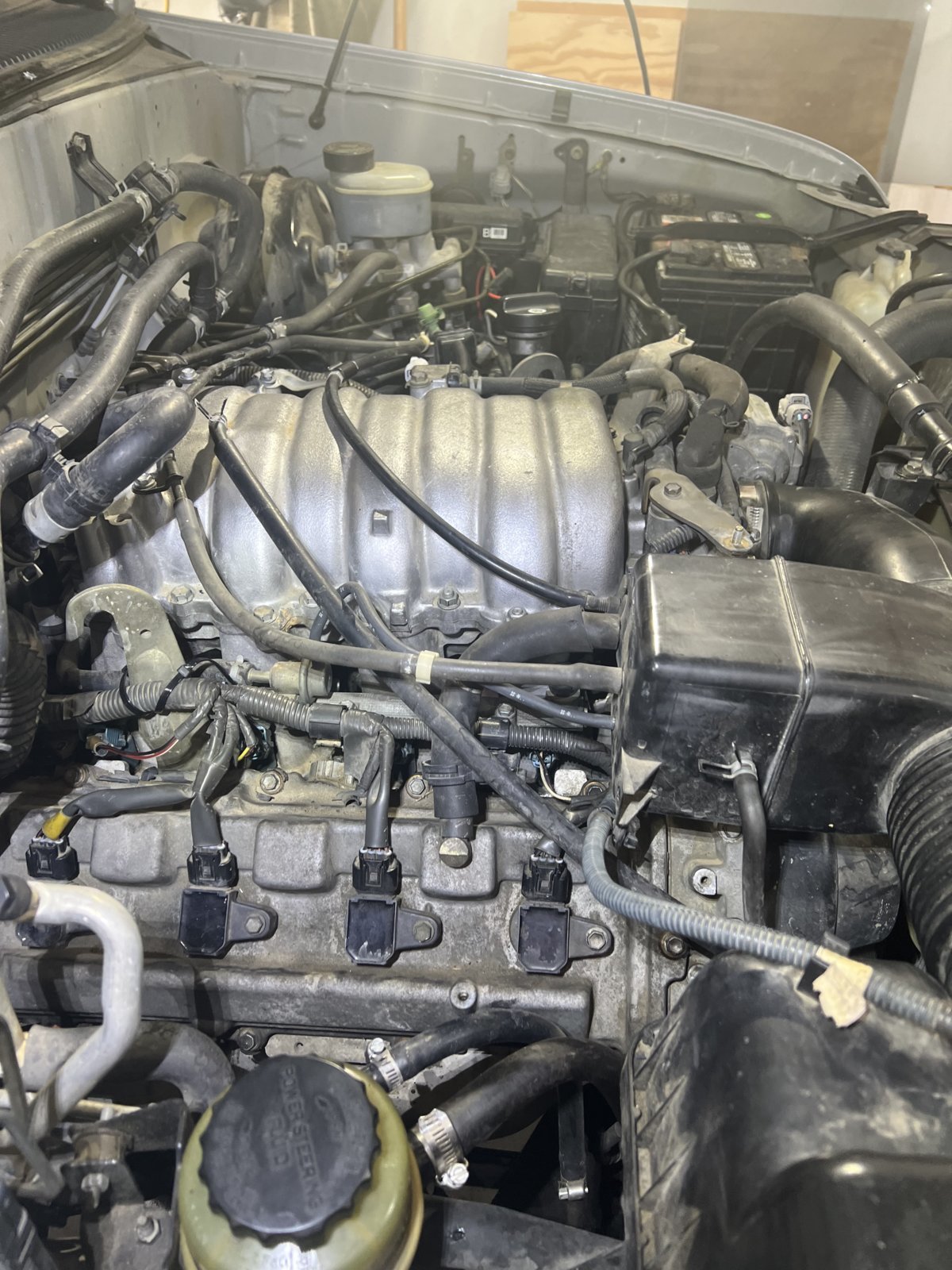

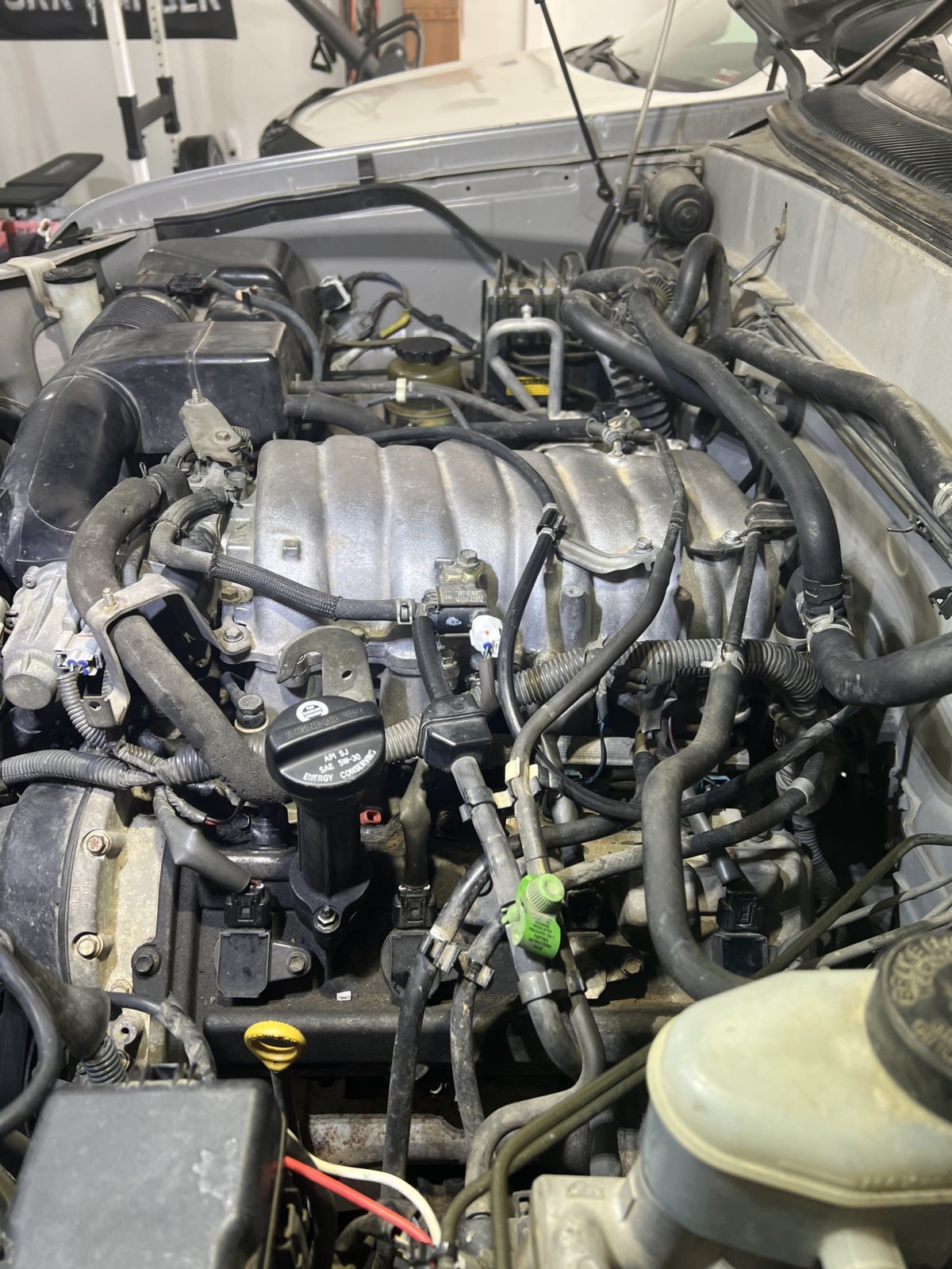

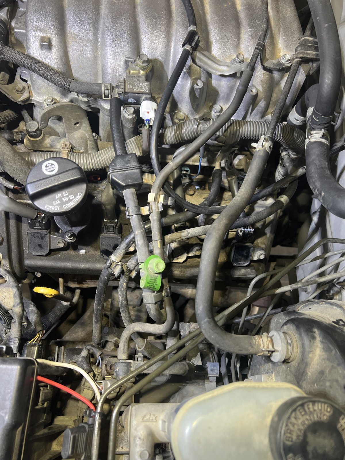

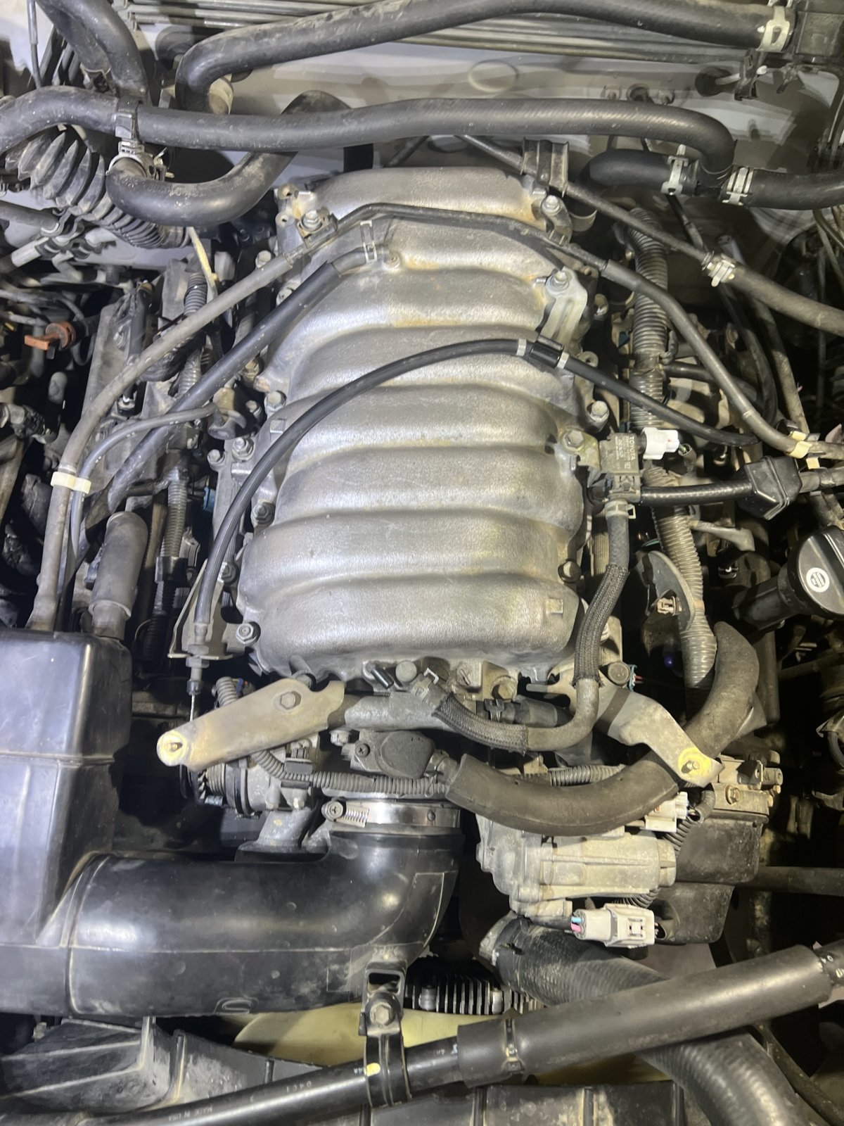

    Update - I decided to try and take it for a spin around my yard just to see how it would handle gear changes, shifting, etc. Well, I put the vehicle in reverse and the vehicle runs VERY rough. I backed out of the garage and put it into drive and it ran just as bad as Reverse. After about 40' it was stumbling and running pretty bad so I put it back in the garage and shut it down. My mechanic is 5 miles away so I may have to have it towed if I can't at least get it running decently, regardless of any dash lights. The pop heard in the video link from a few hours ago has not happened again.
    I did run the codes again and all it still shows is P1300. I am wondering if this is as simple as a vacuum line that I've attached to the incorrect spot. I looked over everything and it looks right to me but I could be missing something. Any merit to that line of thinking?
  29. Jul 1, 2024 at 2:47 PM
    #119
    bfunke
    bfunke Tundra Curmudgeon
    Oct 13, 2019
    #37321
    2,726
    South Carolina
    2018 SR-5 CM 5.7, 2000 SR-5 AC 4.7L

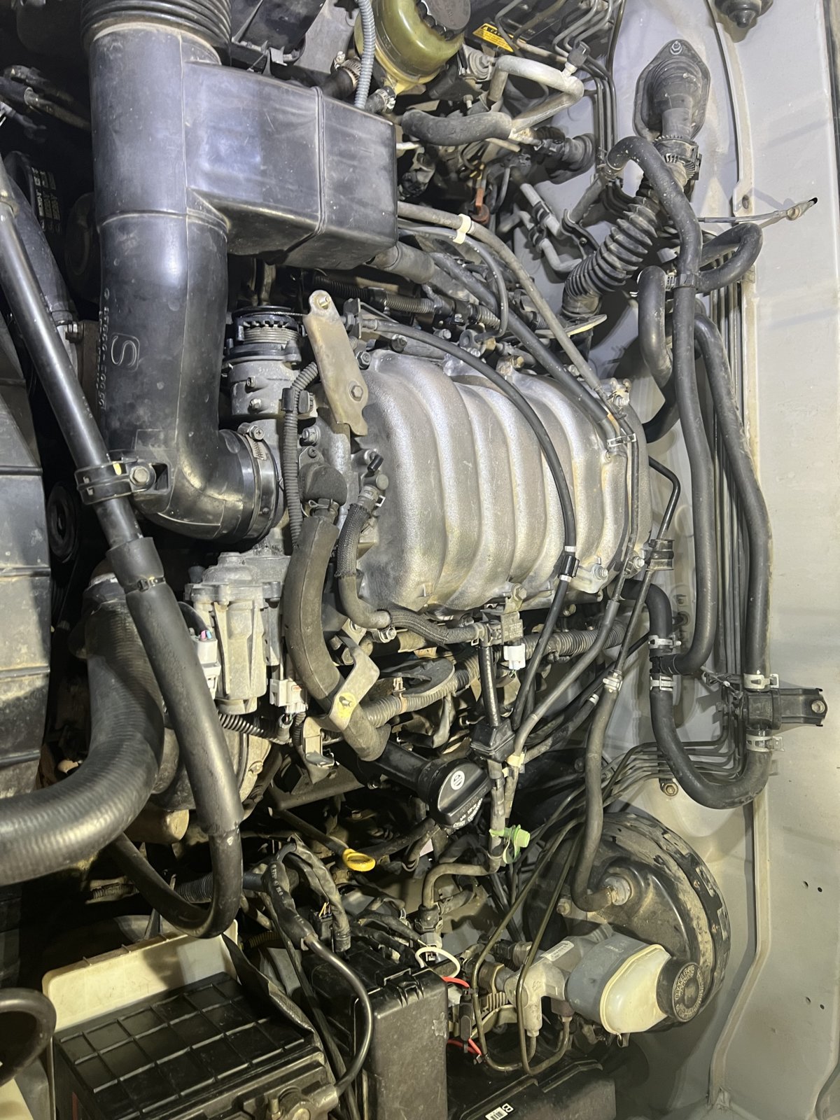

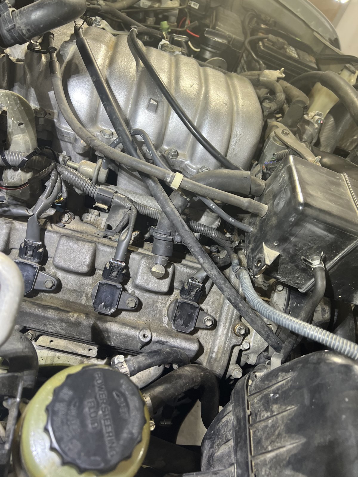

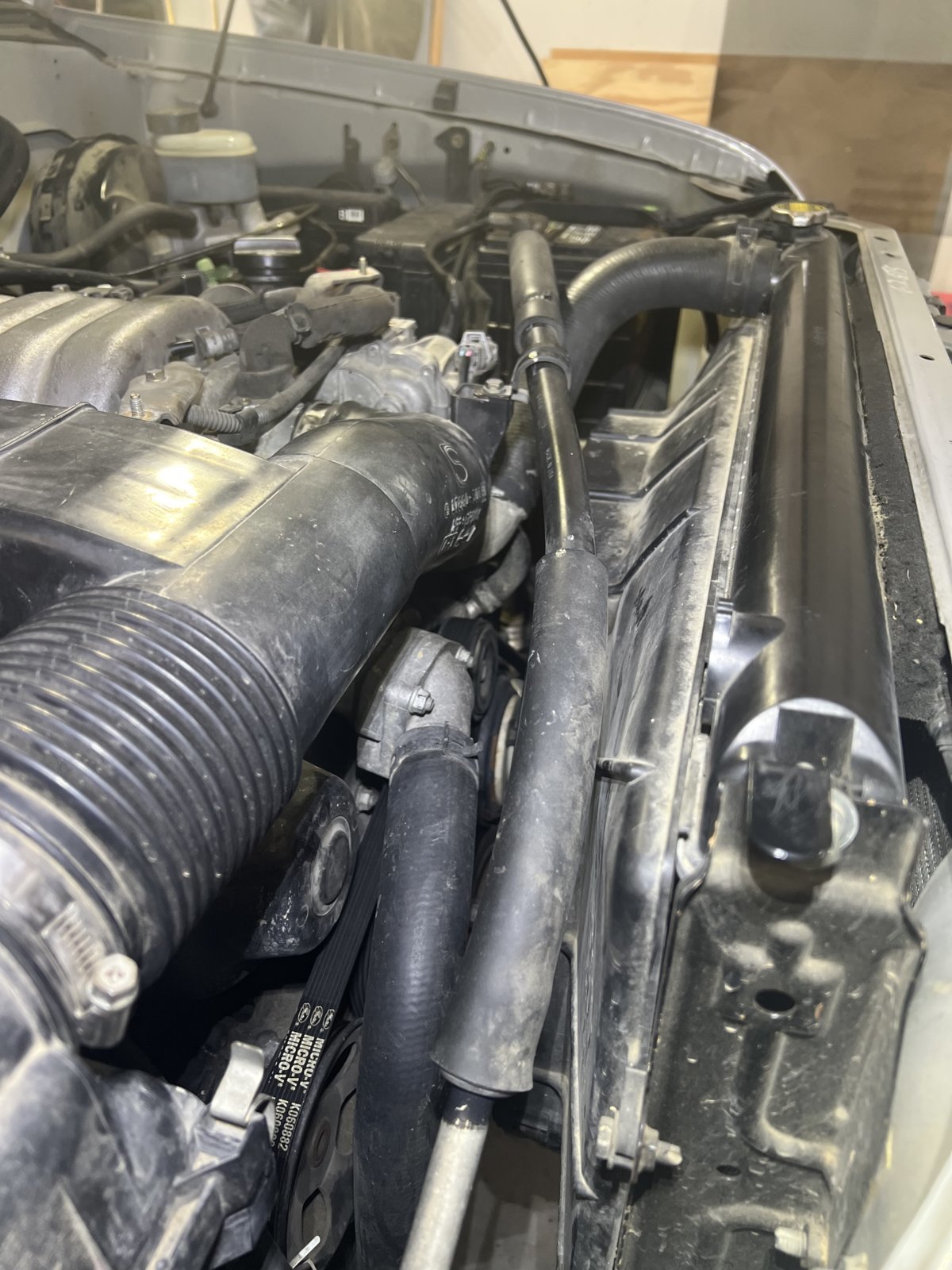

    Post some pics of the engine and bay from various angles and we’ll compare to known good configurations.P1300 is igniter circuit malfunction. Confirm all coils Denso and carefully check wiring and connectors seated properly.

  30. Jul 1, 2024 at 3:40 PM
    #120
    MannFrank86
    Apr 12, 2023
    #95360
    148
    The coils are all original so I’m not sure of one is broke or what. I’ve checked each coil connection and injector connection multiple times and they all are clicking in. I see no damaged wires. Below are pics. Hopefully they work. If you need a specific angle, let me know and I’ll zoom in more. Thank you. IMG_4708.jpg IMG_4709.jpg IMG_4710.jpg IMG_4711.jpg IMG_4712.jpg
