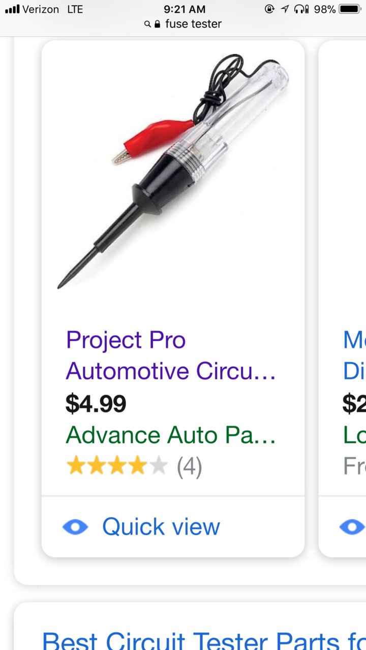

    Are you using a fuse tester or you doing visual checks?

    I’m going to use a fuse tester tomorrow, I don’t have one and I told a buddy at work to bring one tomorrow. If that doesn’t work I’m not going to screw around with it anymore, I’ll be taking it to the dealer. I’m pretty worried, definitely learned a lesson

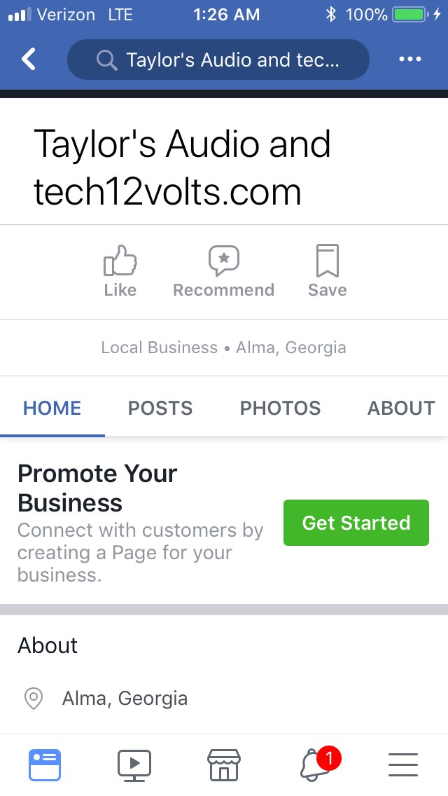

    I also think you should contact James Randy Taylor @ tech12volt . I bought my setup from him too. Really smart guy

    Does anyone have contact info, he has a shop or what? I don’t have a Facebook so I can’t look him up there

    +1 for James at Tech12volts. Great guy. Shoot him an email, he will respond quickly.

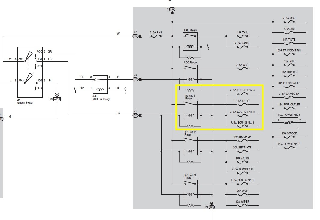

  20. Jan 4, 2018 at 10:38 PM
    #50
    TundraTex
    TundraTex FRAC On!
    Sep 9, 2016
    #4476
    1,181
    Lou
    DFW Texas
    '16 TSS CM 4x4
    I took a look at the electrical wiring diagrams. I didn't see what year truck you have, but this info is for the 2014 to pre-August 2017 trucks. LH IG is the Left Hand Ignition fuse. It's a 7.5 amp fuse that directly powers the Head Unit through Pin 1 of the 28-pin connector (J135) on the Head Unit. It also feeds the J29 Flasher Relay assembly.
    The LH IG fuse is gets it's power from the 150 A LH-J/B Fuse through the IG No. 1 Relay and should have 12 volts when the key is in the "On" position. I would pull the LH-IG fuse and check the fuse socket for 12 volts. (check both terminals and remember the key needs to be in the ON position). If you have power then the 150A fuse and relay are good. If not, I would go to the relay and check the power input there. If that relay is fried, it would cause lots of problems because that same relay also feeds ECU–IG1 No. 1, ECU–IG1 No. 3, and ECU–IG No. 4 (all 7.5 amp fuses). So if you haven't already checked those, that would be a good idea as well. If the ECUs are not getting their IG power it could cause the type of issues you are seeing.
    Good luck with your troubleshooting...

  21. Jan 5, 2018 at 12:50 AM
    #51
    Tacogrande
    Tacogrande New Member
    Jul 23, 2015
    #1564
    1,652
    Jeremy
    2016 SR5 dbl. cab long bed gray
    Husky weatherbeaters,short antenna,window deflectors
    Tundra Tex is The Man but he said his truck is a 2008.
  22. Jan 5, 2018 at 3:59 AM
    #52
    tmart
    tmart [OP] New Member
    Jul 9, 2017
    #8463
    351
    Travis
    Wow that’s great info, does it apply to my 08? And I’m not an electrical guy, how do you check the fuse socket for 12 volts? I’m going to pop a new fuse in tomorrow and see if that works and if not I’ll get started on doing the steps you explained. Thanks so much for all the help guys I really can’t explain how grateful I am for you guys and this forum, I’ve been really stressed out over this

    To check the fuse socket you would pull the fuse from the socket and probe both sides of the socket with your test light or multimeter.
    NewImprovedRon likes this.
  24. Jan 5, 2018 at 5:05 AM
    #54
    tmart
    Jul 9, 2017
    #8463
    351
    Travis
    Hmm the little fuse tester I borrowed Wouldn’t fit far enough in the socket I think
