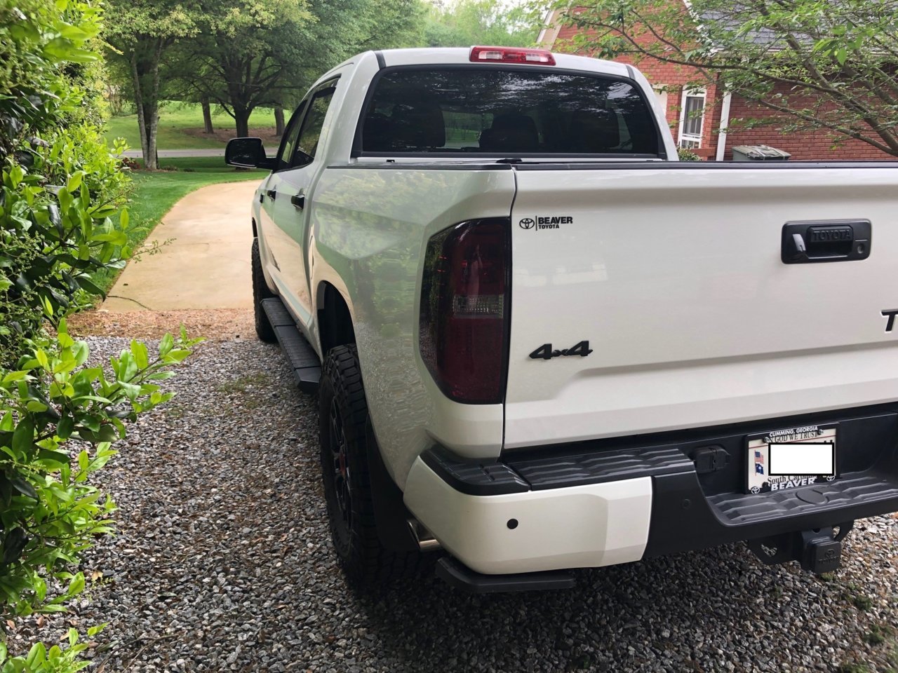

    I’m pretty sure the last set of Spidertrax I installed had a torque recommendation of 135 Ft-lbs and also came with red loctite so I was surprised about the BORA instructions and their voiding of the warranty if loctite is used. Maybe blue loctite is a little better than red for this application...

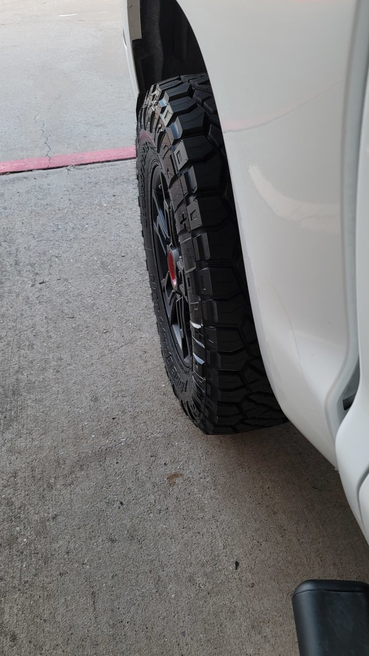

    This is a 1.25" spacer with 285/70 on stock TRD rims. My calculations it gives me an offset of 28. Installed properly with blue loctite and retorqued at every rotation. No issues and a mean look.

    Oh man I would love to see some more pictures!
