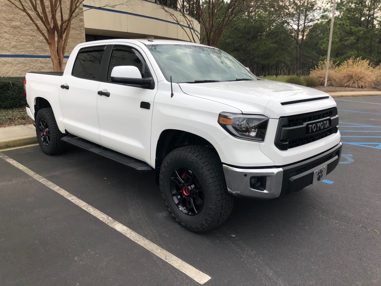

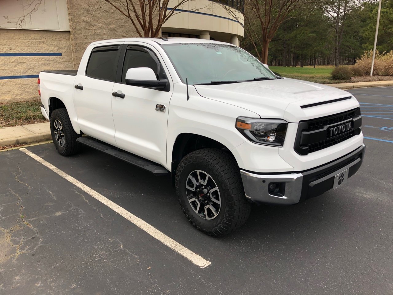

    Here's a pic with TRS OR wheels and 1.25" Spacers:
    And here's a pic with Pro BBS wheels and 1" BORA spacers:

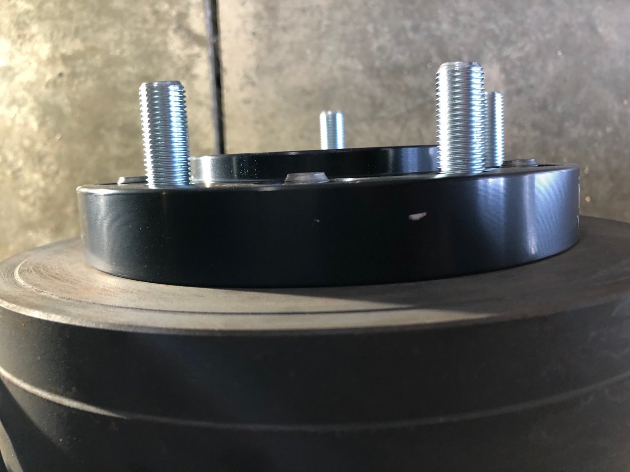

    Thanks for the compliments. I was worried at first about the BBS wheels, but they are growing on me very fast. I had an '06 Tundra but never installed spacers. I'll bet there are plenty of others on this site with good knowledge of your application if you search and ask. Another good resource is Wheelers Off Road or other shops that sell the spacers as they often know how spacers fit various vehicles. Below is a picture of the rear lug protruding through a 1" BORA spacer on the rear hub of my 2016 CM. If your stock wheels have "pockets" between the mounting holes they might accommodate a little amount of stud length. You should be able to easily measure your stud length to know how far they will pass through a given spacer thickness. If your studs are too long and no wheel pockets, then the other option is to trim the studs, which for me isn't a great thing to do.

    I was gonna ask about that (trimming the studs) with a cutoff wheel or something similar I suppose, but that sounds a little sketchy to me. I’ll take a peek and do some research and see where it goes, thanks.

    I'm sure trimming isn't a big deal, it just hurts me to do that sort of mod. to a newer truck. BTW, and not trying to insult your intelligence, but the other obvious option is to buy aftermarket wheels with the offset you want.

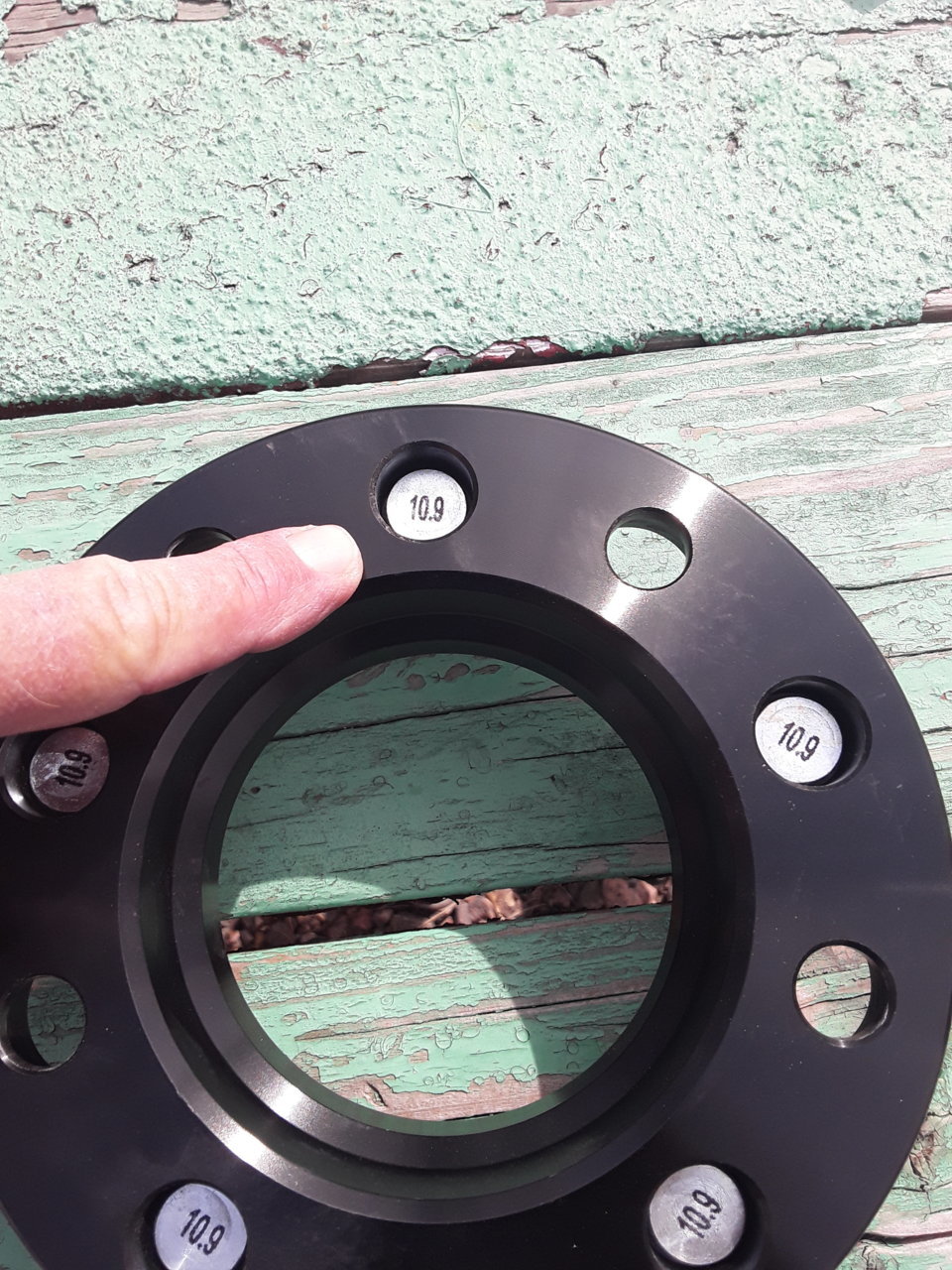

  9. Mar 25, 2021 at 6:02 AM
    #39
    43,564
    Rugged Ridge spacers are a good option too if the Bora's are hard to get. Made from 6061 T6 billeted Aluminum and hub centric. They go on sale every now and then. Decent warranty. 5 years.
    Aught16TSS and Badknees like this.

  11. Mar 25, 2021 at 6:14 AM
    #41
    43,564
    I wanted the Bora's too but ended up with the 1.25" Rugged Ridge. They are going on tomorrow. I'd beware of a lot of off brand spacers being sold on flea bay. Bora and Spidertrax are prolly the best but I couldn't find anything negative about the Rugged Ridge spacers. I even called RR first to get some more info from them directly. RR sells a lot of Jeep spacers among other Jeep goodies. They now offer spacers for the Tundra. 10.9 grade studs. Grade 8 nuts. Reasonably priced.
