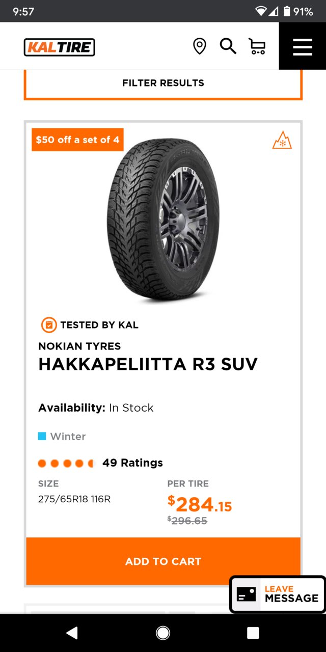

    It's our first year with the truck, luckily not much snow yet and I'm coming from all wheel tires on a 2WD Sienna, so can deal with it.
    But I think next year I'm going for a set of these too and make sure I get them on early for the snow. We can literally have snow/ice from Nov 01 to end of April, so it's a worthwhile investment.

    I have those tires on my truck and they are excellent in snow/icy conditions. I highly recommend them.

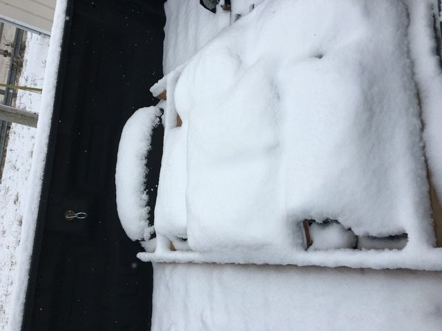

    These are my cooper discoverer m+s and the frame and sandbags in the back of my truck. The weight in the back plus the tires make it so I don’t randomly slide off the road. I live in Ontario where they salt and sand the roads, which is very helpful (though horrible for other reasons) but the 401 is a death trap when it snows hard despite the plows and brine and sand (3 people died on the stretch of 401 I consider my area last week) and if you live in the boonies they don’t plow your road at all (my road). As has been said, you can get by without winter tires, people did it for many decades, but there is no reason to not get them. You can get a set of used tundra rims on kijiji or craigslist for you Americans for peanuts and get a set of even used winter tires for nothing. My brand new discoverers in the stock 255/70r18 size were 175 each CAD...that’s regular price, and I got 50 bucks back from cooper. That’s really really cheap, and they work as well as any other brand I’ve ever had, and now my summer rims and tires will last twice as long...so I won’t be buying tires every 4 years.
    anyways, I think the OP gets the point lol.

    The problem is there is no weight on the rear axle, so even with descent tires your not going to get great traction. If you end up putting extra weight in the rear its going to help but also cost you in MPG, your better off just using 4WD as soon as the roads get slick, its not going to cost you much and the difference could be between getting in an accident or not getting in to an accident... I've also driven just about everything in the snow, trucks, jeeps, cars, even a Fiero (remember those)... You haven't lived until you driven a Fiero in a snow storm...

    Do you have a picture of your truck with these on, please?

    I'll take a couple of pics when I leave the lab in an hour.. what specifically do you want to see?
