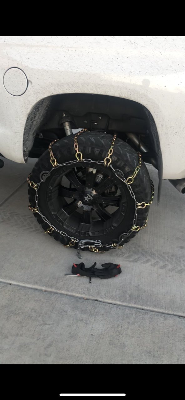

    They came in today!:cheers:

    Awesome that you got them, but you actually have them on inside out. The two hooks that curl on the outside of the chain need to face away from your tire or they will damage your sidewall.
    Jsena[QUOTED][OP] and usaf.2012 like this.

    First thing I noticed as well!!
    Congrats on the new chains!

    Wtf!! Lol, so I put them on the same way, with the Scam out but flip it like inside out????

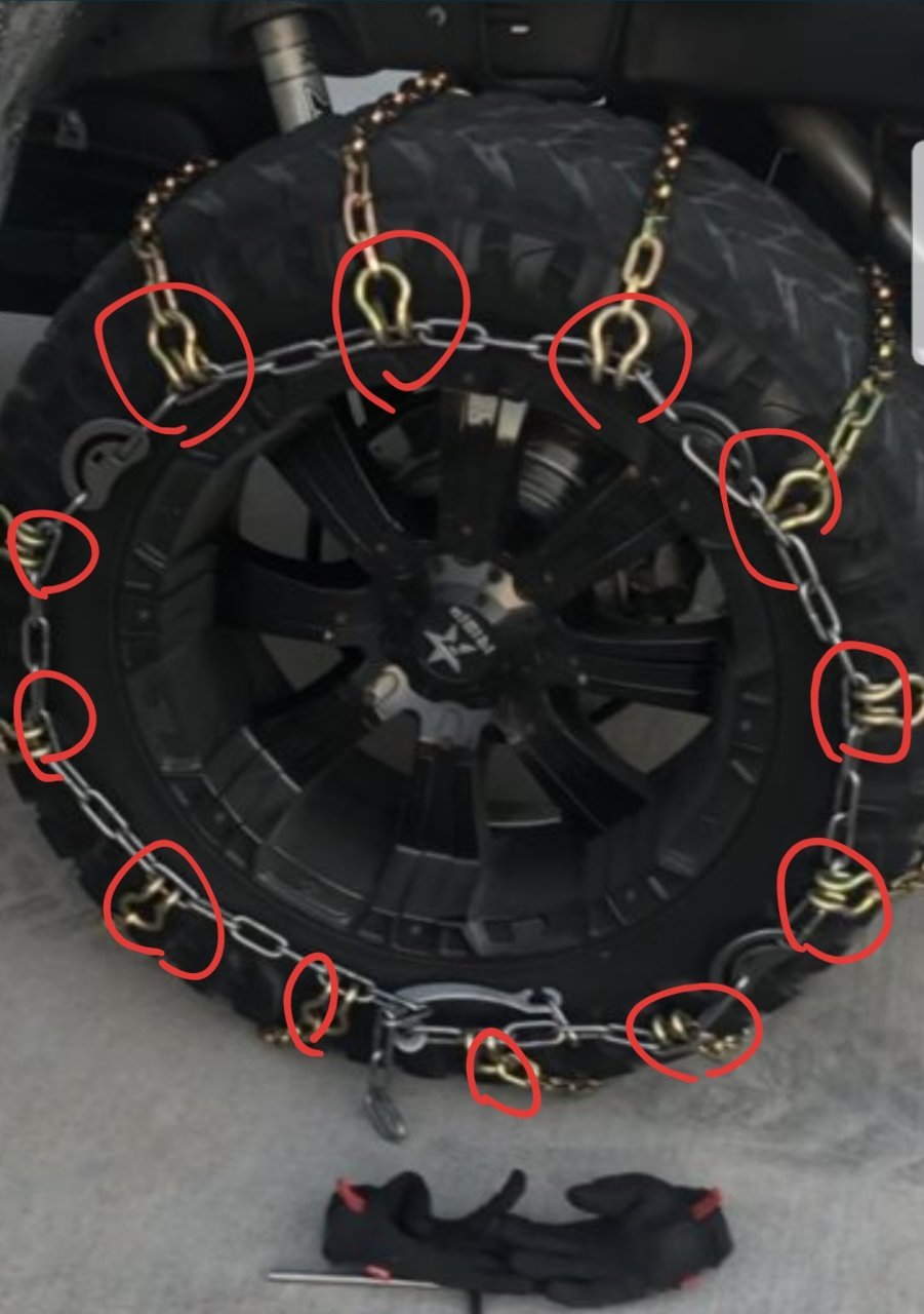

    Yup. The ones I circled here need to be facing out so nothing but smooth chain is on the rubber.

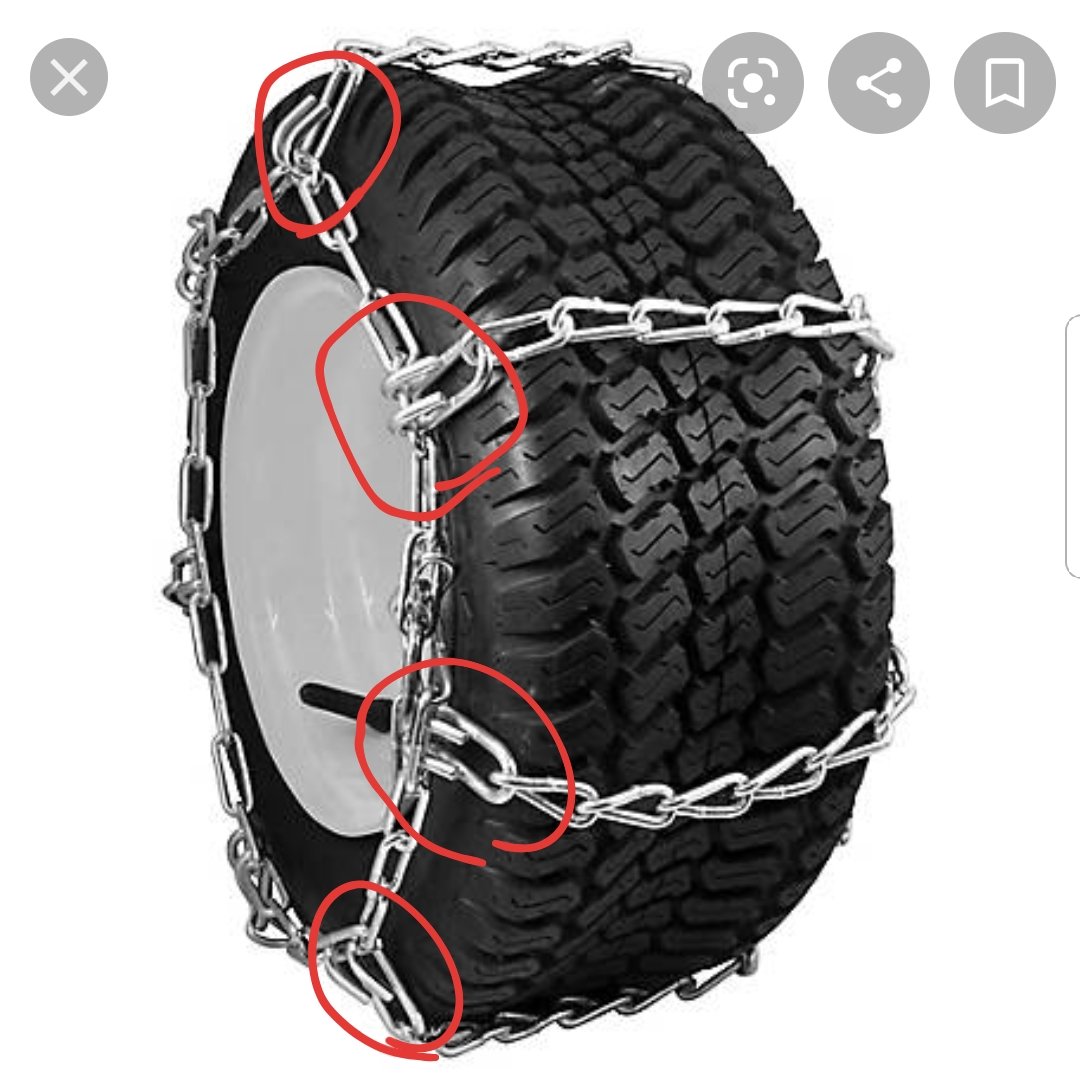

    Here's what you want the ends to look like. The chain ends face out to protect your sidewall and give more grip if in ruts or deep snow.

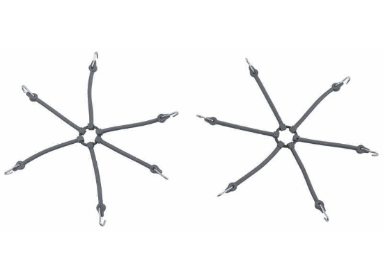

    You'll also want tightened on ther to keep the chains from getting too loose as you drive. A loose chain will cause LOTS of damage. Bungie cords can be used even, but make sure that the hook ends face away from the rubber. After you've got the chains and tensioners set drive a little ways at slower speeds (you don't want to go fast with chains anyway) and check/re-tighten the tensioners as needed.

    Ohhhhhh I got you... good looking out bros
