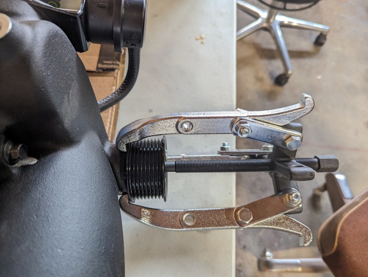

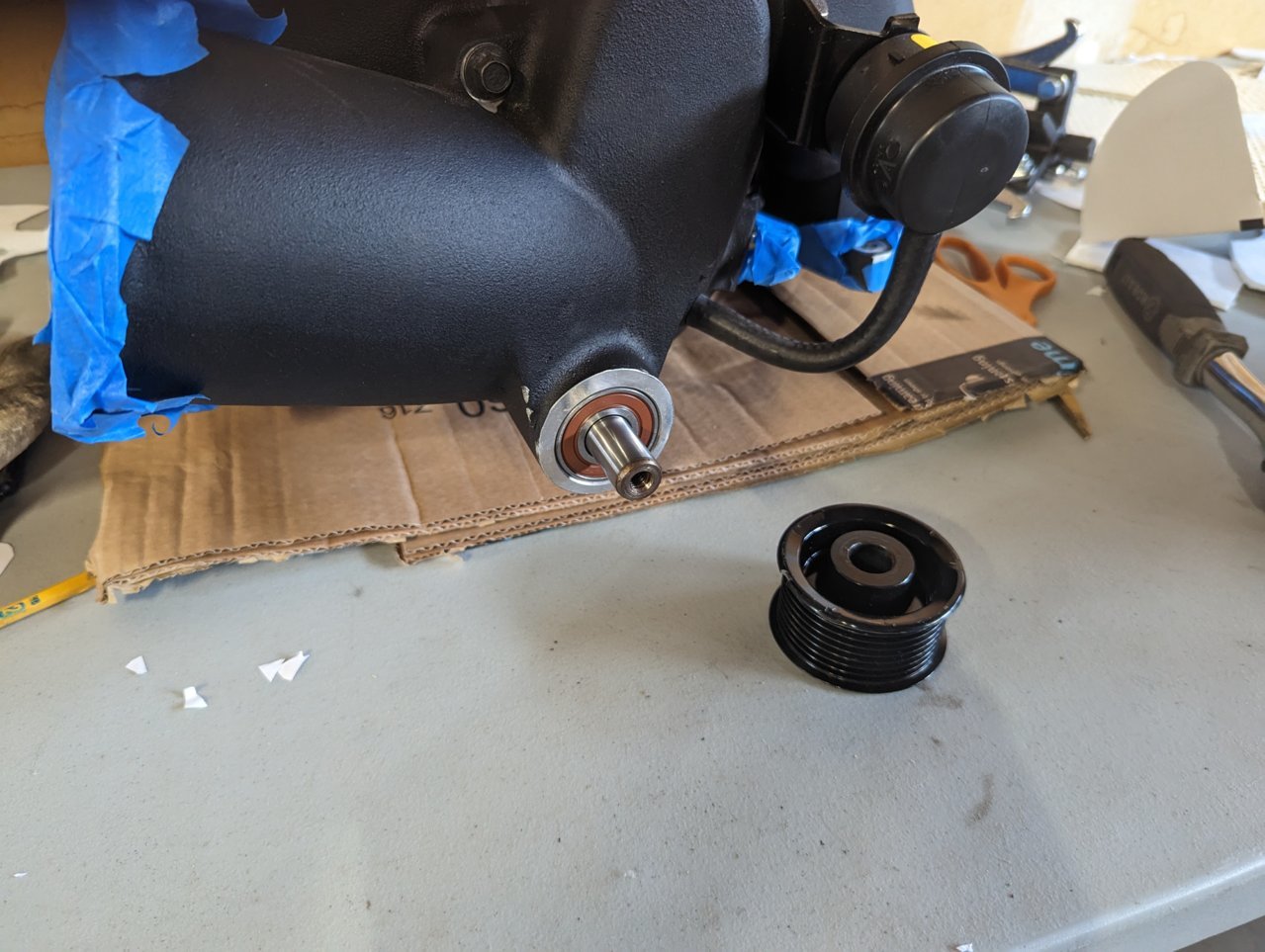

    @snivilous how did you remove the old pulley? I have a 3 jaw puller that I used on the taco s/c, but I also had the URD tool to screw into the shaft so that you don't damage the threads with the jaw puller. Unfortunately that is lost in storage somewhere. Have a 20-ton shop press at a friends to install the new hub. Also any advice on that process? I used a toaster oven and the URD tool on the taco and that was kinda a pain
    HulkSmurf14 likes this.

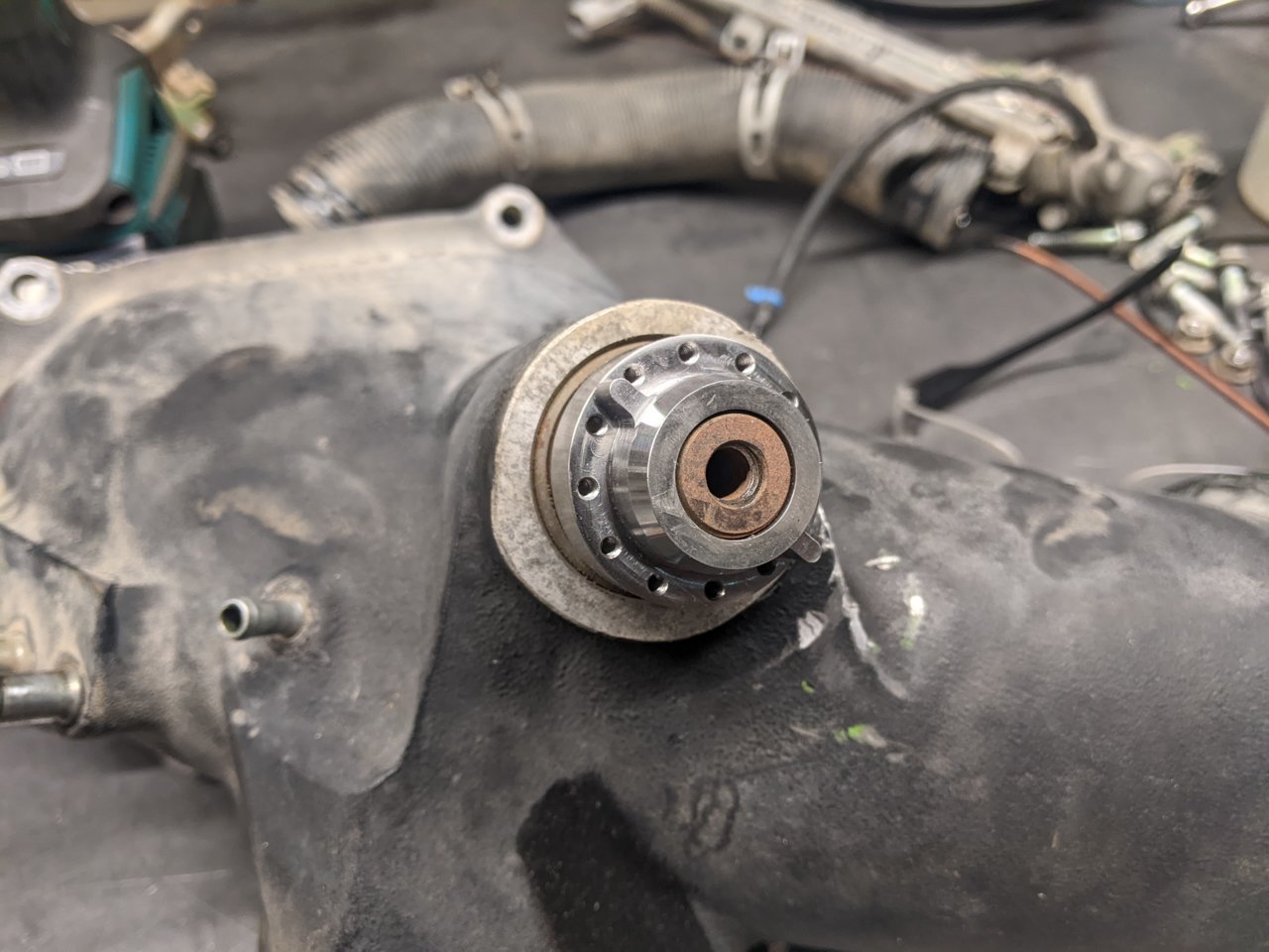

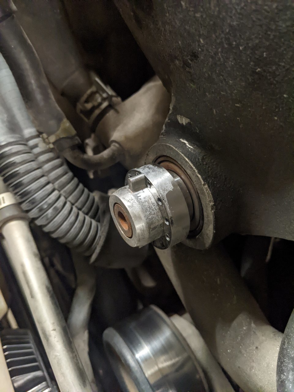

    Yes, 3 jaw puller. I think I rented one from the store the first time, and it was a bitch but worked. Similarly this time I forced a 3 jaw crank puller to work I had laying around. The key I found the first time was a metal backing, otherwise the puller just ripped through the aluminum. I cut out two sections of steel and welded them behind the pulley and then pulled on that. I honestly don't know what the best way is, maybe someone else can say. In the below picture you can see where I have the backing plate and then welded wire around the arms to prevent them sliding. Maybe a 3 jaw that can get in there far enough to pull closer to the center of the pulley (as opposed to just pulling the lip that holds the belt) and then weld or wrap a band around the arms so they can't move?
    For installation, that is something I've perfected :D especially in your case, and I would recommend to anyone else, unbolt the blower from the engine, just lift up the nose and then unbolt the nose. Since yours isn't installed yet this is the obvious way to go. You will see the back side of the nose shaft where it slides into the coupler (which I recommend replacing if it's not already brand new). I then use a socket between those three pins so the pins don't get loaded and potentially bend, and then just press the pulley onto the other side and squish it pulley - shaft - socket. The pulley hub needs to be pressed on so the outer face is flush with the end of the shaft.
    Installation of the hub should be super simple and easy, no risk of stripping out threads or needing to heat anything up.
    The hub has a relatively large and accessible lip and is a very strong stainless alloy, so in the event it needs to be removed I think it'd be easier than any press on pulley.
    With the hub installed I installed the supercharged so the pulley wouldn't risk getting beat up as you maneuver the blower, but it does make it a little annoying threading all the 4-40s in. I will say I put some anti seize on the mating surface of the pulley to the hub to help avoid galvanic corrosion since it's raw aluminum on raw stainless. The pulley is bi-directional so it's orientation does not matter.
    4-40s are pretty small and need very little torque, on the order of 5-6 INCH-pounds. Considering most people don't have anything that's reading that low and it'd be annoying to get a wrench in there and have the right size socket, I just put a dab of lock tight on and gently snugged them down with an Allen. The bolts ONLY hold the pulley from slipping off the front, and nominally take no load during operation. Additionally there are a huge excess of bolts, so don't over think it, just gently snug them down and the shear tabs do the heavy lifting, and if you ever break a bolt off or a bolt falls out or you decide to only run 2 out of 12 bolts, that should not compromise anything.
    I should probably send all this to Matt so he can print it off and put it in the packaging :D

    Sweet, thanks! After seeing the picture of that 3 jaw puller, I remembered I actually had to go back and rent the larger 3 jaw because it seemed like I was about to snap the bolt on the size you used! Then again I was working with a s/c that had 80k miles on it, maybe this one will be easier.

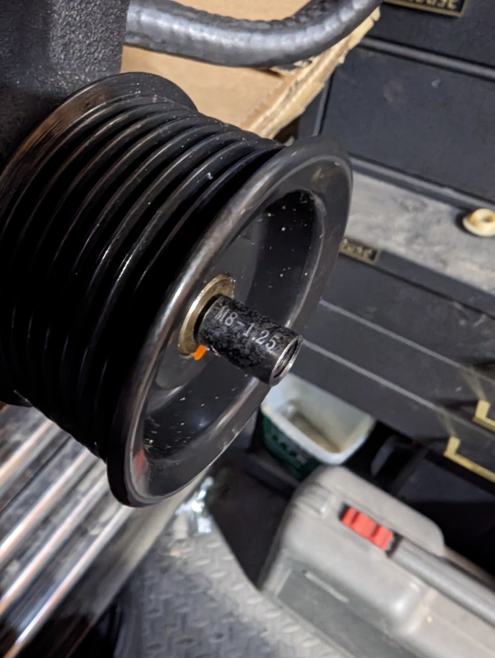

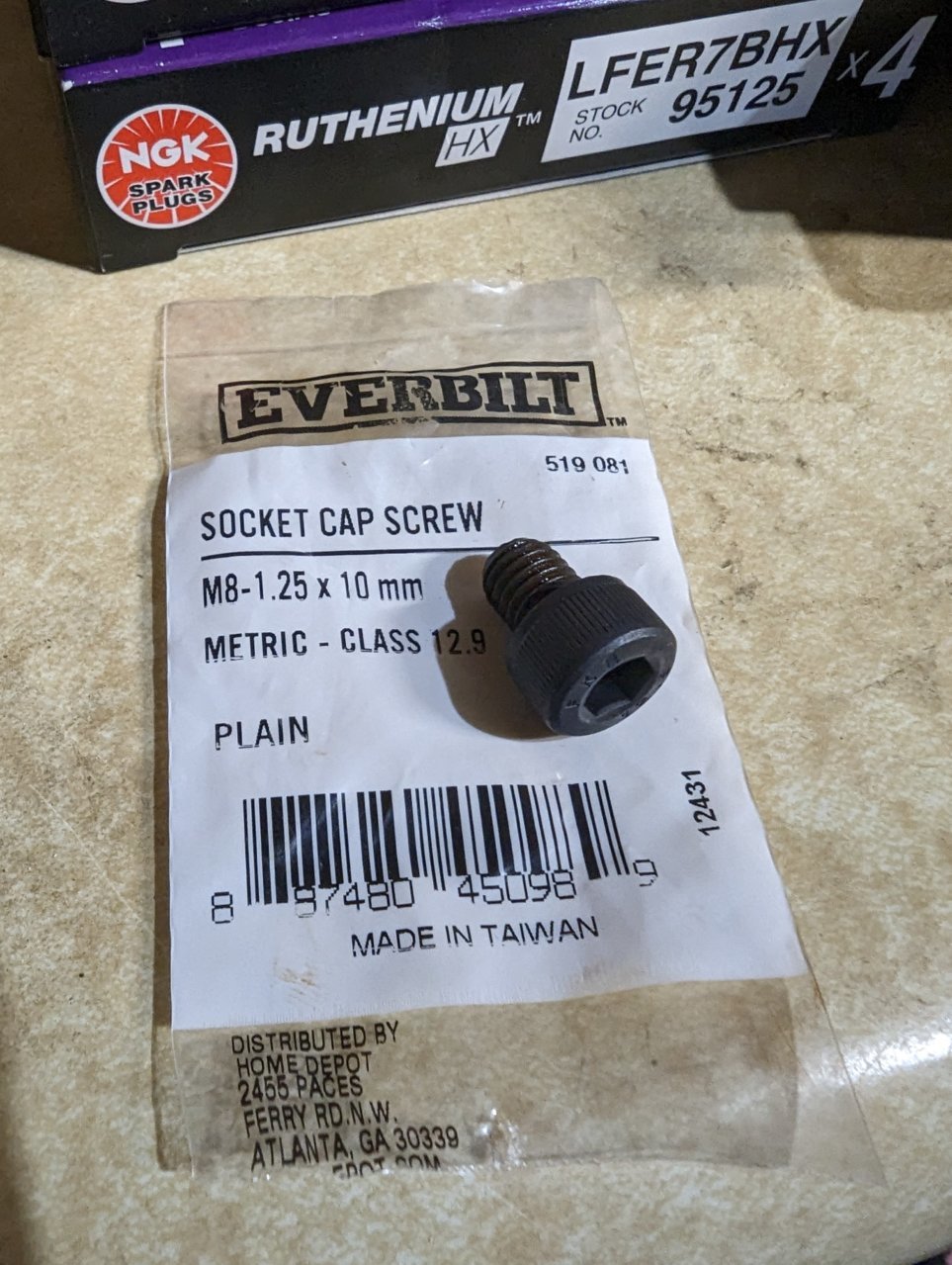

    To get the pulley off without damaging the threads
    $1.25 at home Depot, M8 x 1.25 x 10mm
    HulkSmurf14 and snivilous[OP] like this.

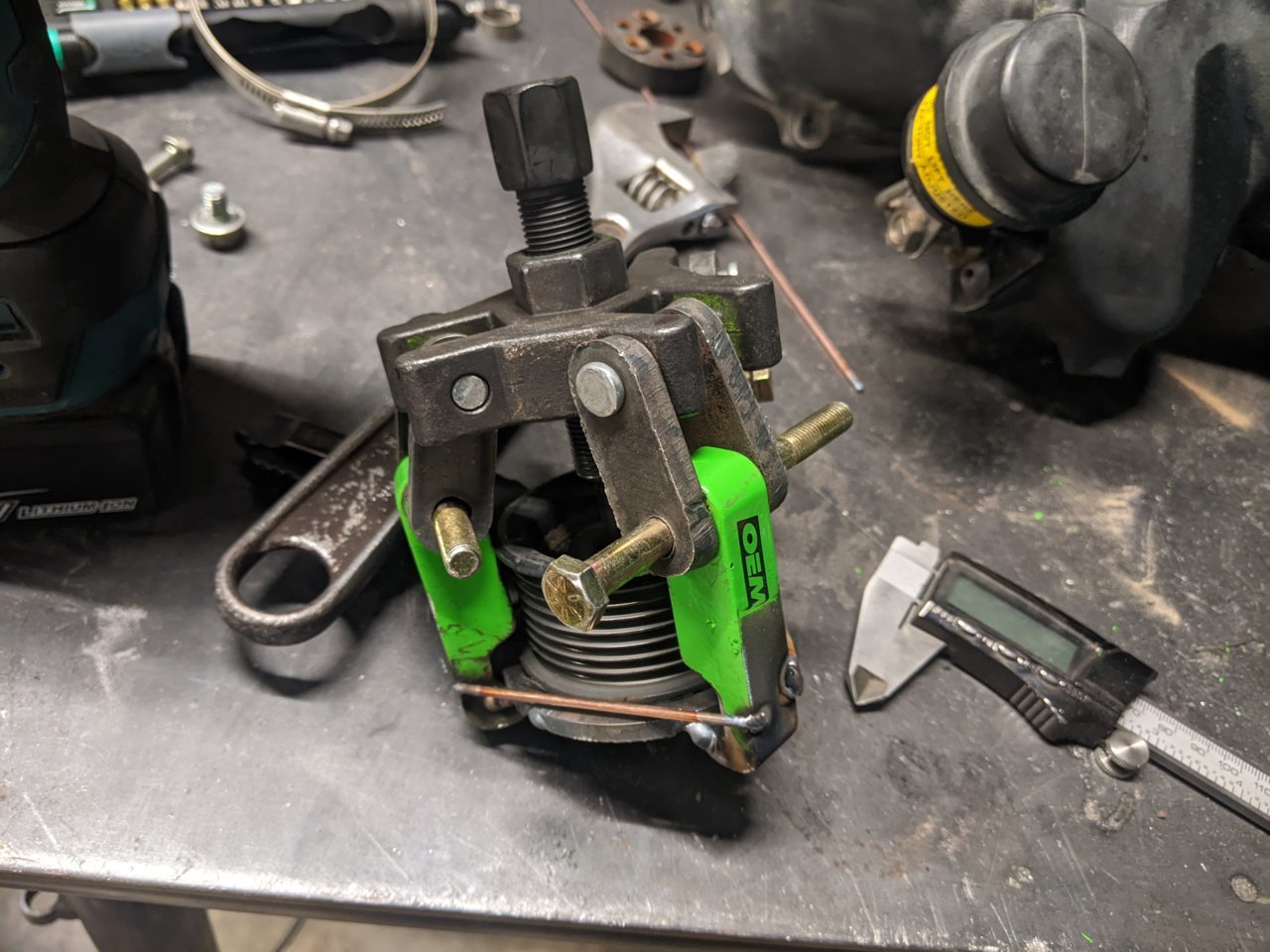

    I had to use a 5 ton 3-jaw puller. Always scary when you hear it pop loose! Lol

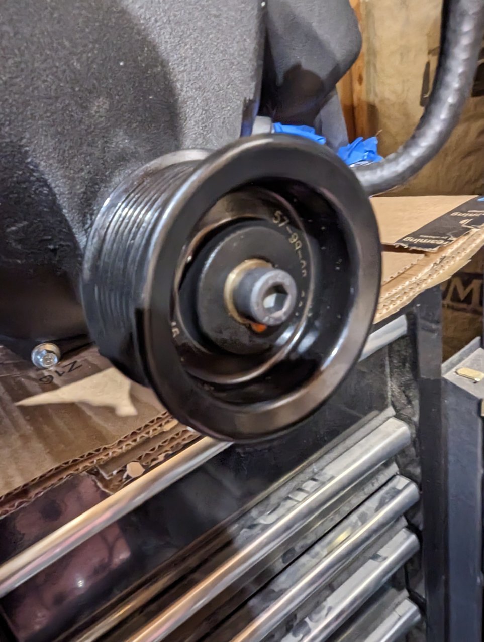

    Ready for the new pulley! If you use the hex head bolt to protect the theads, use plenty of anti-seize on it also. The when removing I just wrapped the shaft with cloth and used locking pliers to keep the shaft still, then unscrew the bolt

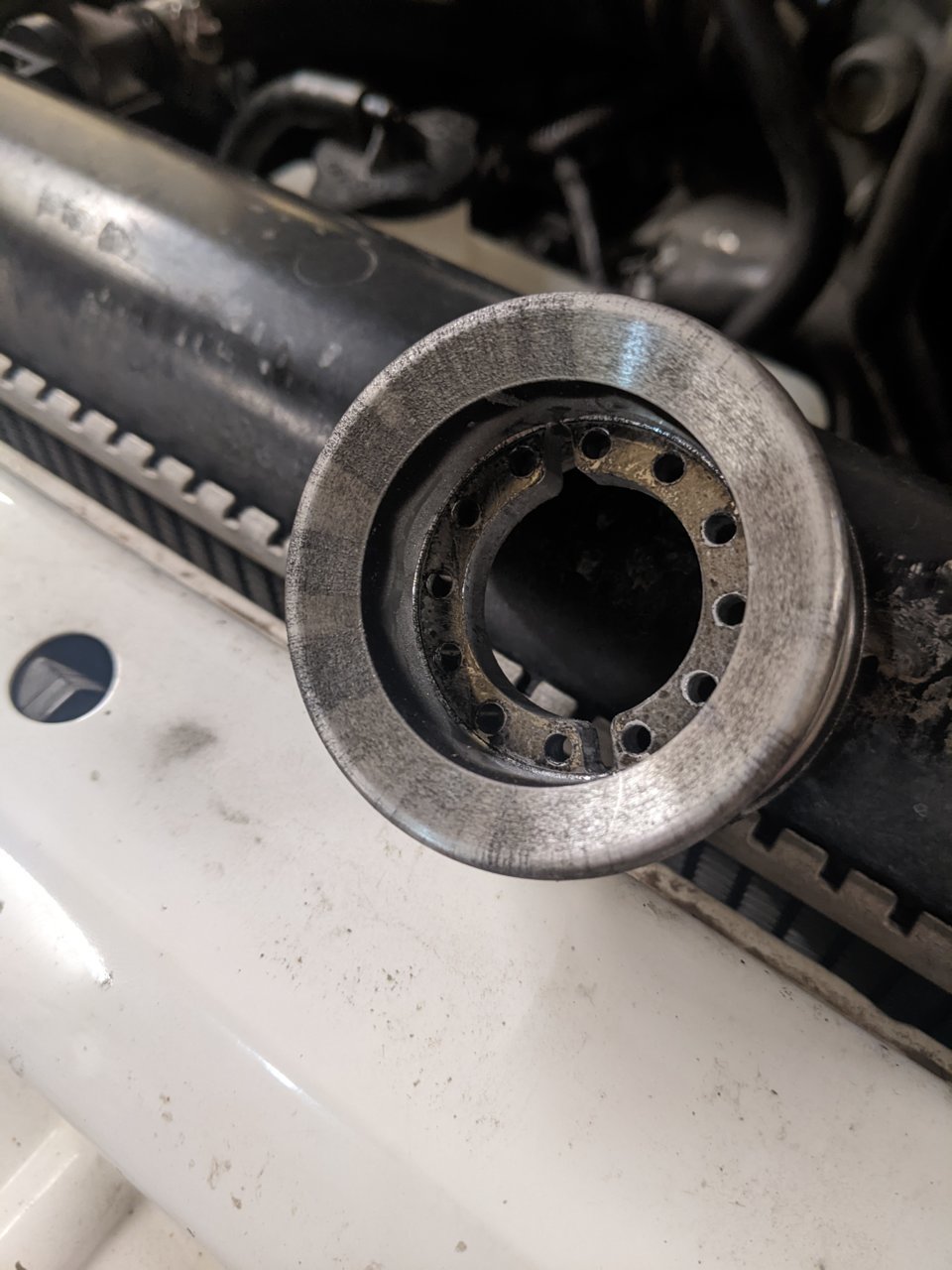

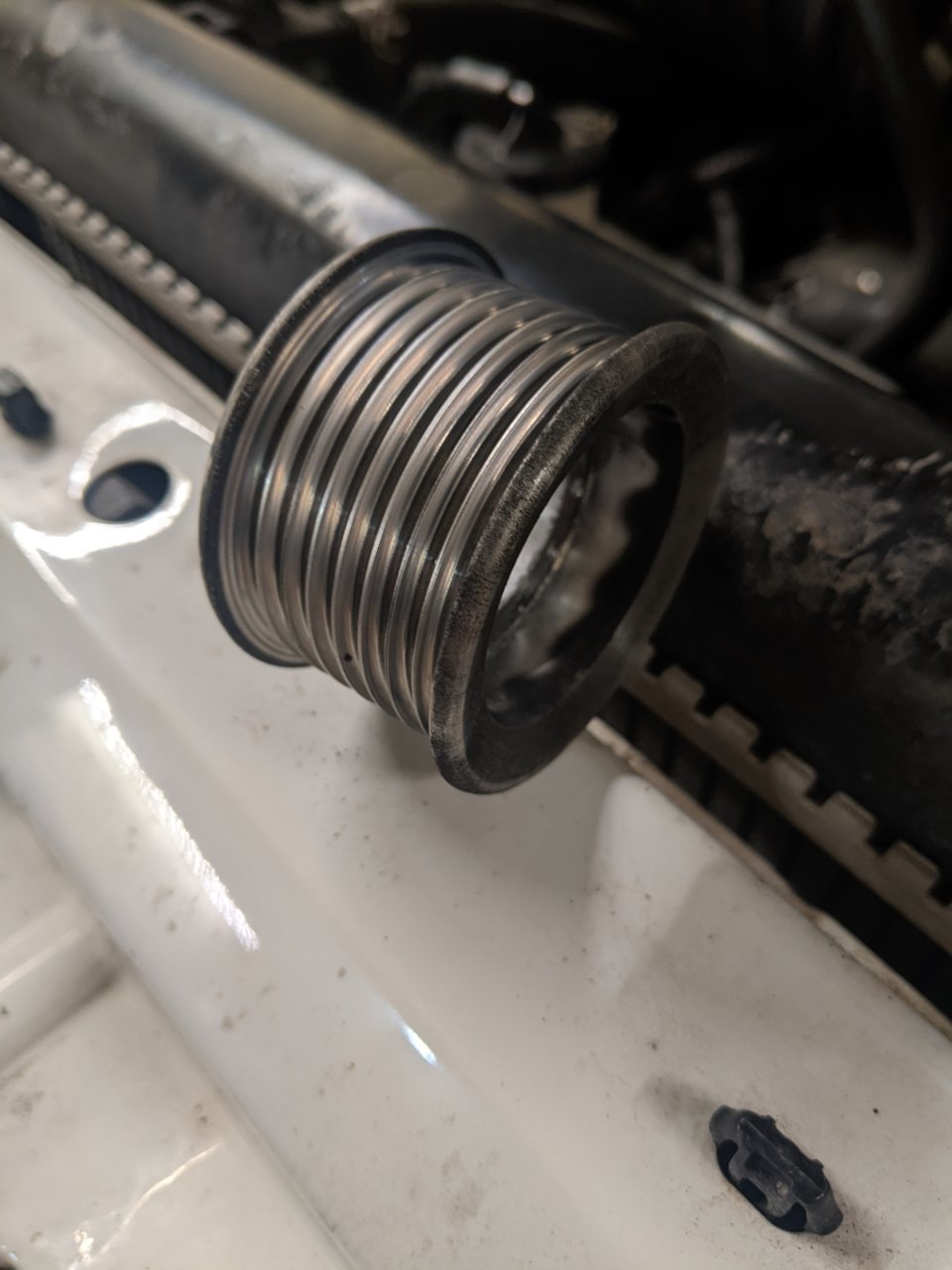

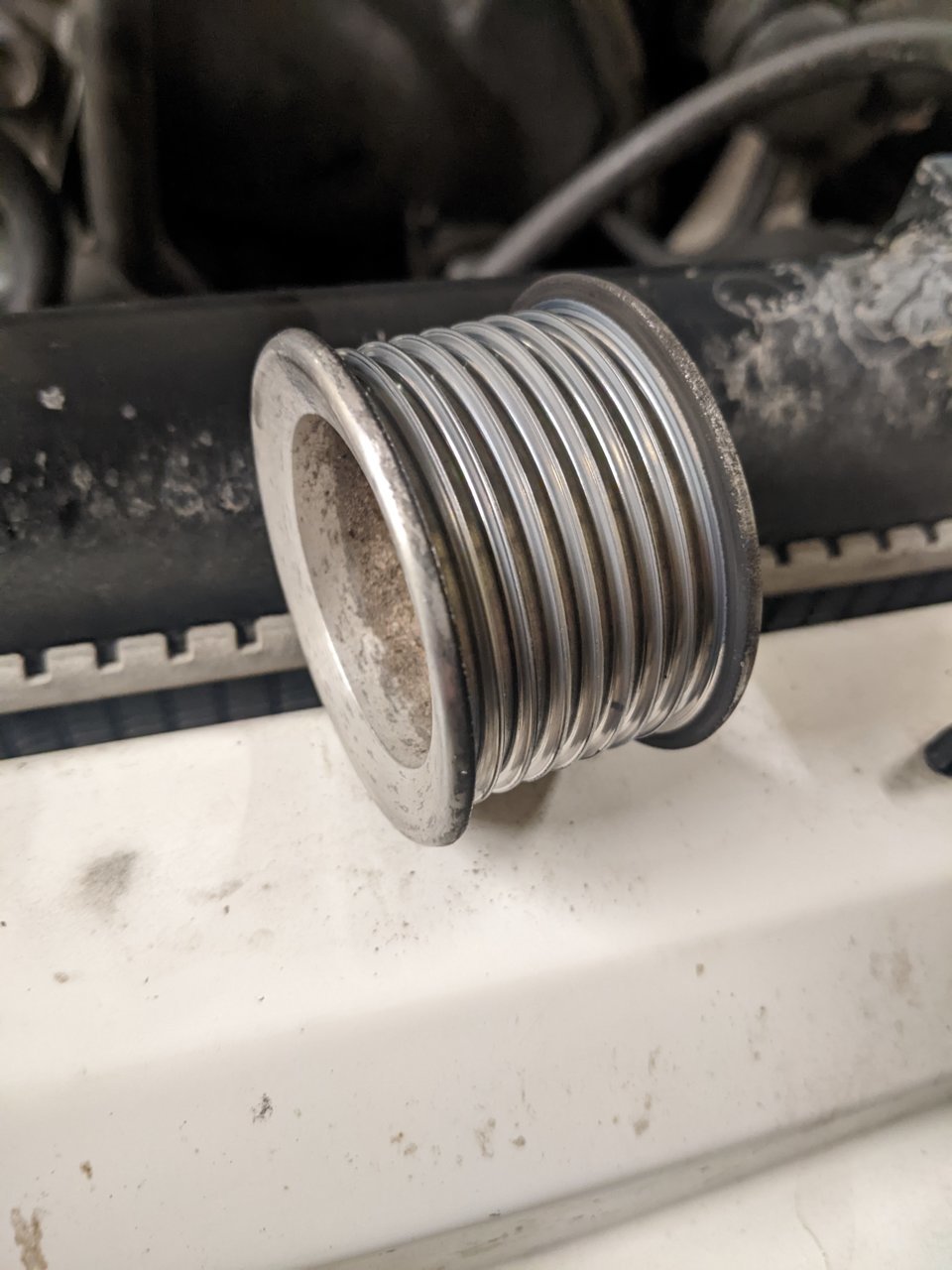

    I pulled the supercharger pulley off for the first time, nearly 5000 miles since installing it! Looks totally fine, quite a bit of oily residue around it but I suspect it's just from the anti seize between the pulley and hub interface getting thrown out. Wiped down everything looks pristine. Little bit of black marking on the front and rear where the belt extremities contact.

    Looks great and totally normal wear! We don't see that "stuff" on our powder-coated pulleys...thank you for sharing the findings @snivilous ! I can't wait to get our pulleys in!
