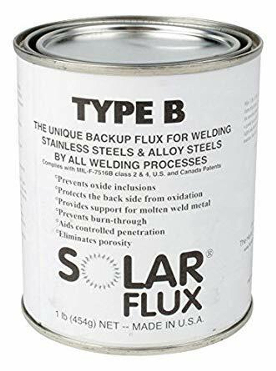

    #60646
    606
    Brian
    North Adams, MA
    2011 Regular cab long bed 5.7 Work Truck Package
    Many on the way.
    This won’t work for intakes, as it leaves residue that can flake, but it’s great for exhaust. Solarflux Type B. Quick to mix and apply, no need to use up the argon in the tank.
