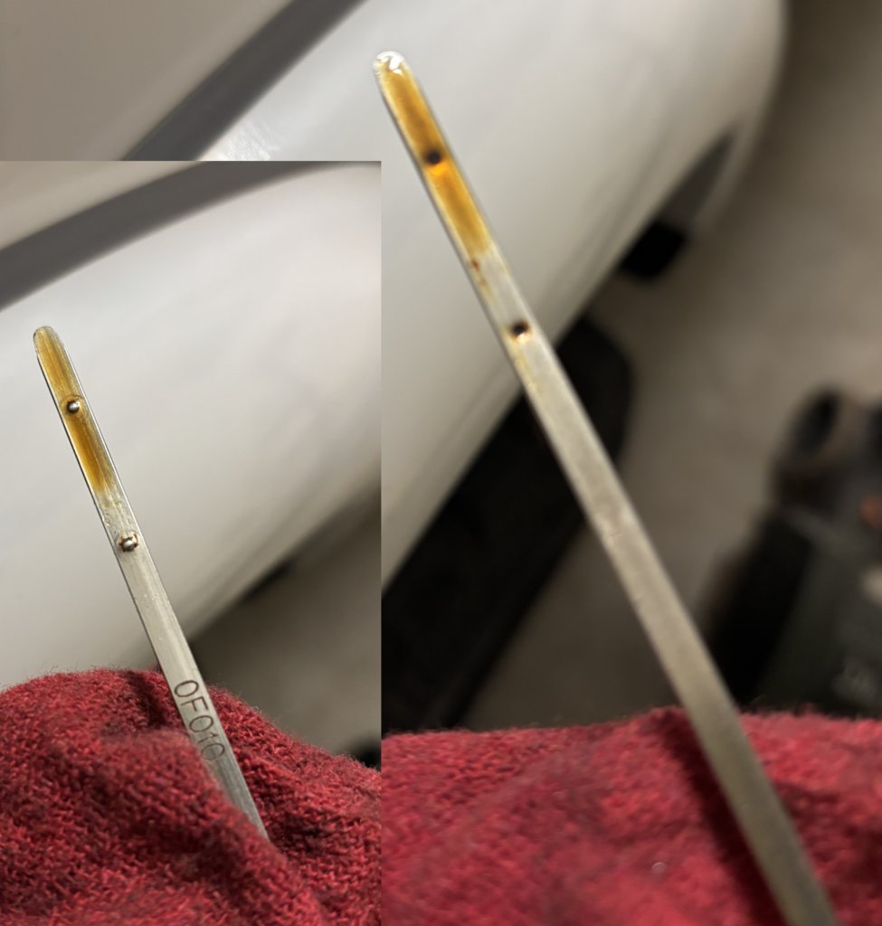

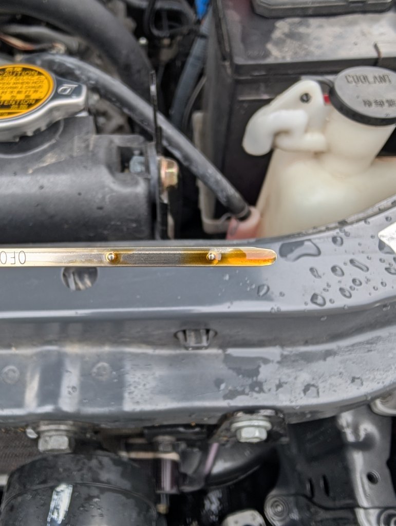

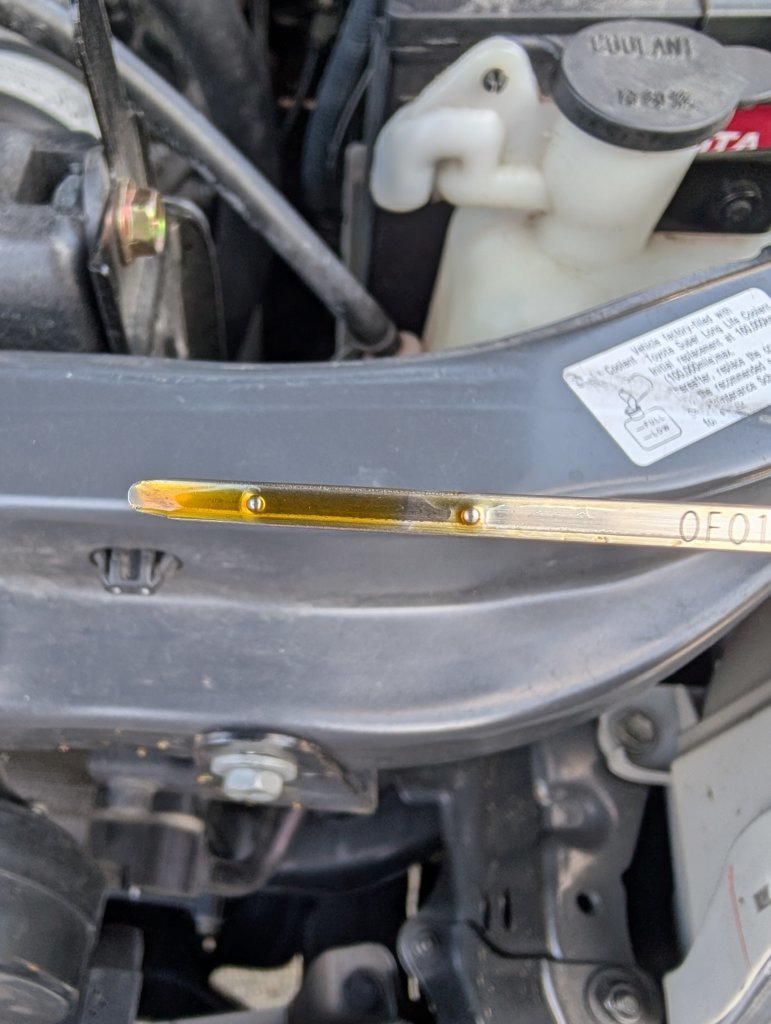

    Word, I had the cylinders scoped and leak down test done. Clean bill of health.
    To clarify, it doesn't smoke under load, it smokes upon start up AFTER it's been under load. No visible smoke when driving altho I am sure it was burning oil under those conditions.
    I'm hoping it's resolved... Will report back after more hard driving and another oil change.
