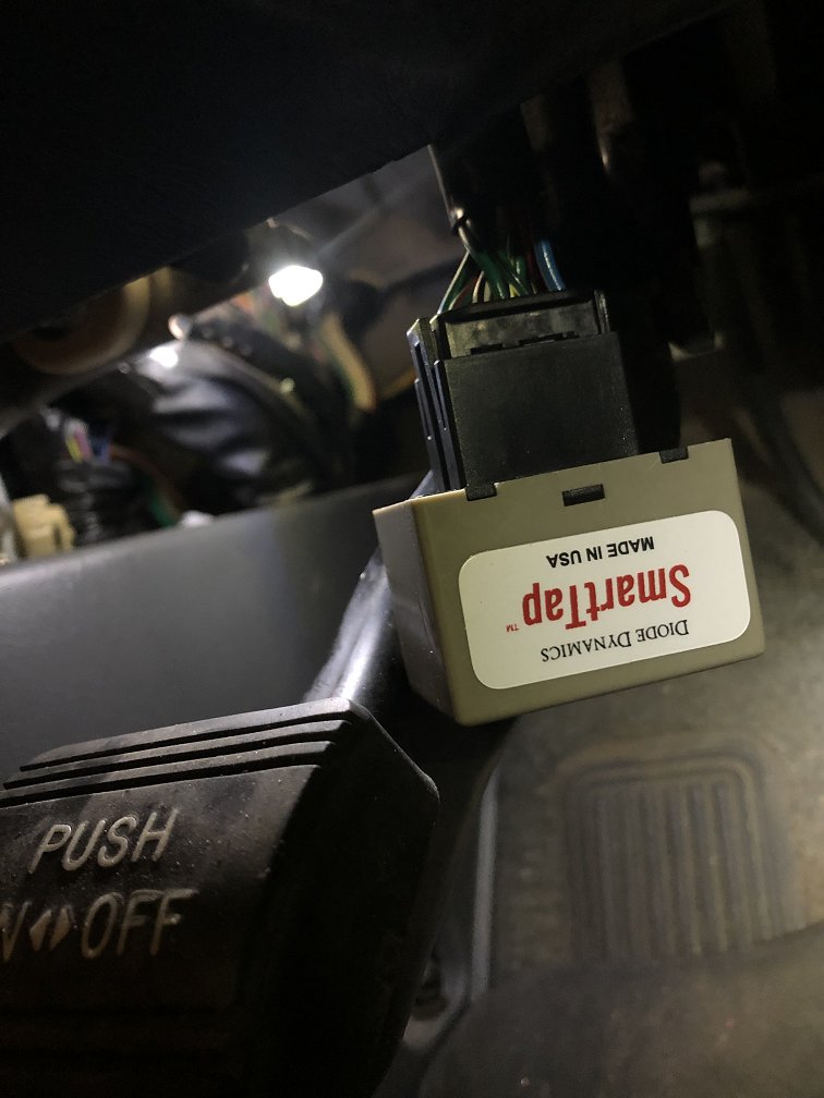

    Definitely! Finally got around to installing this morning. Hardest part is popping the old one off its post.
    I can say with confidence: My DRL are still hooked up. The only appreciable difference I can see after installing is a change in how the hazards work (quick double-strobe, pause, quick double-strobe, pause, repeat) and I finally have smart-flash (5 flashes) when tapping the stalk, as I'd expect.
    No difference in the way my DRL operate. No change in which my halogen bulbs light up in the various modes. No loss of functionality, only a gain.
    Took a picture of it attached ... I haven't dicked around with uploading videos from iOS devices onto the forum yet so I didn't bother. Maybe later if it's legitimately interesting.

    Glad it's working out @shifty` The parking lights coming on with unlock is the only functionality that doesn't work for me. Does that part work for you?

    Just confirmed: Arrival/departure lighting does not work. I swore it was working when I installed it, but in hindsight, and after attempting to extend the departure/arrival lighting times, it's definitely not suddenly appearing to work.
