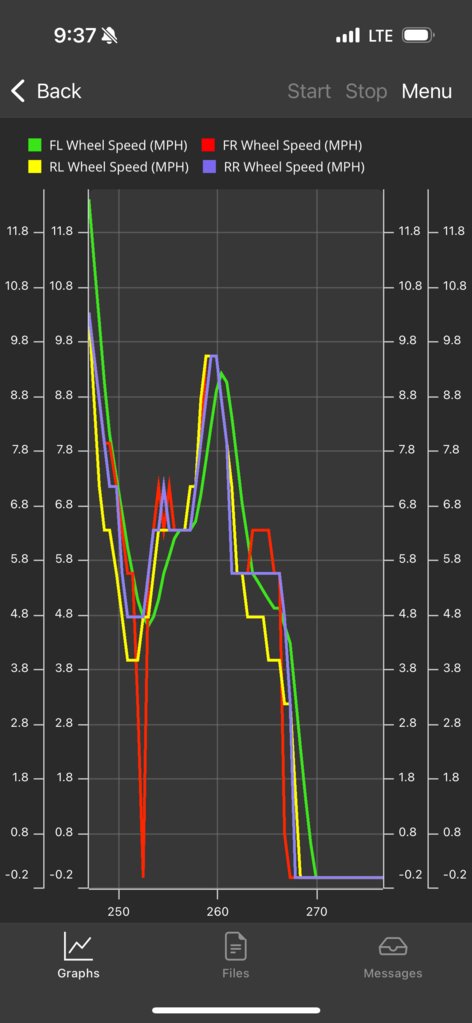

    Well, I checked for codes again, and I got “PO504- Brake switch a/b correlation.” I have been checking for ABS codes and have not gotten any. This one came up when checking the normal systems.
    I’m not sure if this could be related to the ABS issue. Anybody have insight on this?
    I also am going to try mapping wheel speeds tomorrow. I have gotten readings from all of them but I’m pretty sure one or two is reading slower than the rest.

    I haven't checked lately but I will. I had the code pop up a while ago and made sure my taillights were plugged in really well and it went away. But ya it sounds like that is not related to me ABS issue.
    I did track my wheel speed sensors this morning and they are all reporting speeds but definitely not all in sync.

    I took a quick look this evening and the brake lights and taillights all work fine. Blinkers and reverse lights too. I’ll have to look at the wiring and reverse switch more closely.
    But when monitoring the speed sensors, I saw that I have one that doesn’t seem to be activating when the other 3 are.

    Ya I’m using the mx+. It will read wheel speed and signal if/when ABS activates. I even changed the log and had it track wheel speeds which is the graph above. When it tracked the ABS activation, it looked like all but one activated at some point while driving.

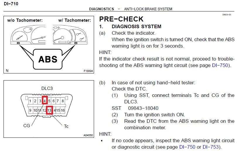

    Yeah I'm having zero fucking luck with the ZPC this go round. Did you use pins 4 and 12? When I touch them the abs light will blink but it's not giving the long beep like instructions say it will.
    Driver's side I believe is where my problems are but when I did a resistance check in the sensors the first time I fixed this they were the same.

    Just in case (because I made this mistake the first time) the OBD pin position is upside down from the picture.
    Let me look and see what side sensor harness I have. If it will work I’ll send it to you and you can see if it’s a sensor issue or if there’s another issue.
    Other option is you can get an OBD that reads ABS codes and monitor those to see which is dropping out.

    Try pin 4 and 13 instead.

    I knew i.saw that somewhere. But didn't remember finding it last time I got it to work, it was recently. Gonna try this evening.

    Not sure which one you have, but I think you can get OBD Fusion and it should connect to advanced diagnostics. Sadly you have to pay for them. You'll have to double-check if your reader will work with those.
    I have the OBD MX+ and I was able to monitor my ABS sensors to see when one was dropping out. It took some time and learning to get it figured out. Hopefully the third time is the charm and it will work for you this time.

    After doing the ZPC first with pins 4+13 there was little to no change in behavior on and activating at slow speed. Cleaning and sanding the minimal surface rust and slight corrosion off the spacer I had to have between the sensor and spindle (tuff country milled the drivers down to far depth wise) did seem to help along with the tone ring but that didn't seem dirty unless I angled the q-tip towards the inboard side. Looked like I got a little grease doing that. Activation is far less consistent than it was in same stopping points driveway etc. replaced the O-ring also but that didn't look bad.
