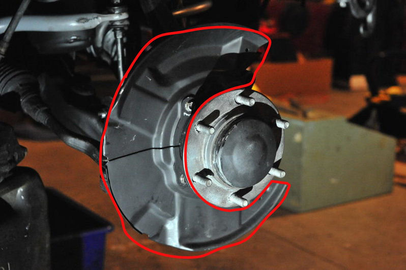

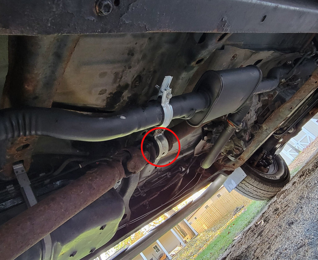

  14. Sep 14, 2025 at 5:41 AM
    #44
    BroHon
    BroHon Undisputed Shock-King
    Sep 19, 2023
    #104169
    2,933
    Bro
    Final Outpost/Bitch Mitten
    '00 SR5 AC V8 4x4
    Iron oxide weight reduction
    How many miles on your Sequoia?
    I listened to your video a bunch of times. Its certainly rotational and sounds tinny and hollow to me.
    If you absolutely cannot reproduce it sitting in park and roving through the RPMs it's logically in the driveline, Transmission back to the rear wheels, or front wheels.
    I'd start with a very close inspection of your drive shaft for rubs/bare clean metal. Take a look at the carrier bearing (drive shaft support, see pic) for failure.
    You can have someone hold the brake (set parking brake as well) and put it in drive while you watch it from the side (NOT under vehicle!)
    If uncertain about the amount movement you could post another video. Expect a small amount of driveshaft movement, but it shouldn't be a lot.
    Check for any loose heat shielding while you are under there as well.
    Carrier Bearing
    Like @KNABORES said it could be a dust shield. Has anyone done any brake work/rotate tires/Did you hit anything/run over some brush, etc...? Here is a dust shield with the rotor off.
    They are thin metal, and ride pretty close to the rotor and a small bend can make them rub and produce a very similar sound.
    Just a few FREE things you can do to possibly find your grind.

  15. Sep 14, 2025 at 10:15 AM
    #45
    ToyotaDude
    ToyotaDude Member
    Jul 8, 2023
    #99955
    1,039
    2003 Tundra AC V8 4x4
    It did sound a bit like a dust shield. And agree ot sounds like there are mutiple issues. You did mention a code.
