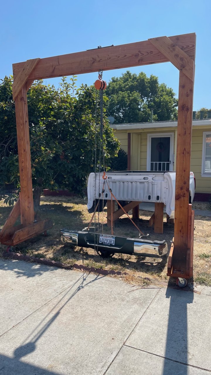

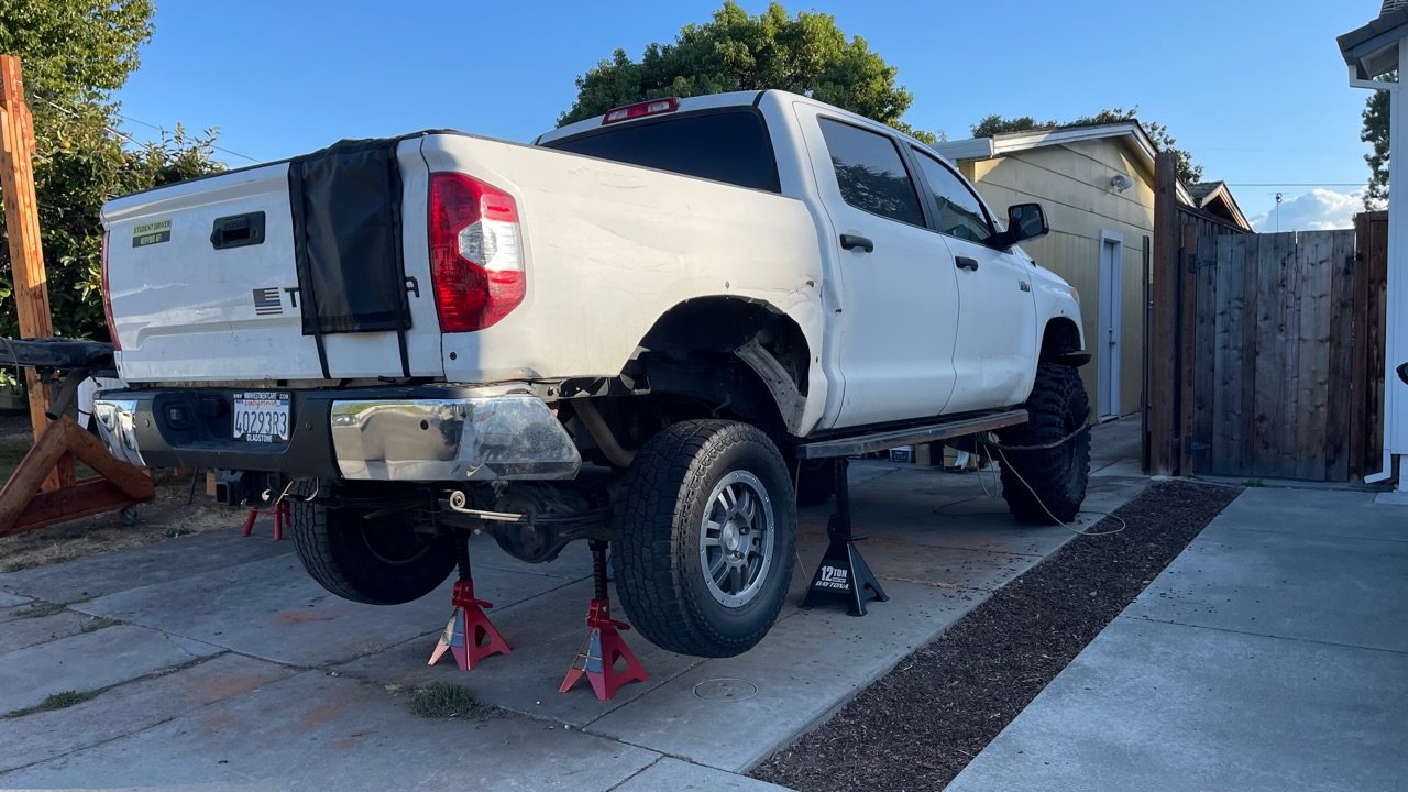

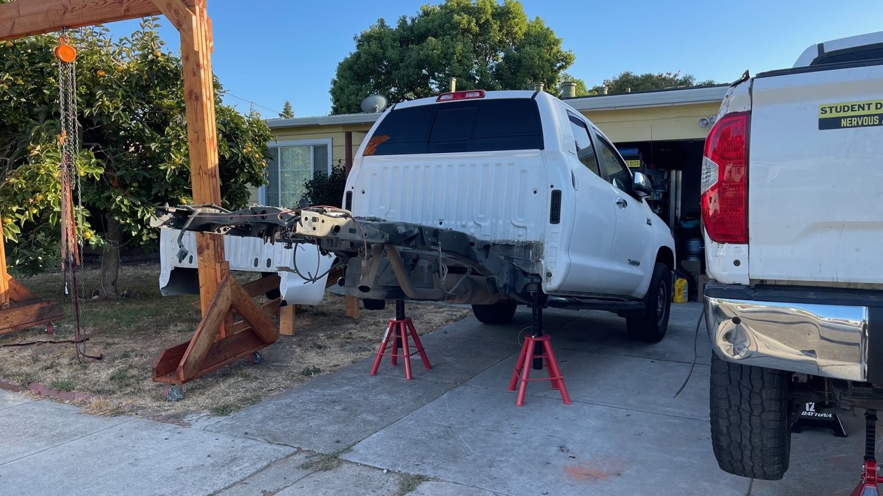

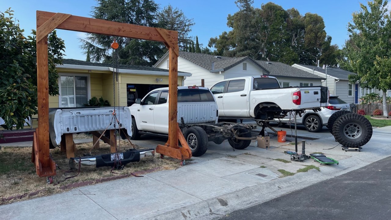

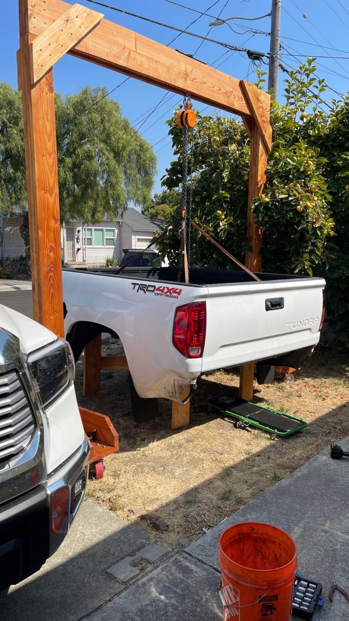

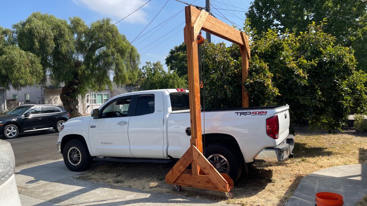

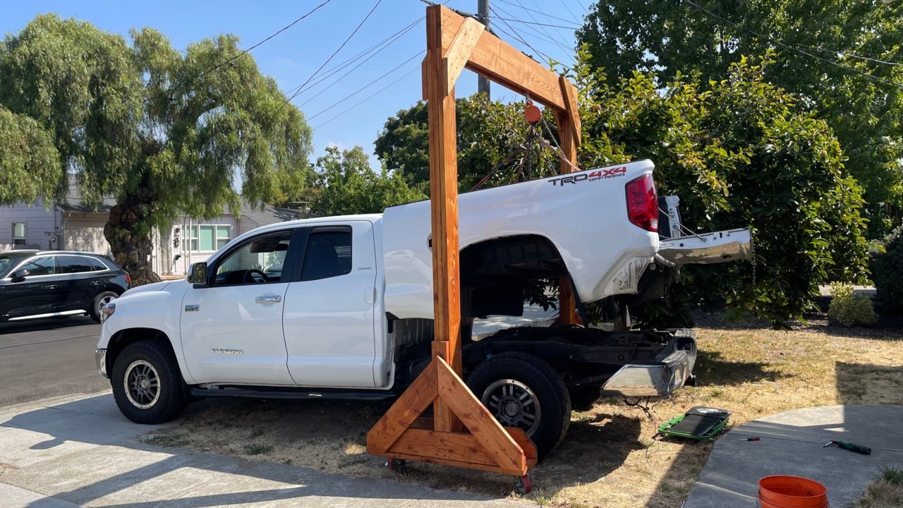

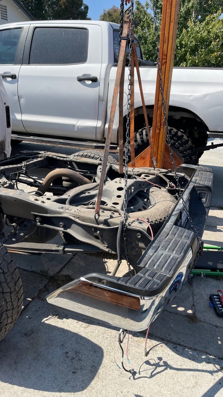

    I built the gantry and it's been quite helpful already with lifting and carrying heavy items.
    I removed the DC Bed along with the DC tow hitch with the bumper still attached. I removed the CM high clearance rear bumper with ease as well.

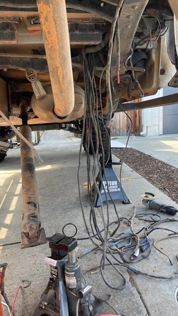

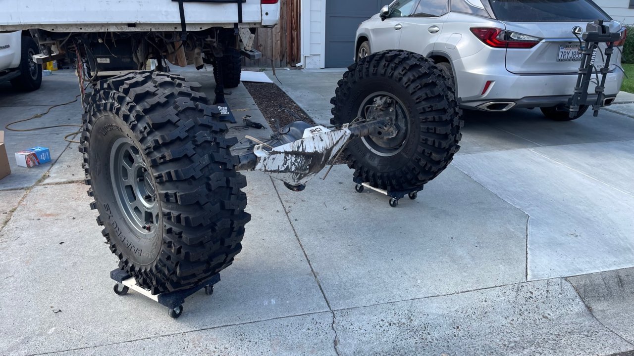

    Decided to chop off the e-brake cables rather than take the wheels off to take it apart and put the wheels back on.
    :ballchain: not too happy right now
    Cleaning out the shit load of wiring under the truck is taking longer than expected.

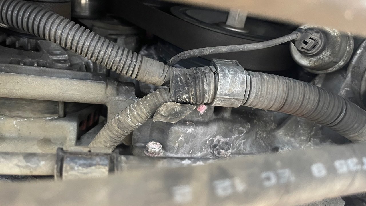

    Been seeing lots of post lately about replacing water pumps and have been wondering if I should.
    Took the the skid plate off and looked up.
    Yeah I should.
    Might as well do all of it: radiator, hoses, starter, belt, rack bushings, and add a power steering cooler.

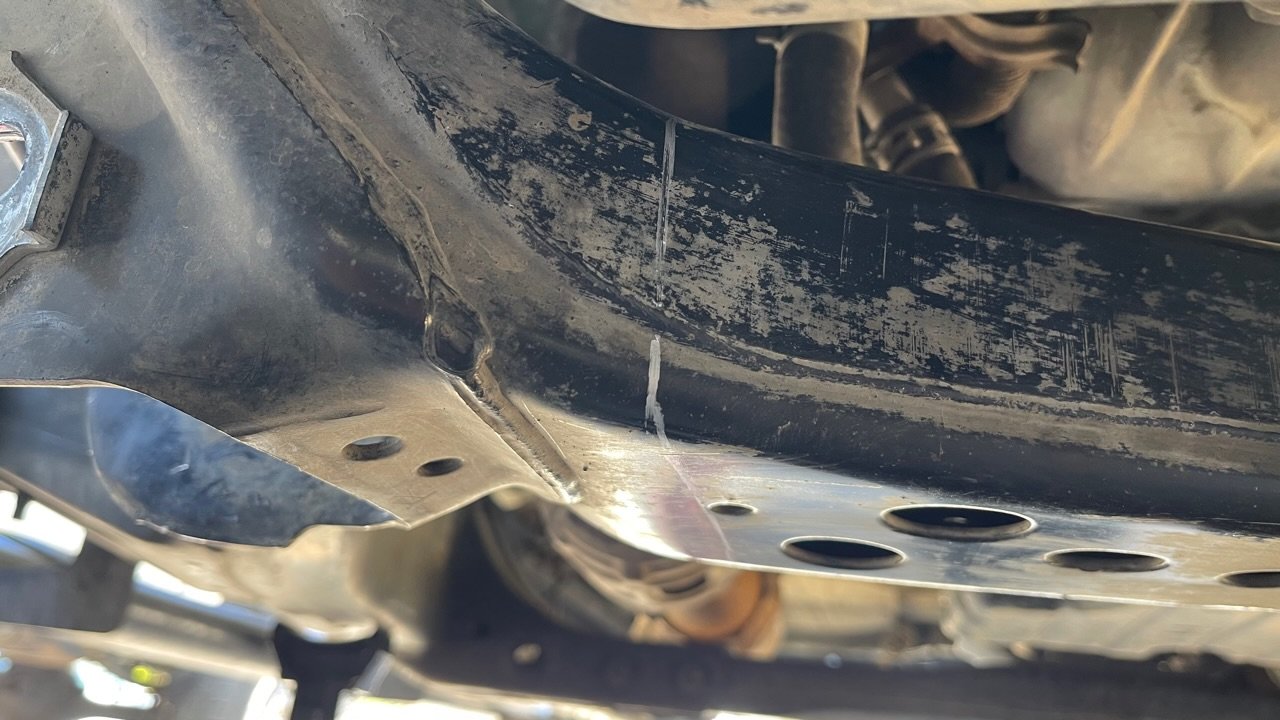

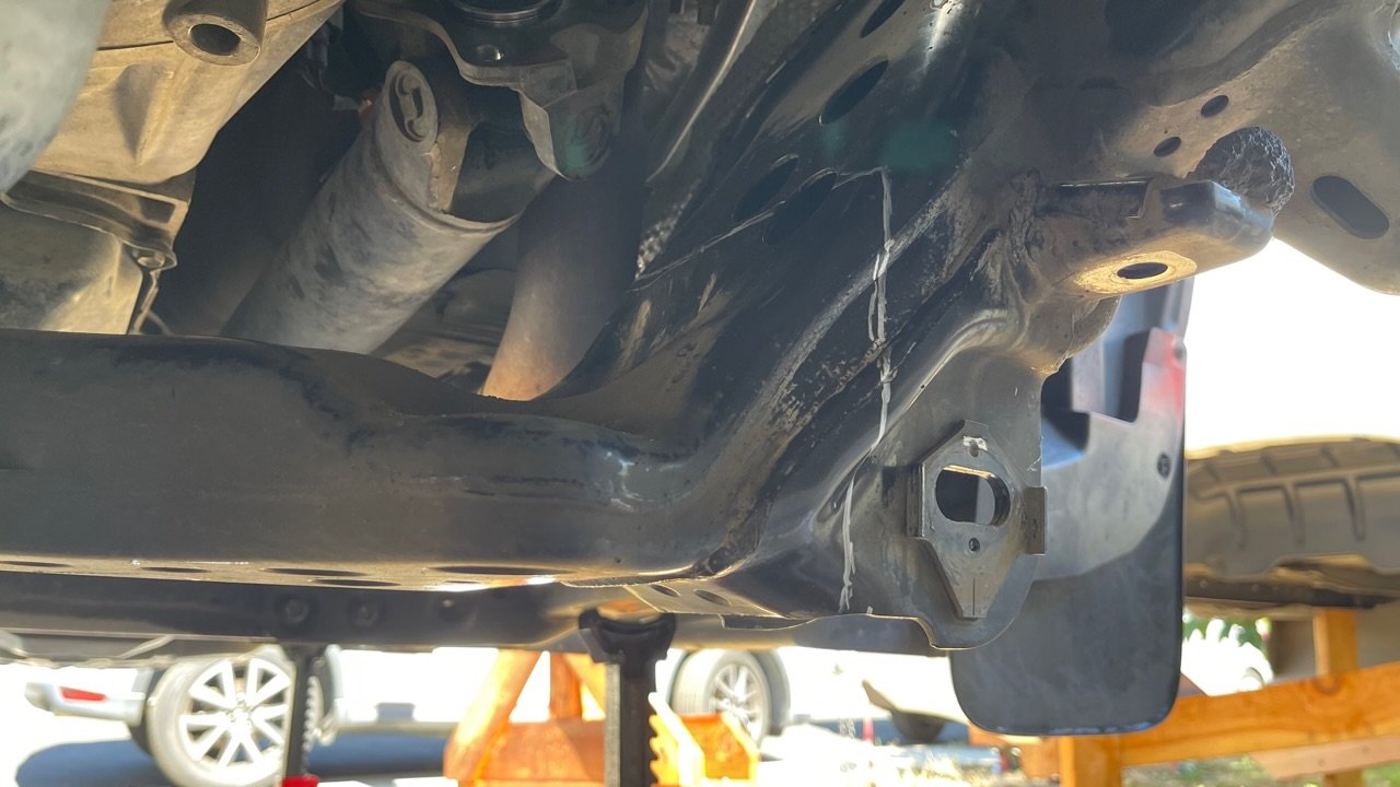

    Legit worried and nervous right now.
    About to :sawzall: the DC crossmember, so that I can install the BDS drop bracket lift, then transplant the crossmember to the CM :welder: This is truly the point of no return.

  20. Oct 8, 2023 at 5:12 PM
    #50

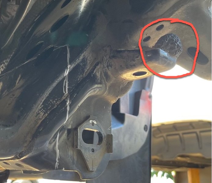

    WTF is that?!

    That’s foam. Spray foam from the factory. That is where the rear mount of the front diff bolts into. Guessing it’s to keep dirt from piling up in the mount.

    That robot was getting busy with the foam gun!

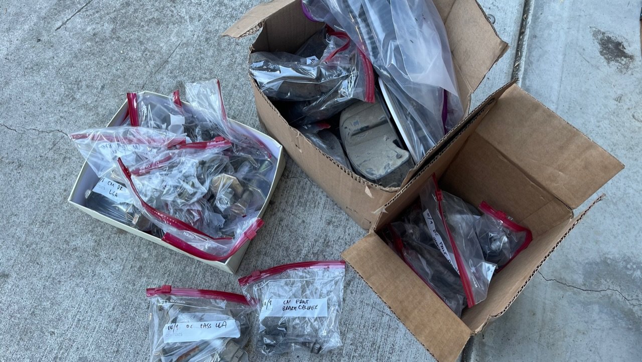

    With all the parts coming off both trucks I knew I needed a strategy to keep track of the nuts and bolts. So I’ve been bagging and tagging and now have 3 boxes worth of stuff :eek2:
    Unfortunately, I didn’t come up with a strategy for the backyard :p

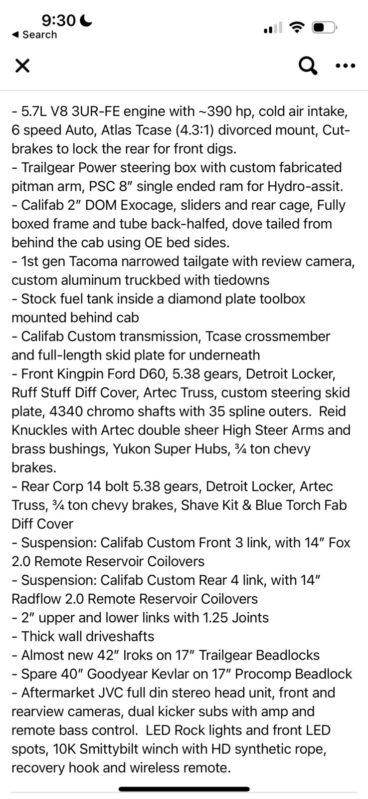

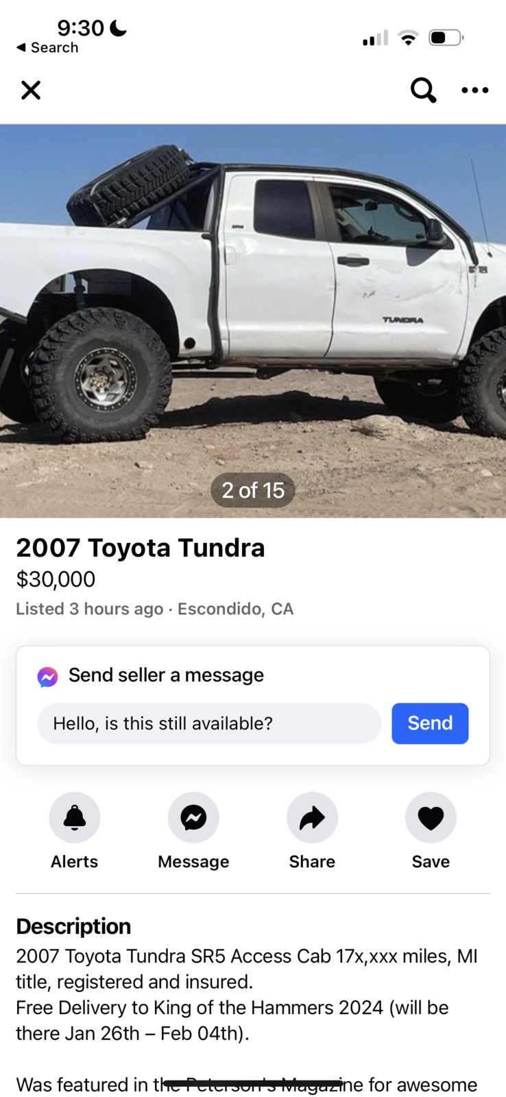

    This just popped up. Curious to get your thoughts.. Similar with the Atlas but I like your idea of the tummy tuck a bit better

    That thing is a beast! That full SAS can easily handle those 42s. I looked into getting a divorced Atlas but determined it was going to be too far down and would butt up against the fuel tank. Toolbox fuel tank, now that’s something you don’t see everyday :rofl:
