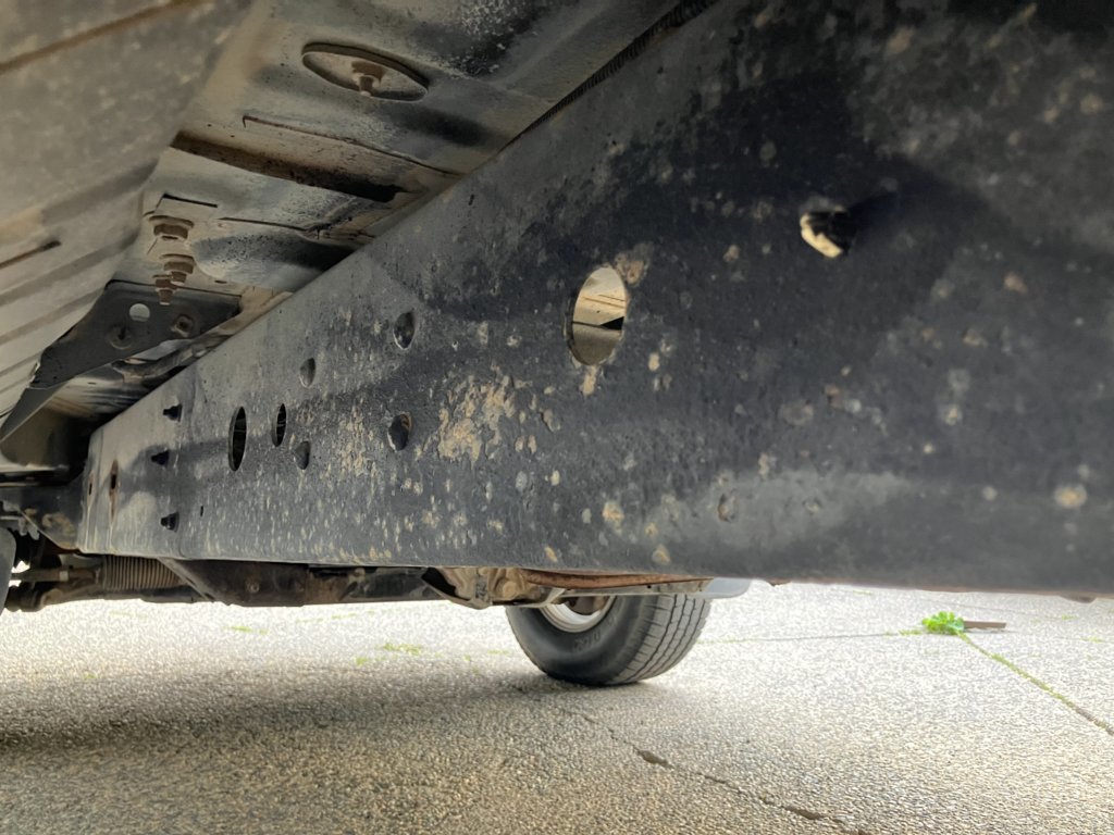

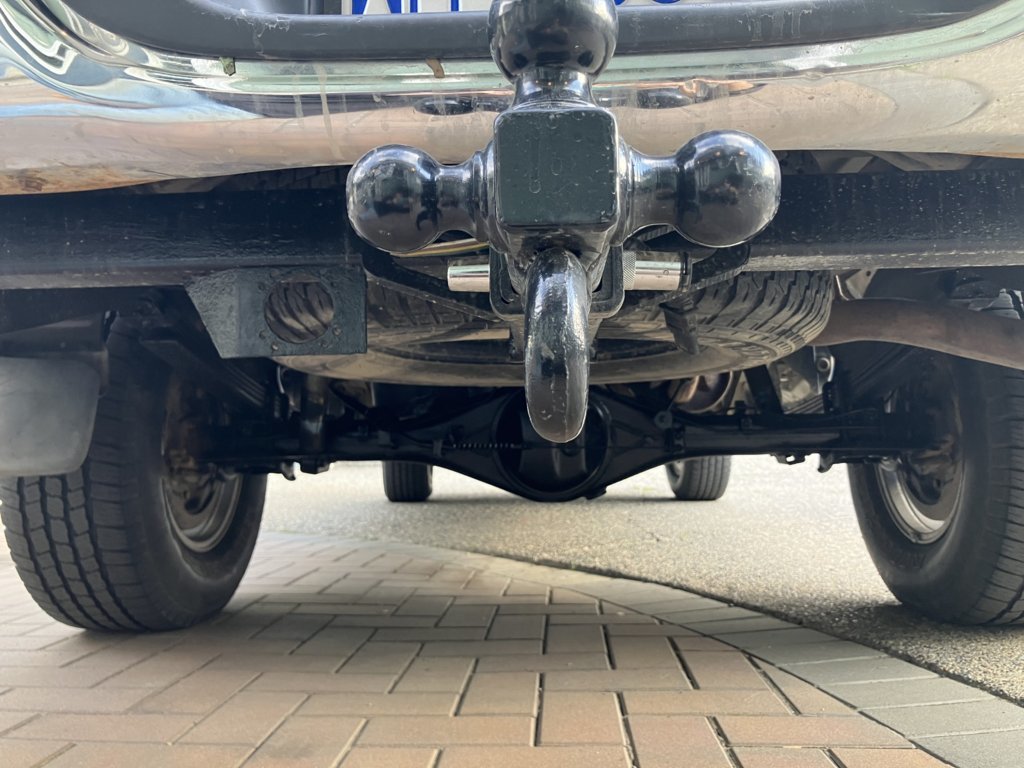

    Thankfully my grandpa took superb care of this truck. He got the recall undercoating and I recently wire wheeled and coated the hitch, diffs, and axels. The frame is near perfect condition. But definetly appreciate the concern. And ok ill keep chipping away at that thread. Thank you!

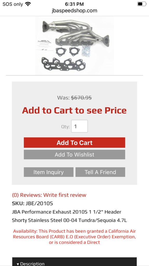

    Sorry, im still very ignorant. But, It does say shorty at the bottom on this:

    You're not ignorant. I'm just older and forgetful. It's the long tube they disco'd. Short tube is clearly still available. You're really not going to gain a ton from the JBA's. You really gotta decide if it's worth it to you, I guess. If it was me, I'd put that money towards the other critical stuff.
