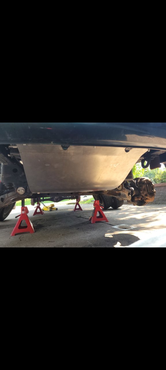

    What thickness aluminum did you end up using? Looks like 1/8” or less

    080. Same thickness as most street signs.

    Ah ok, I saw you post that but I thought that was a grade or something

    It's about 1/8 inch maybe a hair less

    Maiden voyage yesterday afternoon at interstate speeds... haven't totally figured out a way to tell for sure but I think I heard a flutter sound. I wish I had a go.pro and some fancy attachments to video down there but...I fear that the skid may be a touch too thin of aluminum? Kind of think it may be flexing with wind or the wings/ bend side flaps aren't quite sturdy enough.
    Not it's either take it off and build some sort of stiffeners to mount or recreate it front steel.
    This has taken a turn to more work than I wanted it to be for just keeping the winter shit off the front end components and engine bay a little cleaner..

    My original thought when you said aluminum and street sign thickness is that it'll be a bit flimsy. I really like the work so far though.

    Yeah, took a chance as it was free. Nothing but time and a case of beer so I take it as a learning experience. Now at least I have a template I know works. Gotta just be the side flaps as they aren't attached to anything like the rest. Aw well. Another will be in the works at some point if stiffeners don't work out!

    Add some angle aluminum to the left and right sides as a rail to stiffen it up (on the inside). You can probably rivet them on.

    you could always get a dimple die press. that would do a lot for your fluttering.

    You mean punch more holes in it? I have a hydraulic knock out set.
    If I cut more holes in it and bigger ones it'll defeat the purpose of the splash guard I think.
    I think it's just the aluminum being to thin on the wings/side flaps. Are you suggesting to punch holes in those to see if it helps?

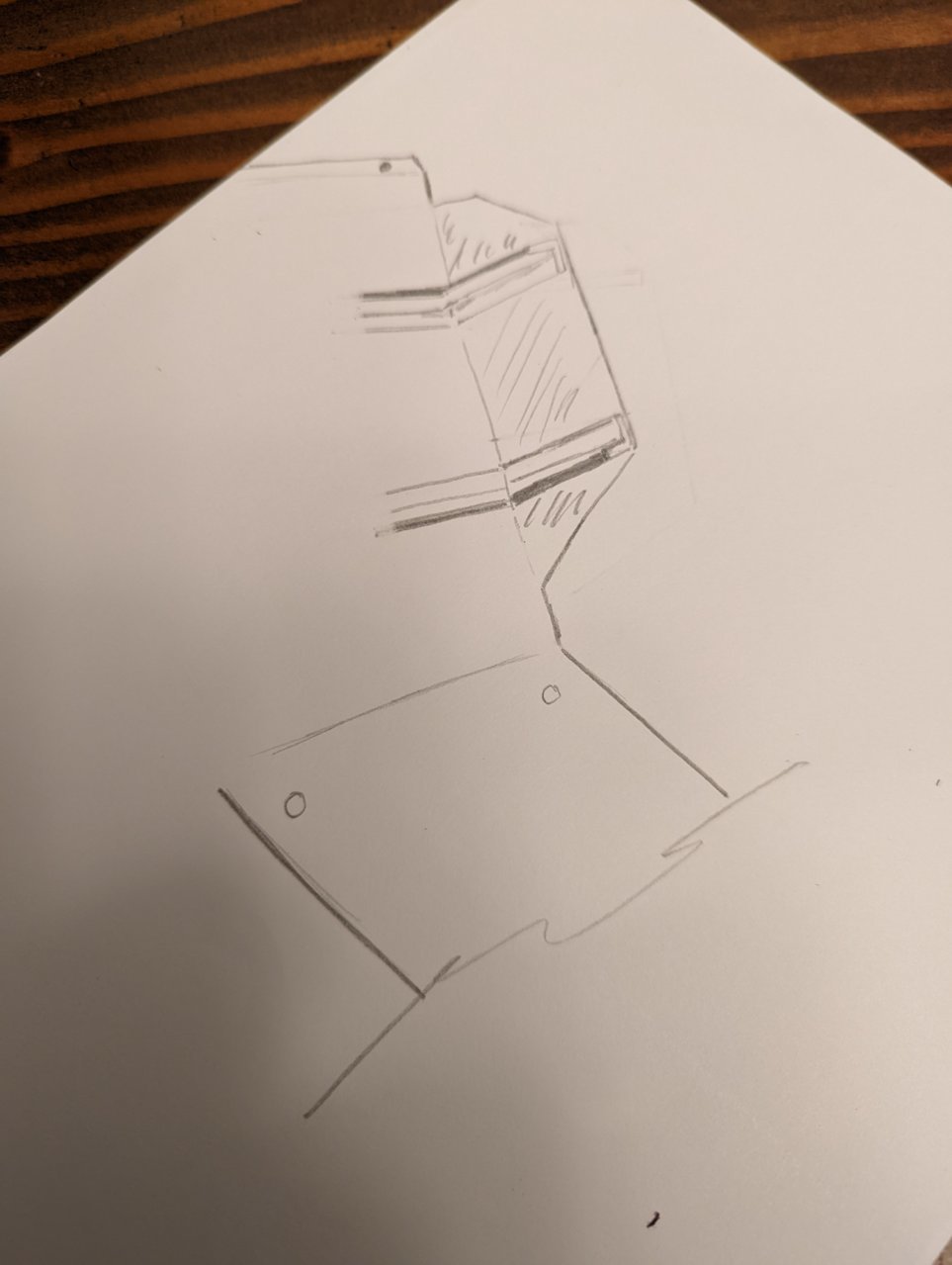

    trying to picture how it would bend and I'd still be able to attach it? I assume where the bends where would need to have a notch cut out to allow the bends. I found some at the 'Po. different thicknesses they have...1/16" probably too weak?

    I don't know what's happening in this thread anymore. Worried about wings being too weak? I'd just add some angle aluminum to the wings or some other sort of brace.

    Flared dimple die holes can improve rigidity of a sheet of metal, but I suppose if the "splash" aspect is important to you, then it definitely does defeat the purpose.
