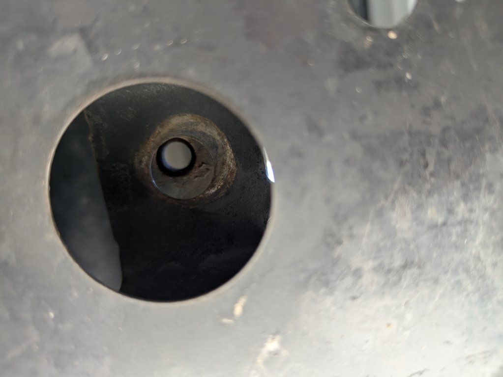

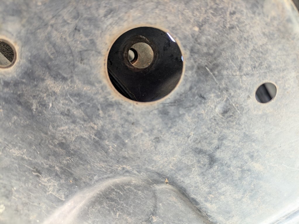

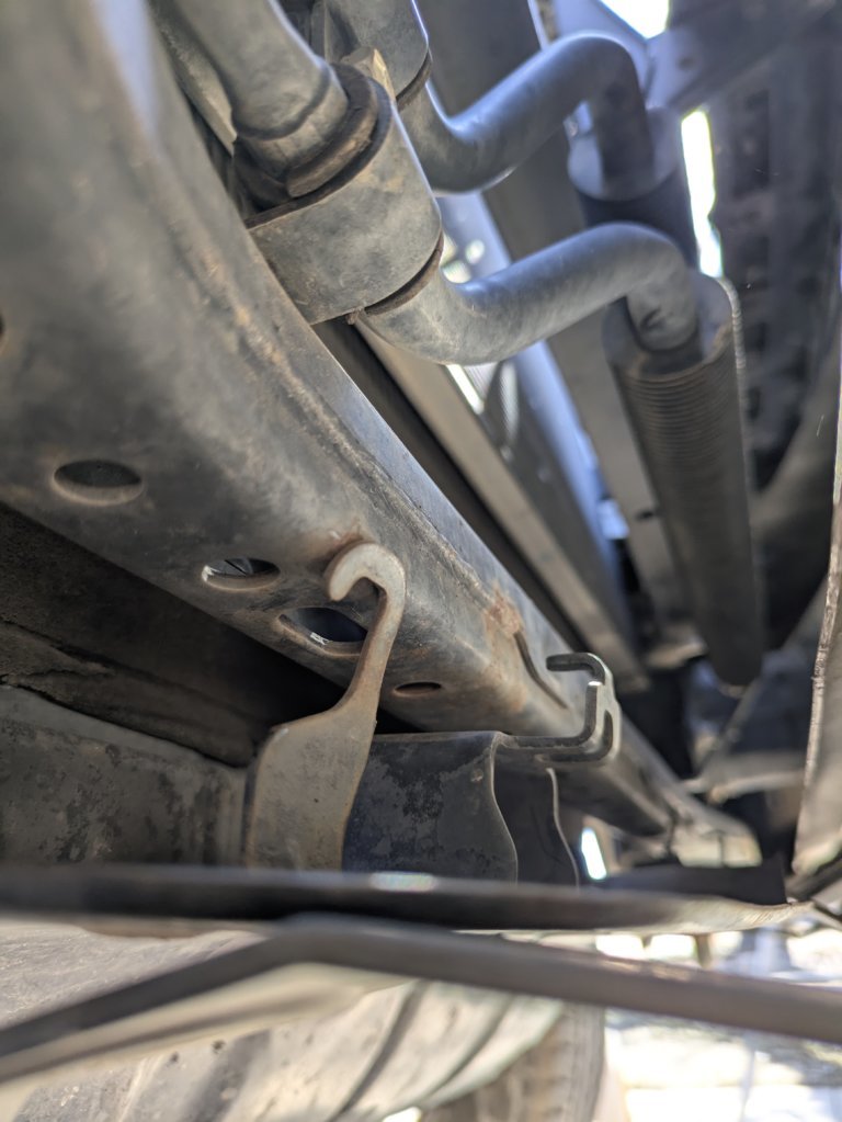

    Anyone here ever have their 5mm Allen key bolt under the lifting point of the skid plate absolutely refuse to come out? I have every bolt out except that one and I’m absolutely stumped. Any input?

    Assuming you’re talking about the TRD skid? (Edit: just saw you have a Pro in your profile) If you removed all the other bolts, there may be too much tension on that taper head to get it loose. Maybe try putting a jack on the rear of the plate and getting as much tension off the bolt head as possible. Just be careful not to strip out the head.

    Yeah I took a break to come inside and check forums. I’ve got jack stands under it currently but I’m gonna swap em out for the jack itself and use your advice. Slow and deliberate has been the game to avoid stripping that bolt
