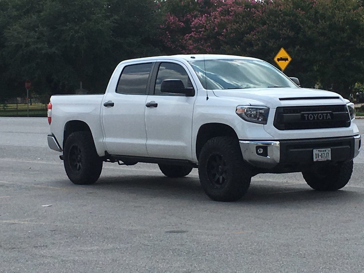

    Toytec/Eibach 3/1 lift kit 295/70/18 TOYO AT 18 Inch Method NVs
    I’m my opinion 3/1 is perfectly level. So I think 2.5 will leave you slightly nose high. Here’s a pick of my truck on a 3/1 and it’s pretty level. I actually measured the other day and the back is .5 inches lower. 7499934B-B283-4C70-BCA4-0487828565E3.jpg

    Can you post a few pics?

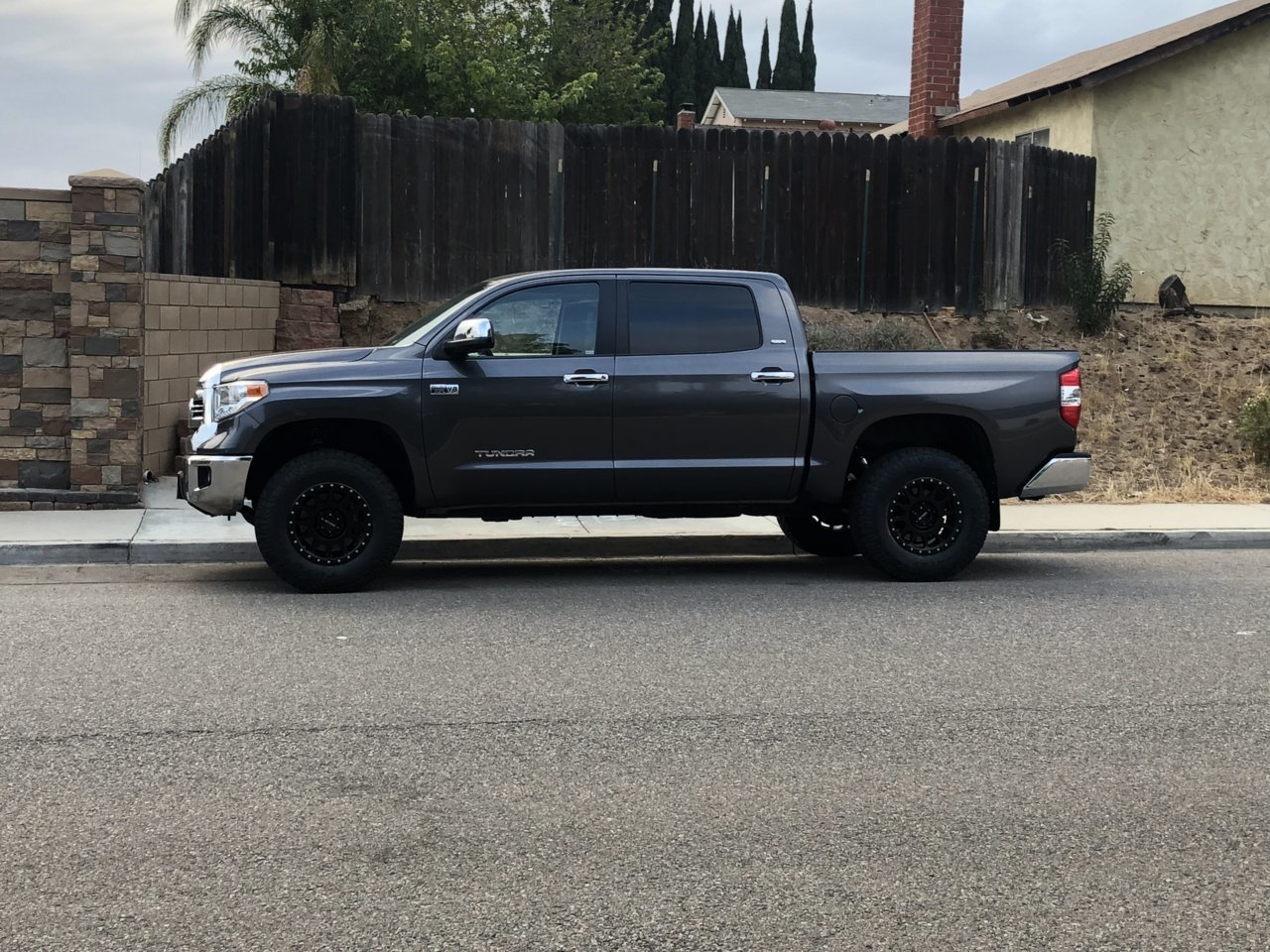

    I did 2.5", toytec shackles, airbags w/daystar cradles. My vote is 2.5 20180707_165313.jpg 20180705_111029.jpg

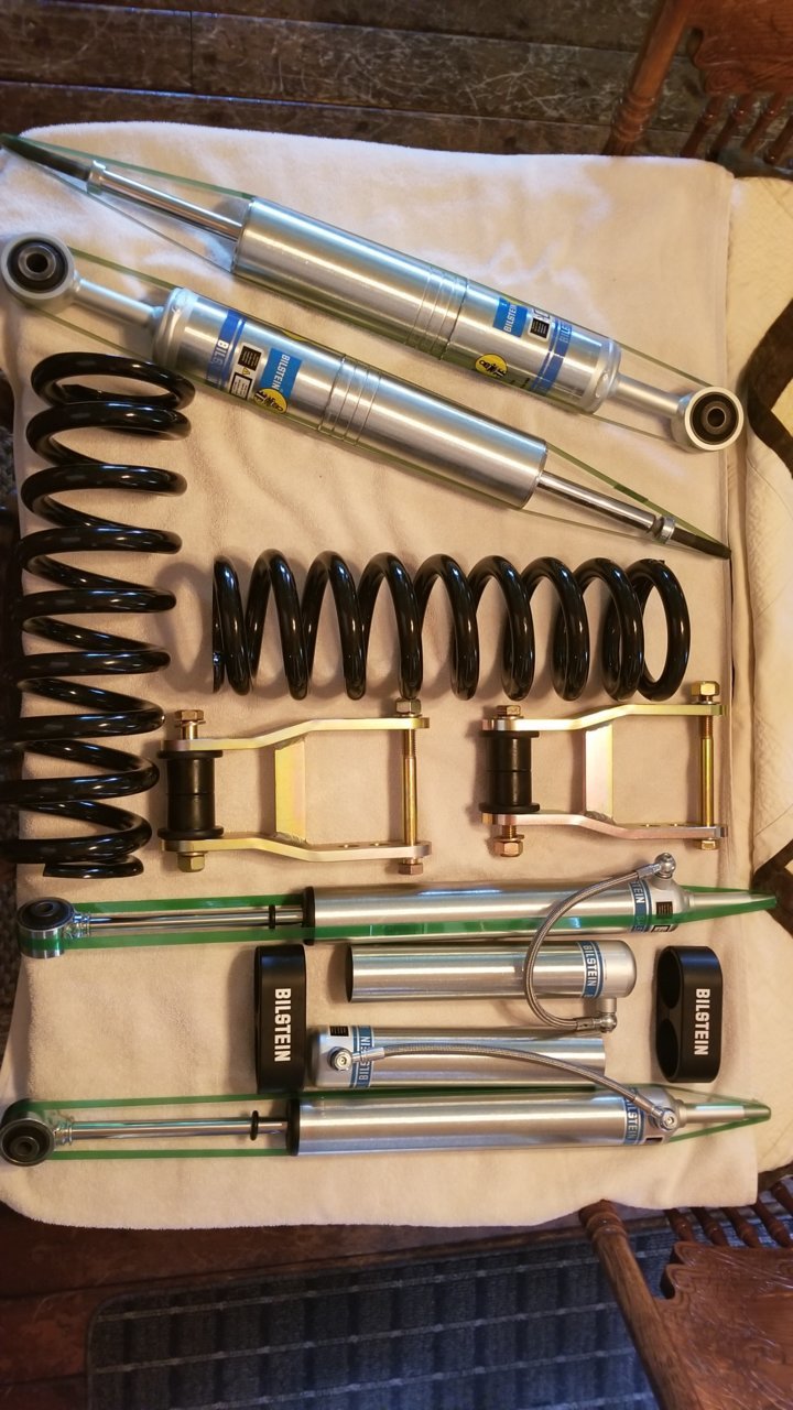

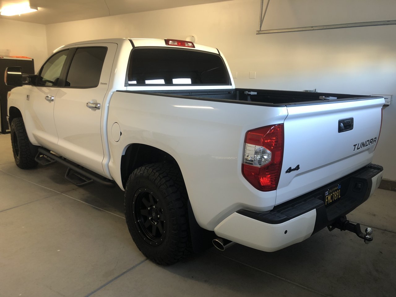

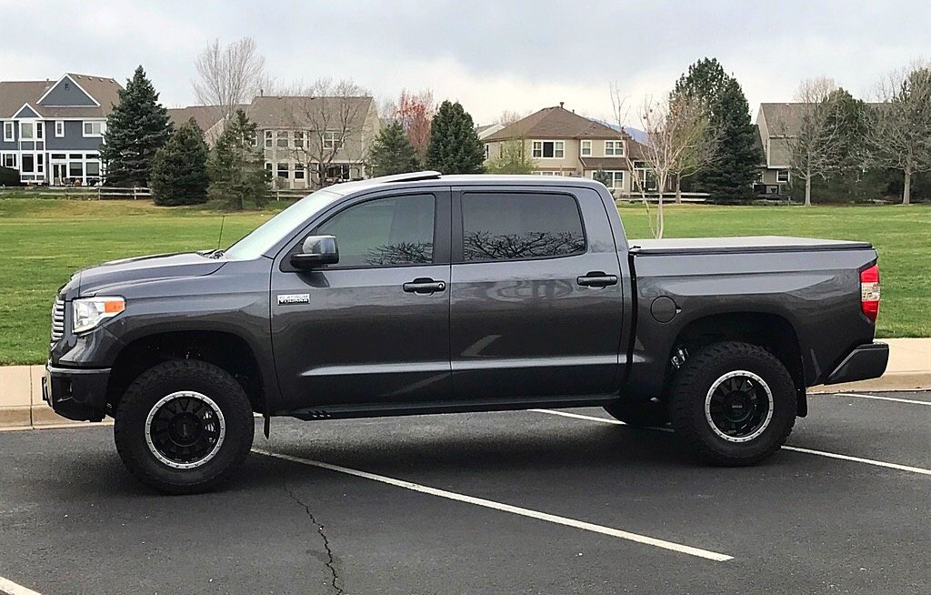

    I don’t have too many to compare but the first picture is at 1.9 and the last two are at 2.5
    I’ve heard some trucks will be at different heights at the same setting. Mine measured exactly 24.5 inches hub to wheel well at front and rear at 2.5

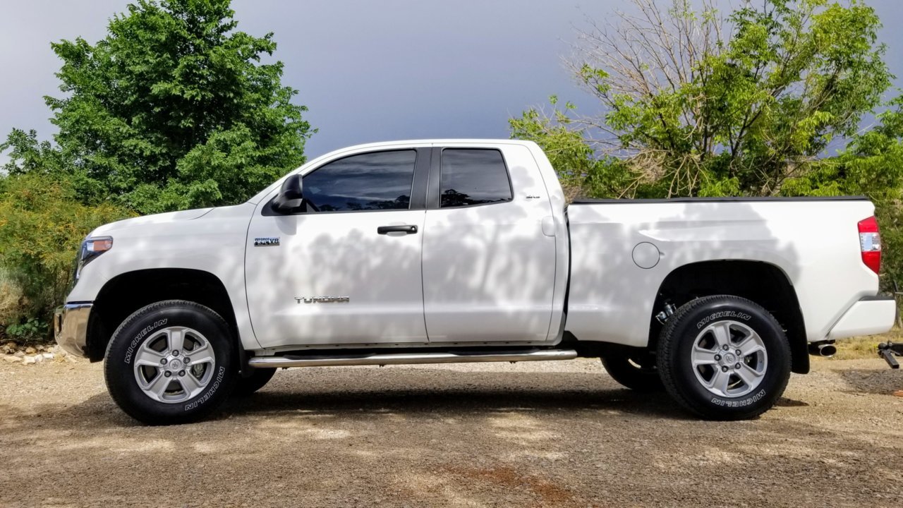

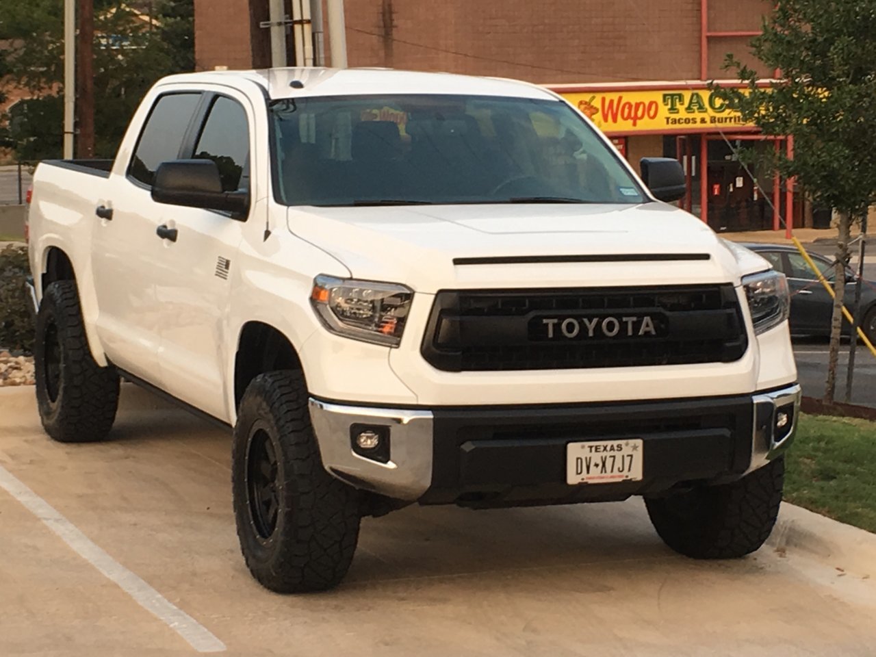

    This was my 16 with 6112 at 2.5”, and 1.5” rear lift.
