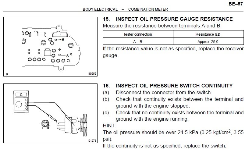

    Unfortunately not much to check with the sensor given it either has continuity or it doesn't.
    I have one of the supposedly super duper new sensors you can have. Only has about 1 hr of use.
    With it installed, my gauge showed @ 2K rpm the line just below very top line and at idle it showed almost halfway.
    I went back to original which showed 1/2 way @ 2K rpm and 1/4 @ idle, which I like.
    Be glad to send the new one to ya since it'll never be on my 04 again.

    Thanks, but I think I’d like mine to be how it was originally or is that not possible with the updated sensor?

    As far as I know it is what it is. It’s only one conductor and what ever resistance reading the sensor is putting out with engine running is sent to combination meter….no adjustment on our end.
