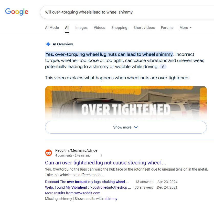

    With the way I've watched some impact jockeys at the tire and chain auto repair stores wield their impact guns, and give zero shits about prepping hub surfaces when there's leftover gasket material or excess rust, I reckon it could happen in as little as one visit.

    You mean I shouldn't ride my brakes down the side of a mountain, then hit that 18" deep river crossing when I get to the bottom? :rofl:

    I get it, you love to follow me around the forum and find things I say, question them, twist the responses in ways that suit your narrative. This isn't the first time, or the second, or the fifth. It's fun, we both enjoy it, it makes my day brighter. Right?
    What Faye describes and what others have described aren't exhaustive, as most things aren't. Look dude, just Google it. I'm not saying the internet is perfect or anything, but overtorquing your wheels is dangerous, will absolutely cause wheel shimmy, this is something I've known for the 40+ years I've been wrenching on vehicles. It's one of the first things Dad taught me at the ripe age of 8 or 9 years old.
    EDIT: The tl;dr is, overtorquing can warp the wheel face, distort the wheel properties and even the hub, stretch lug nuts so they don't grab properly, and I'm sure there's a myriad of other things that overtorquing your lug nuts will do, which will result in warpage and wheel shimmy. And sometimes, just backing down to the correct torque will make those symptoms diminish or disappear.
    Zach_795[OP] and joseph_womack like this.

    But hey, there are plenty of other professional sources out there, so don't just stick with Google.
    https://www.mightyautoparts.com/wp-...-0179-troubleshooting-noise-and-vibration.pdf
    "GM Promotes Wheel Torque to Correct Vibrations: Lug nut torque is the usual description that we apply to wheel torque. We found a recent GM bulletin concerning lug nut torque to be very interesting, as most associate uneven lug nut torque with rotor warpage and pedal pulsation while braking. The symptoms can involve much more. Improper lug nut torque procedures can result in the wheel and tire assembly being off-set during mounting. The off-set causes the mass of the tire and wheel assembly to orbit the axis of the hub, creating a vibration similar to a tire not properly balanced or one with excessive RFV. The improper torque can cause a distortion of the brake rotor, resulting in a variance in wheel mounting that can cause a condition referred to as smooth road shake vibration."
    I won't spend any longer on it, but it's a thing, there are multiple ways it can cause vibration. It's a simple thing to rule out, as is gauging runout to see if the rotor is, in fact, warped.
