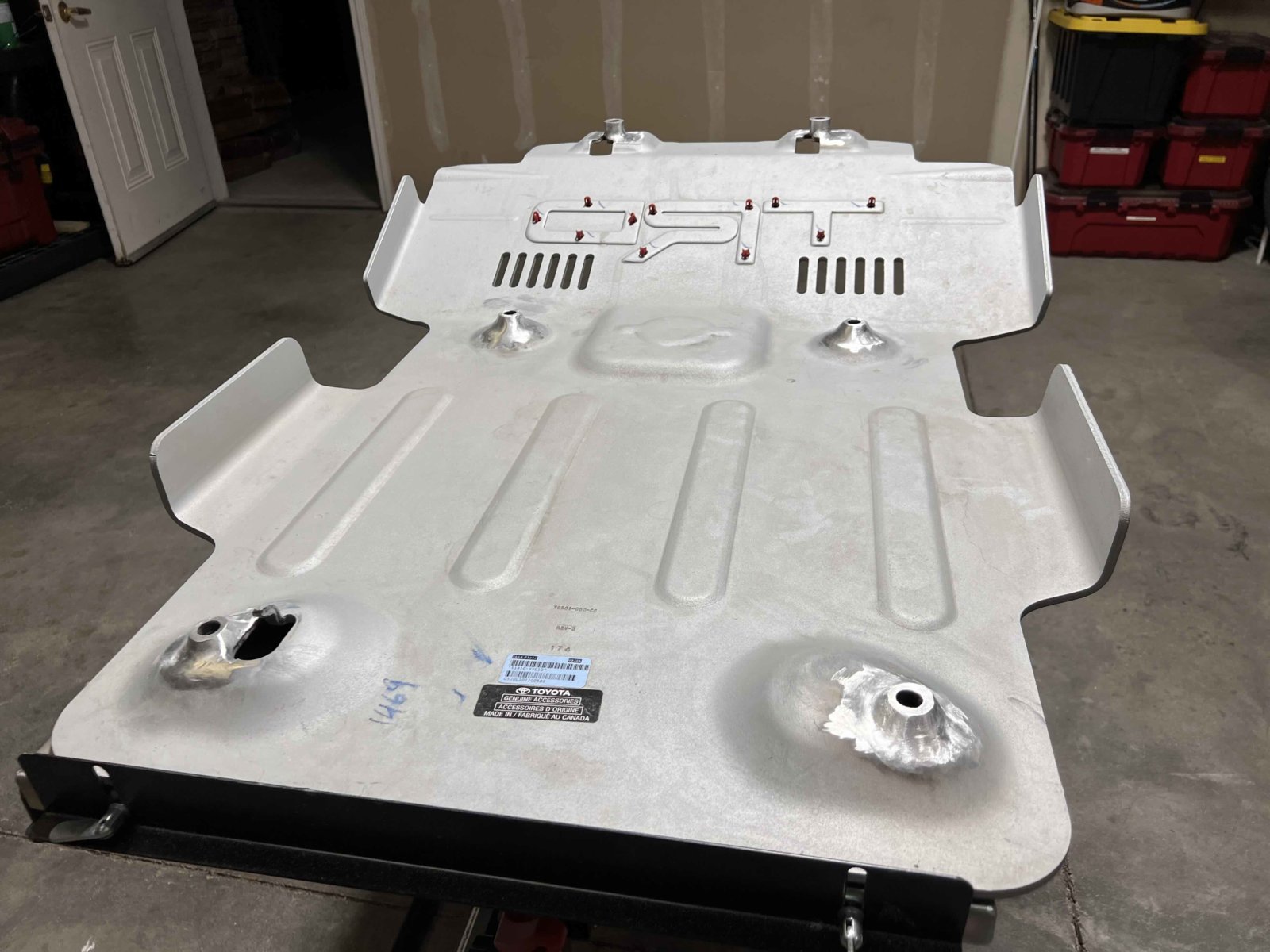

    Not the greatest picture, but you get the idea. No issues welding them to the plate. The spacers are quite thick, and so is the skid. Need a decent amount of heat. I wasn't concerned about esthetics related to the powder coat and decided to run a thick, full bead around the spacers to help prevent sheer under a hard hit. In reality you could probably get away with just a few tacks. Just beware, If you put too much heat into the skid you'll end up with de-lamination of the powder coat on the bottom side where the bolts go thru.

    Looks excellent, nice work.

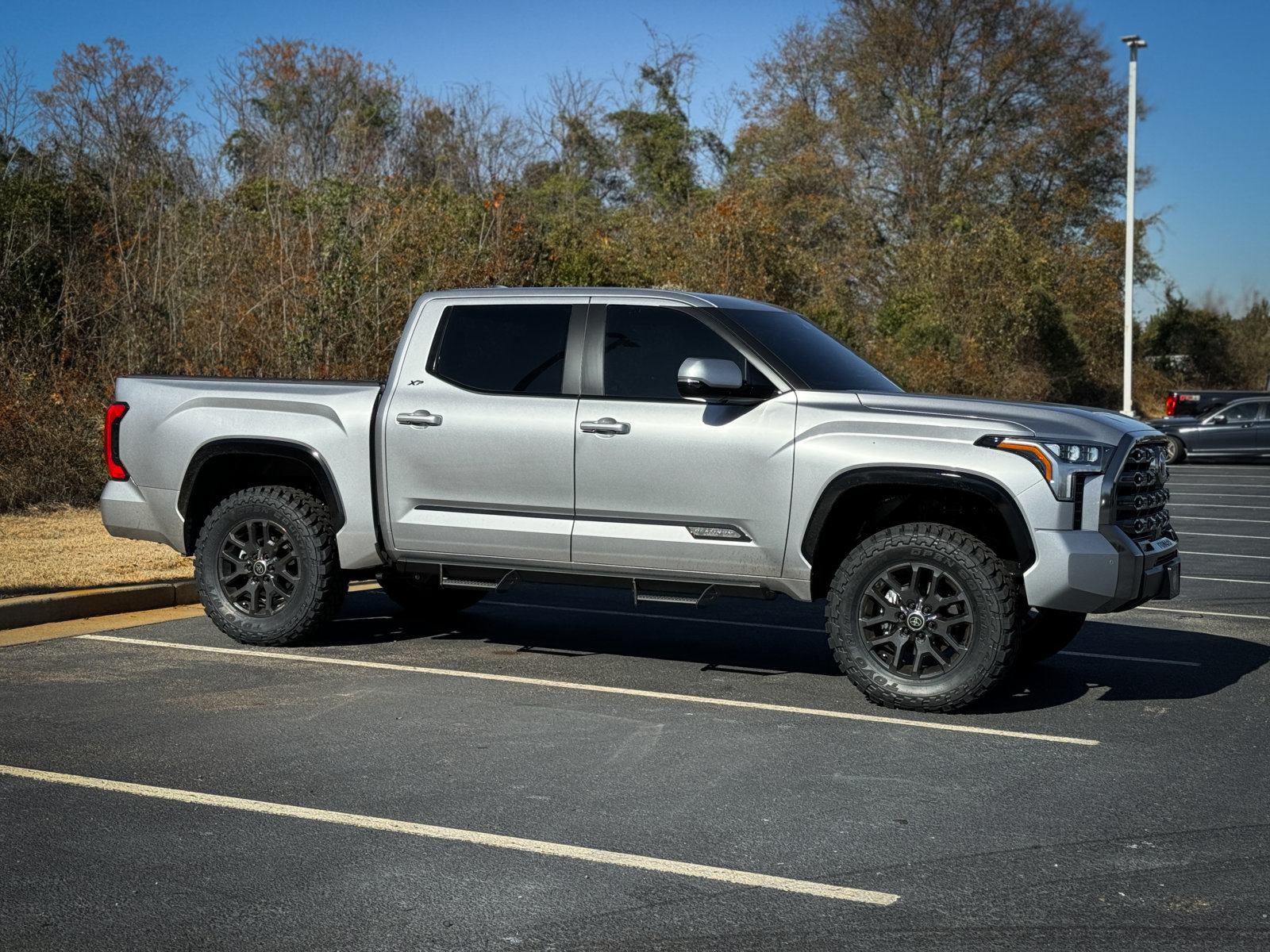

    Ready Lift SST with 295-65-20 Toyo MT

    If you want a Ready Lift SST lift to look like it is supposed to, You have to install the kit without the rear spacers and buy the ICON 3" spacers for the rear. The Ready Lift rear spacers are too short and seem to let the back sit lower than the front. Ready Lift has no options as far as spacers (I called them first). Just a heads up. Other trucks may be different, just wanted to let you know what I did.
    35-12.50-20 WOULD NOT fit on my truck. Had to use the 295-65-20s and no scrubbing anywhere.

    Damn that looks fantastic. What was the problem with the 12.5 wide? rubbing on the wheel well liner?

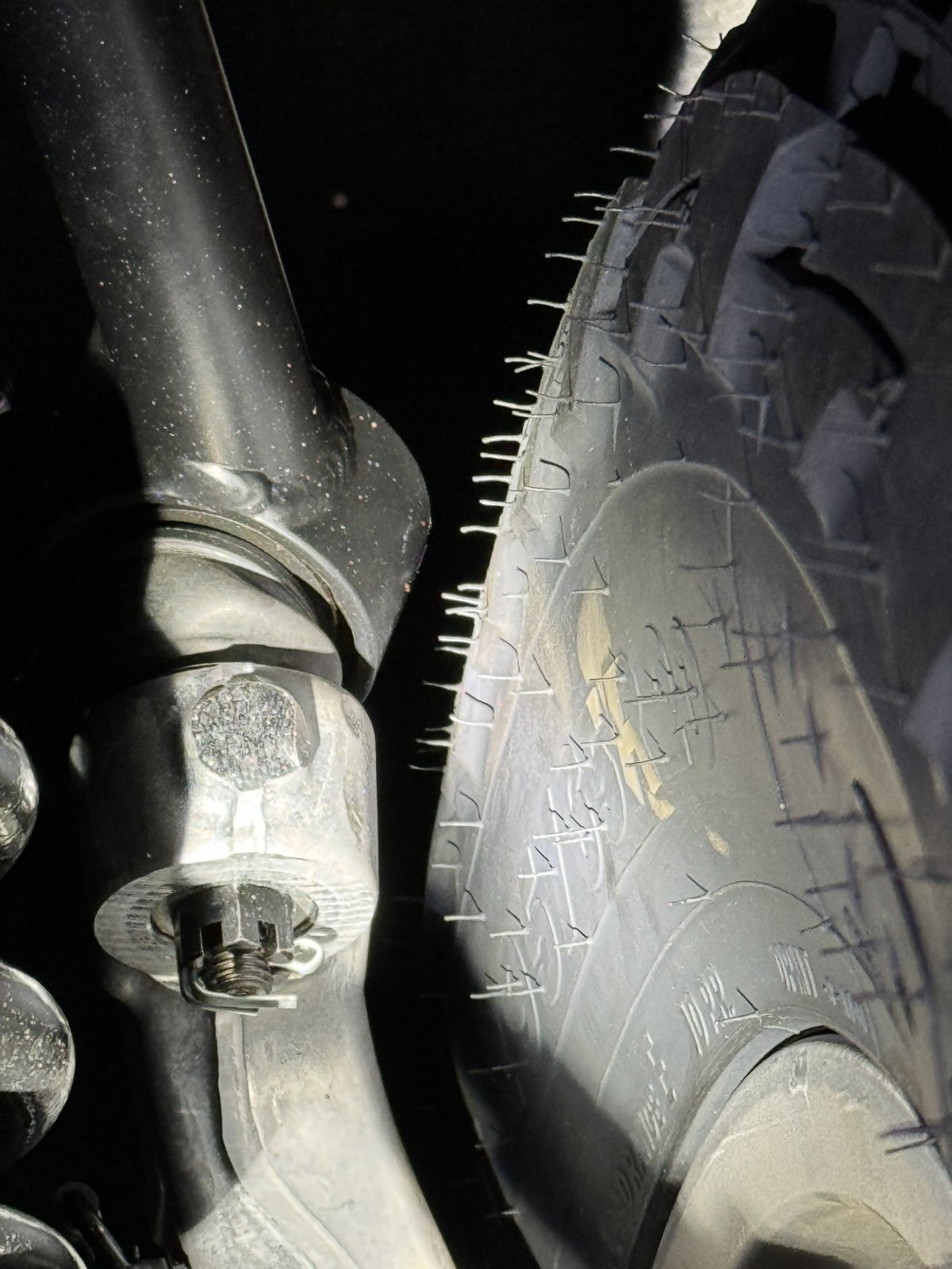

    This is how close it is to the upper control arms with the 295s. Another inch would not work without running a spacer.

    yea that is a damn tight fit. Did your UCA ever actually make contact or you just weren’t a big fan of how close they were?

    That looks perfect. Well done

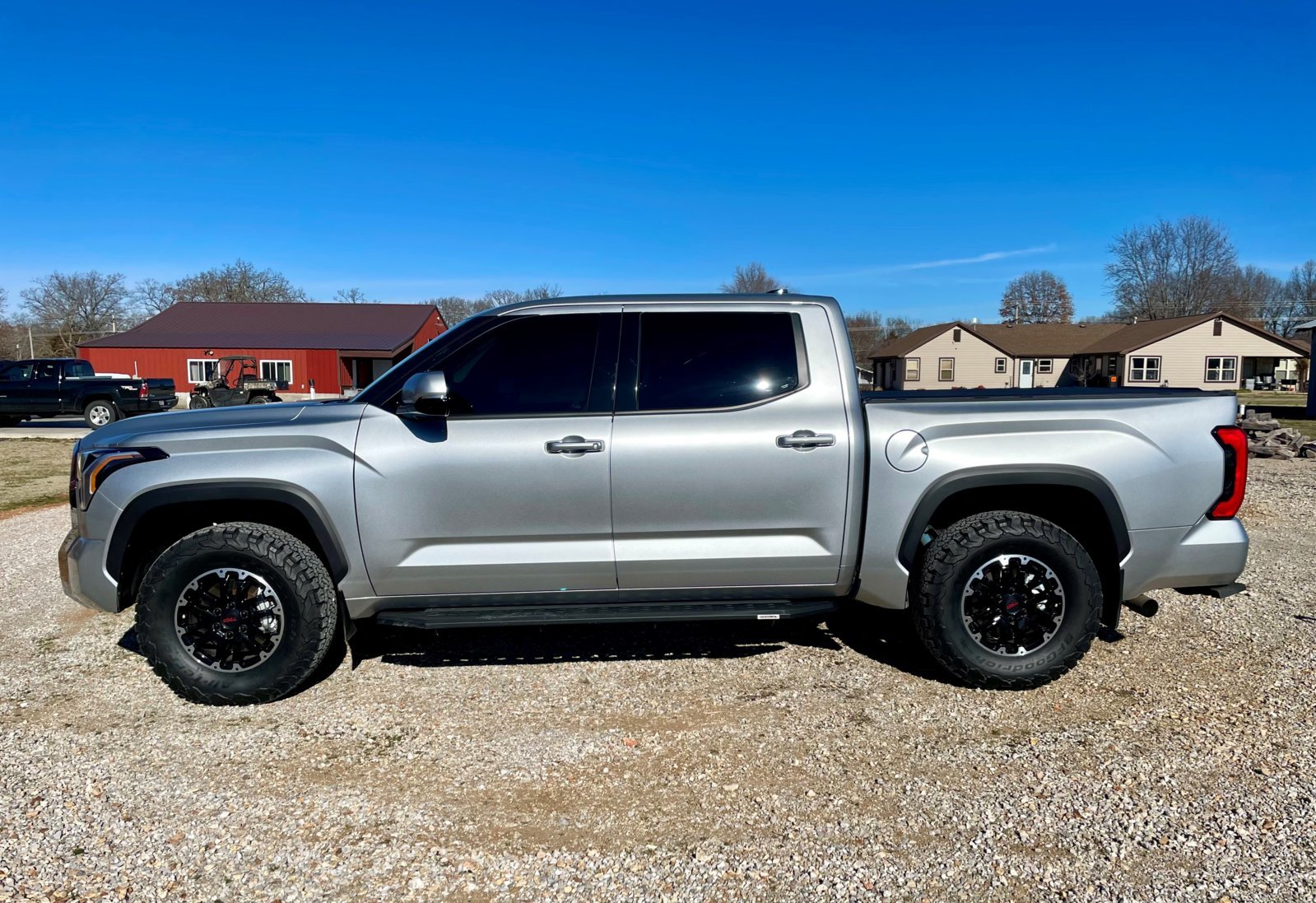

    BFG KO2 295/70/18. No spacer needed. No rubbing with stock everything. Pic is after Cornfed 1" front spacer.

    Would this rub if you had mud flaps? Also, any pics from the side view to see how much they stick out of the fenders?

    I can’t see how as that’s a 33.4” tire and my 34.5” tires were fine with oem mud flaps. Also mine are a little wider at 295mm

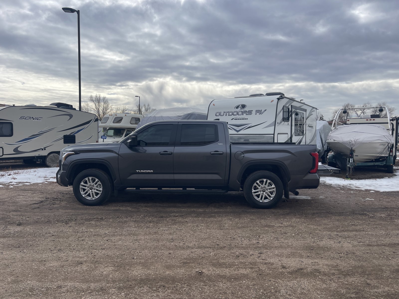

    Well here’s a view of one that’s fleveled with the standard factory air. :burp:

    IMO, Those stock TRD OR rims look good on the lighter colored trucks, not darker. This looks good.

    The trucks with rear air suspension are already leveled. This is the standard factory air setting. They are fleveled.

    Yep, I have the rear air. But not the AVS. Wait—I don’t think I have the AVS. I think that’s an added air feature.
    I’m trying to make up a new word. Fleveled means factory leveled. All of the third gen trucks with RAS (rear air suspension) are stock level with the air setting on Normal. There are three settings H,L, and Normal.
    There’s at least one thread here where guys are adjusting a bracket under the truck to keep the air at the H setting all the time (adds rake). Here is the truck on H:

    So yes, sorry. To answer the question, the air suspension is 0” rake with the air set at Normal.

    Nope. Plenty of room. I'd probably go 285/65/20 next time. I don't think I have any pictures down the side. I'd say the tires are inset about an inch from the flares. It would be about perfect with a one inch spacer. I'm about to list the truck for sale if anyone is interested. Need to go back to an HD.

    so you didnt use anything in the rear? i like the pic of your truck. thats the look i want. just a slight rake.
