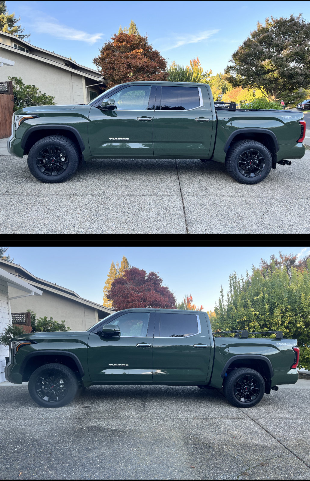

    Top photo are the new tires (285/65) - both on just a 1” cornfed front level (disregard the grease on wheels as this was right after install).IMG_4303.jpg

    After my 1” cornfed front level my alignment only needed a toe adjustment. I’m sitting a little higher in the rear, can’t remember exact measurements but the level gave me exactly 1” of lift in the front. If you have the same fender measurement front and rear it’ll look nose high.

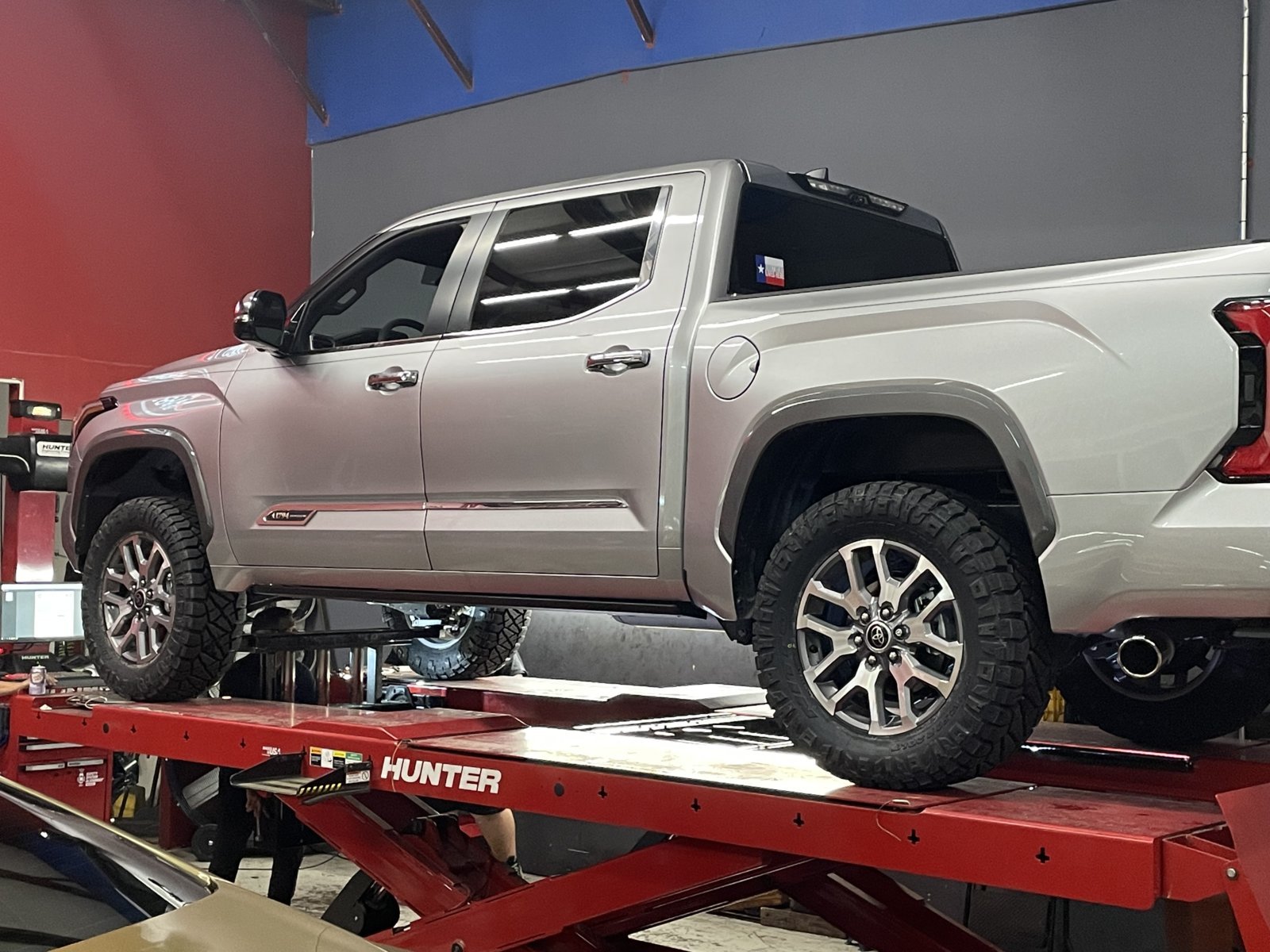

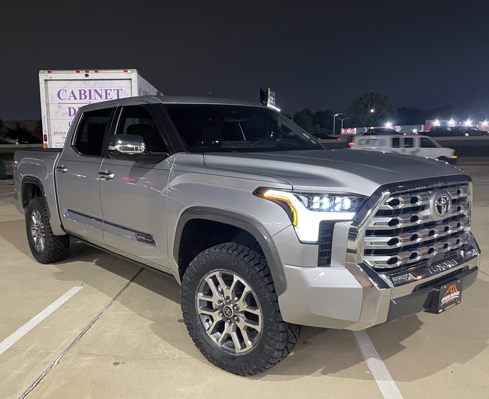

    3” SST Lift, Factory 20” Wheels, 35x12.5R20 Nitto Ridge Grapplers
    3” SST ReadyLift, Factory 20” Wheels, 35x12.50R20 Nitto Ridge Grapplers. Rides great with no rubbing. IMG_6204.jpgIMG_6207.jpg

    Did your gas mileage go down much doing this ?

    Sure did! Was getting 17.4 city and went down to 15.2 (normal drive mode). Not sure on a long highway road trip yet when I can use Eco-drive. I think the 35” Nitto Ridge Grapplers were lighter than the Toyo M/Ts I was looking at, but the weight and size does eat more gas.

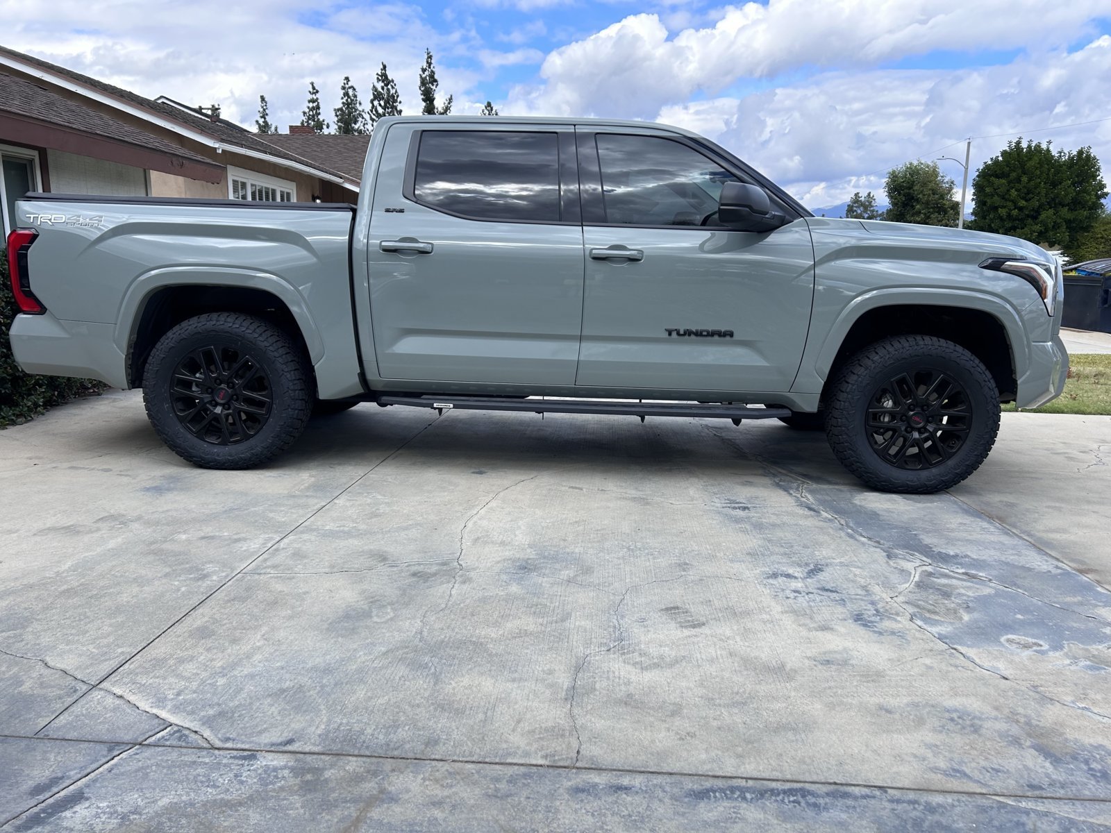

    IMG_2905.jpg Here’s mine with RC M1 at 1.75” with 275/65/20. Front slightly higher than rear. Going to order 1” rear cornfed spacer

    That 3” SST ReadyLift goes 3” in front and 1.25” on rear. When I measured from ground to top of fender prior to lift, front was 36” and rear was 38”. After 3/1.25, it looks level but have not measured yet. Hated that much front end slope new from factory. Other option I was considering was just going with RC 2” spacers on front, but ultimately opted for the 3” SST ReadyLift.

    Yeah it is a little high in the front but still looks great. I'm so torn on how to level mine. Seems like all the kits raise the sport higher than the rest and confused as to how that happens. Almost tempted to just do a 1" spacer and call it a day. I want to keep some rake. What size tire is that?

    Nevermind. . I just saw the tire size!

    Nice shot of the tire size diiference.

    Maybe get cornfed 2/1 spacer kit. I just felt our sport model is too low in the front. Looks like a low rider

    They definitely are. . But she does handle good!

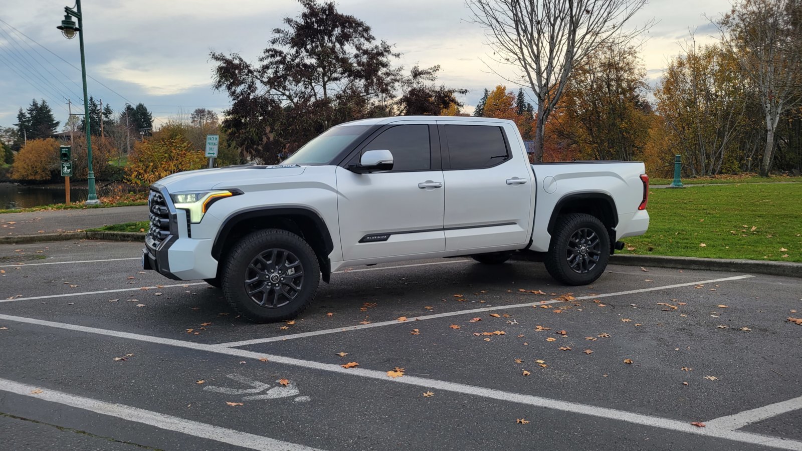

    Dobinsons IMS 2"/1", BMS 1" Wheel spacers with OEM Platinum Wheels. Icon Sway Bar Spacer. 285/65/20 Firestone Destination XT Tires.
    2/1" Dobinsons IMS and 285/65/20 Destination XT's
