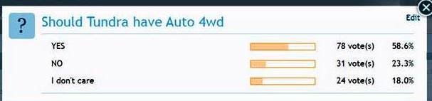

    If I was on the engineering team or part of their focus groups I would have setups similar to what Toyota does with the 4Runner on the Tundra also.
    The models that will "probably" rarely leave the pavement - (No TRD option - Capstone, Platinum) - give them the Auto 4wd.
    For all models with TRD or the TRD Pro - no Auto but include the rear locker instead.
    The 4Runners are made in Japan and I suspect a different focus group with dare I say it - seem to have better vision.
    I think the above would make both camps happy. Those commuting in bad weather and those going offroad.
    Camp A - Yes ....Camp B - NO and I don't care
    Surprisingly consistent numbers still.

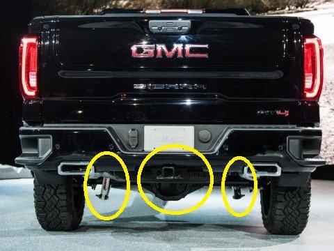

    I am a fan of vehicles designed to go off road that have smart clean undersides.
    Things that can get banged are tucked away. The Outback excels at this The Tundra has always been good as well as the Ford F150.
    Like wise I can't stand GM trucks with their Old Man Balls Rear suspensions.
