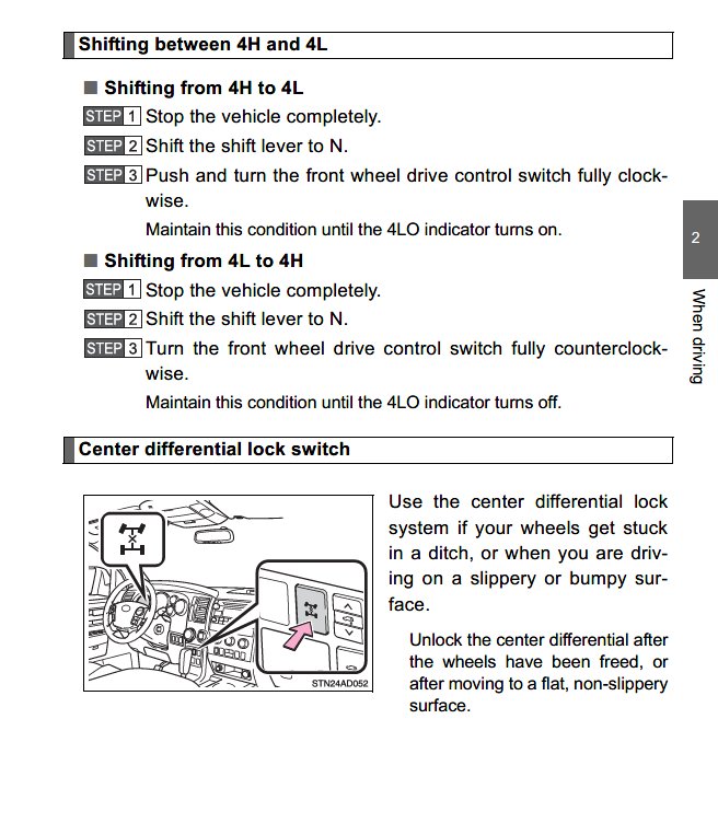

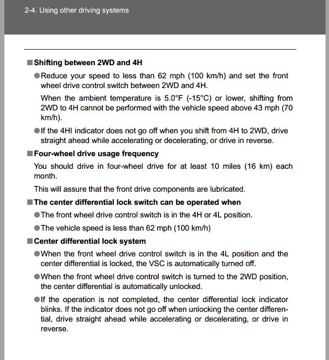

  11. Jul 25, 2022 at 2:05 PM
    #41
    e30cabrio
    Oct 20, 2017
    #10410
    6,365
    West Valley, Phoenix, Az.
    Boosted 2013 Sequoia TRD FAUX
    I think you are forgetting the Sequoia has a center diff locker. It is off unless needed and the truck runs LIKE AWD.

    when it has a center diff lock they just call it 4hi or 4lo. There is no 4Auto.
    you can be in 4hi or 4lo on pavement because it keeps the center diff unlocked until you hit the button. I use 4Lo unlocked for moving my trailer around on pavement all the time. Its awesome because it gives you the gear reduction without the binding.
    And even offroad I almost never lock the diff in 4Lo.
