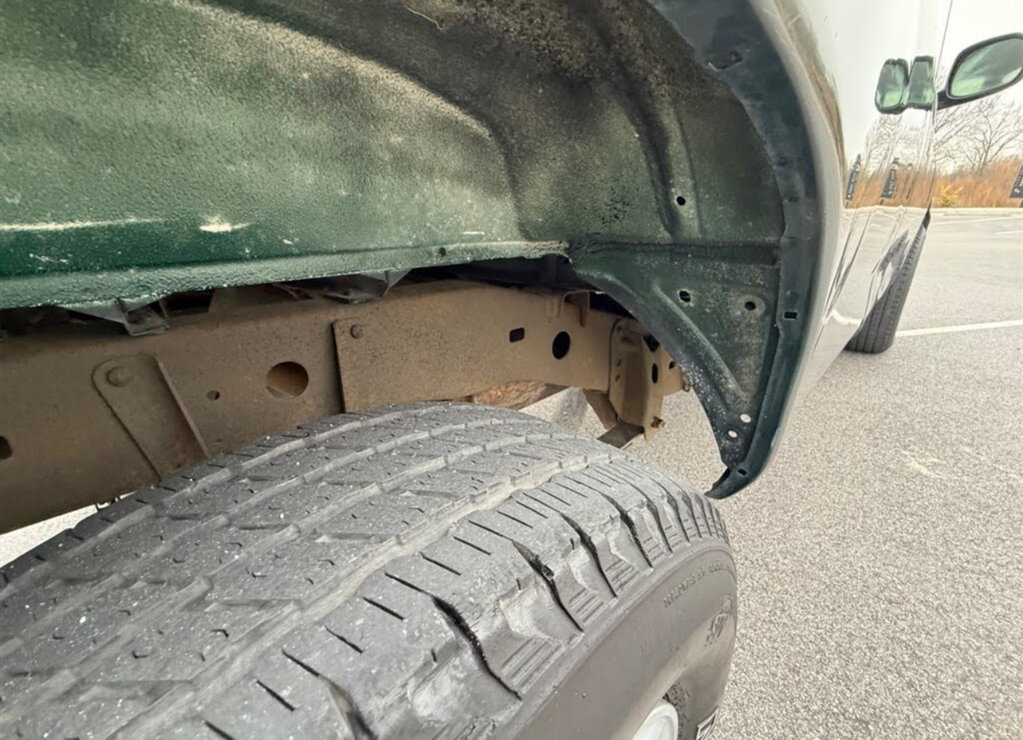

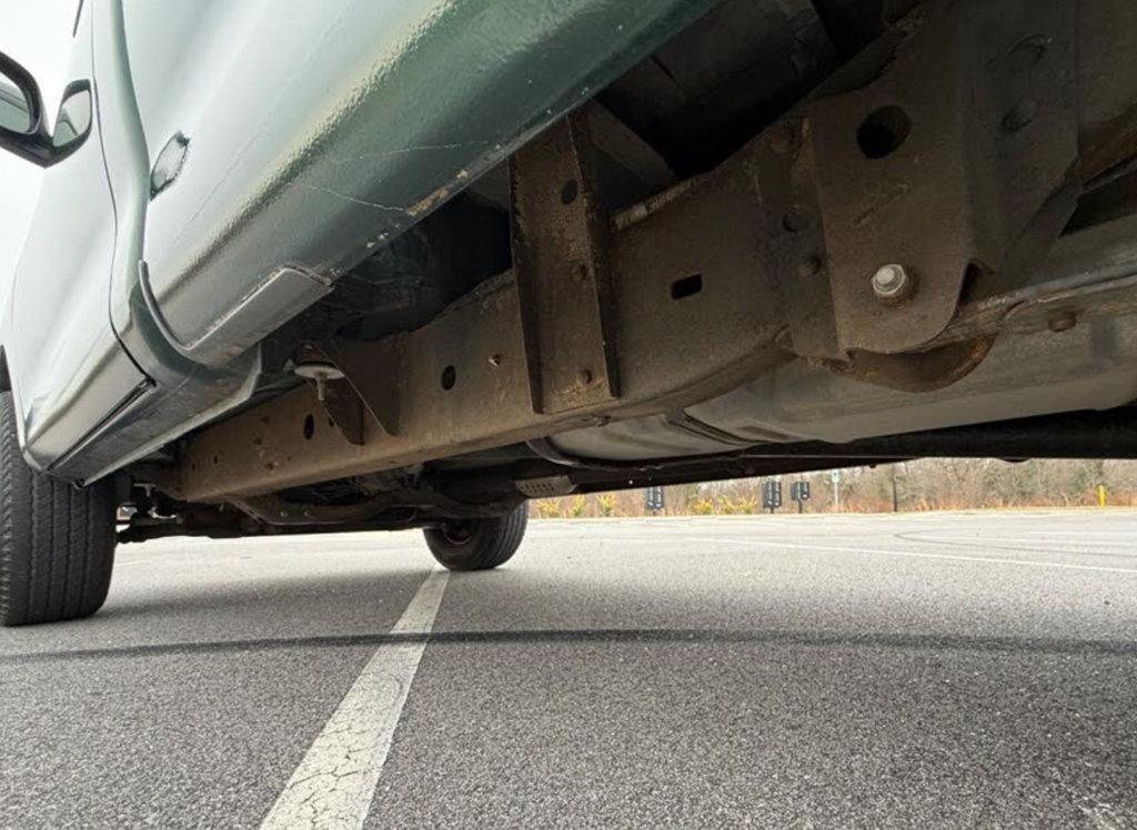

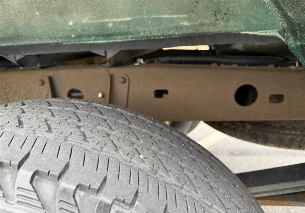

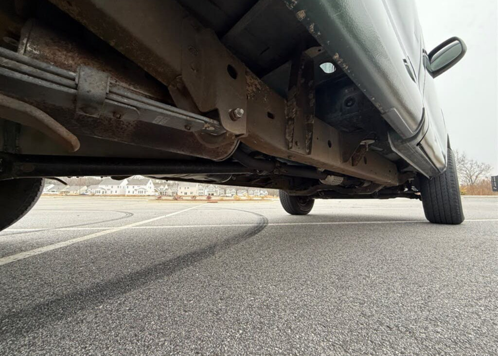

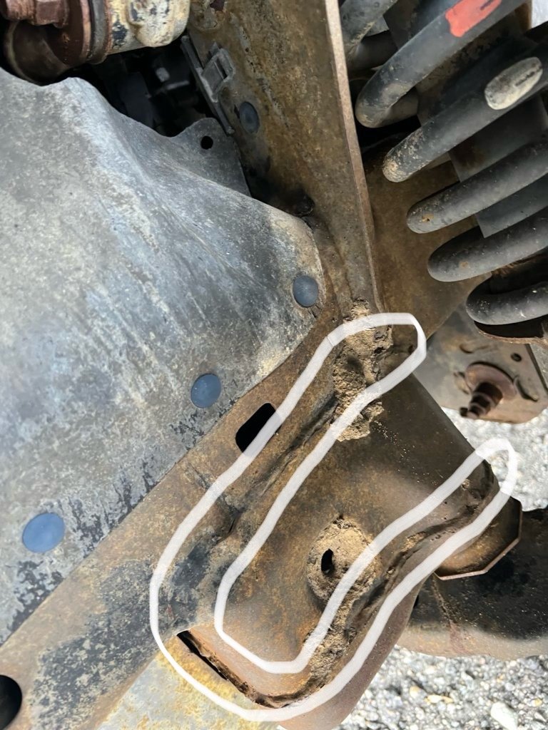

    IMG_9925.jpg IMG_9926.jpg IMG_9925.jpg IMG_9926.jpg IMG_9925.jpg IMG_9926.jpg I found this 2003 v6 manual 2wd 115kmiles going for $9k. It was originally from Hilton Head Island South Carolina (coast). I heard really good things about these trucks and this will be my first truck; I am just really worried about rust. Do you good people think I should walk away?

    I don’t see anything crazy in those few photos. That all looks very superficial.

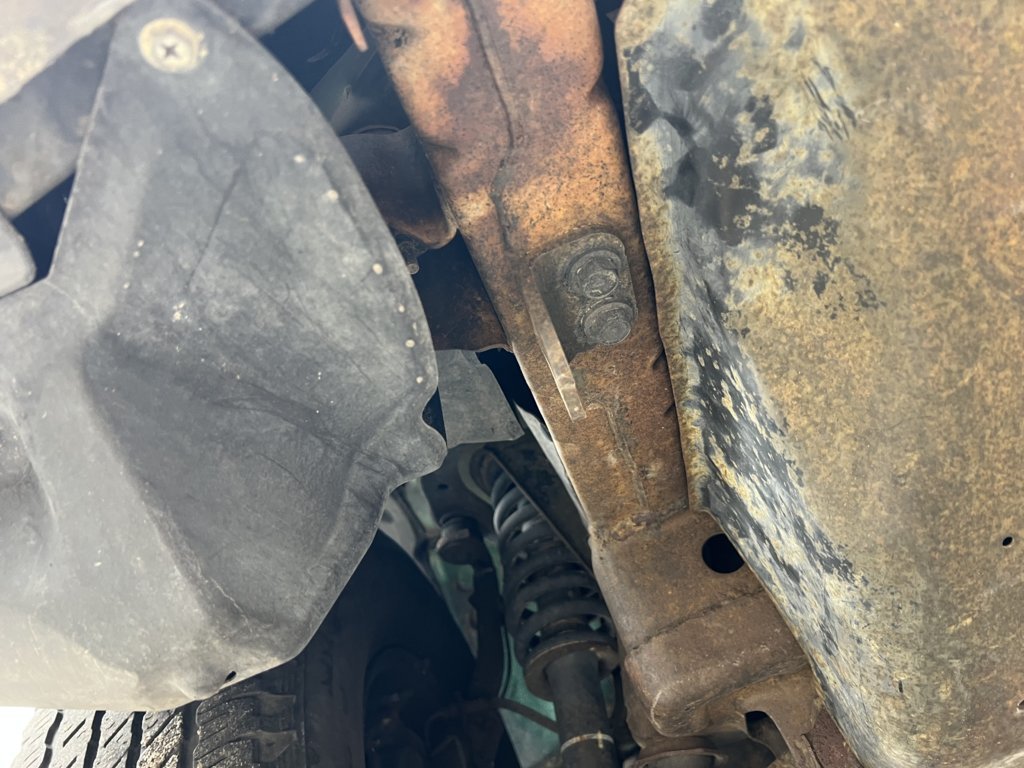

    The photos don’t show the most problematic areas. Inside frame where the stiffeners and braces are, especially the X brace for the spare tire. Also the front frame rails beneath the fire wall where it’s boxed in.

    Look at the rust on the UCA bolt

    Here is what I did. I test drove it over to a muffler shop/repair shop where they immediately got it on a lift, took a look under it, and gave me their opinion.
    Shop time cost nothing (I went in and asked them the day before if they'd do it for me) but I tipped the owner a bit for his time.
    That looks just like surface rust, no big deal, but I can't really tell. I told the owner "I want a test drive and that will be to a shop to check the computer and get it onto a lift."

    That doesn't look bad. I've seen worst

    The exact setup OP is looking at would easily be $2,000 cheaper in my area one state south (or even less), with far less rust. My beef is more with this being an unfavorable drivetrain configuration for $9,000, but hear me out on one other thing.
    That’s not an unsubstantial amount of rust, and it’s coating everything, as if the truck was underwater. And given all the flooding from NC TO FL to LA in the last 6-12 months, I wouldn’t trust that shit farther than I could throw it.
    @Ergo21 if you’re still reading, do you have any way to confirm this truck was NOT in a flood? That is NOT typical rust for SC. Even for a coastal area like HH. It’s covering everything. That’s suspicious as hell. Airborne salt doesn’t coat to that level, and the bright orange spots are suspect too.

    This is a VERY good point. I was kind of scratching my head and wondering why that rust looked so "uniform". I think this one's asking for trouble. Not to mention 2wd, V6 for $9K. Pssssshhhht...Fuggettaboutit.

    The bumper is very rusty. More rusty than my frame-swapped New Yorker. I would inspect the chassis at the problem areas

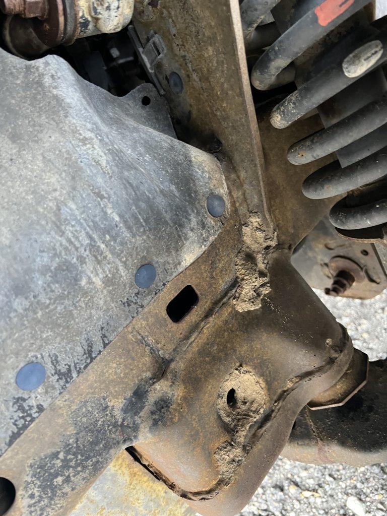

    What am I looking at here?!? It almost looks like a part was cut out and welded back in there; poorly. Very bizzare.
    Other than that, for what I’m seeing, it just looks like a lot of surface rust. Interesting how it completely coats the frame for a vehicle that lives next to the ocean.
