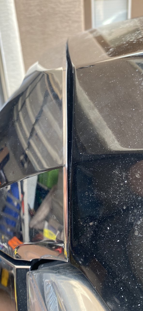

    just bought a pack thank you for the link. you think itll fix the gap issue im having in the corners?

    Should help a little but mine also does that in the corners at times then goes back in just the way they corner is on that

    I spoke to someone about this gap. They said you can reduce it almost to zero if you have someone push the bulge snug against the hood while the other person cinches down the 10mm bolt that attaches the bulge to the hood, then repeat on the other side.

    im gonna try this in the morning, its probably gonna keep me up at night just thinking about it lmao. my damn ocd...

    :rofl: I tried it and it worked for the most part. Just remember nobody sees it besides you haha

    Tighten the 10mm bolt fixed the gap on mine ,

    Be careful tightening those bolts. Those mounting locations will snap off of the bulge.
