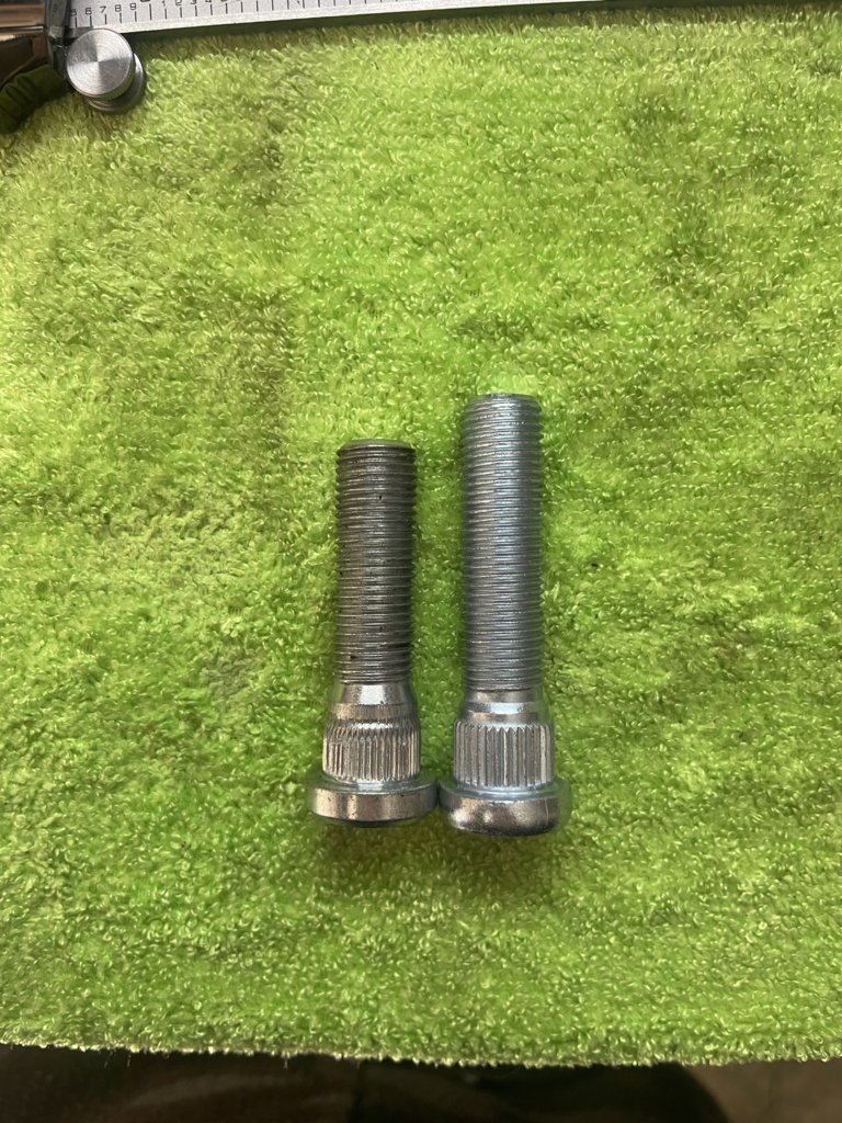

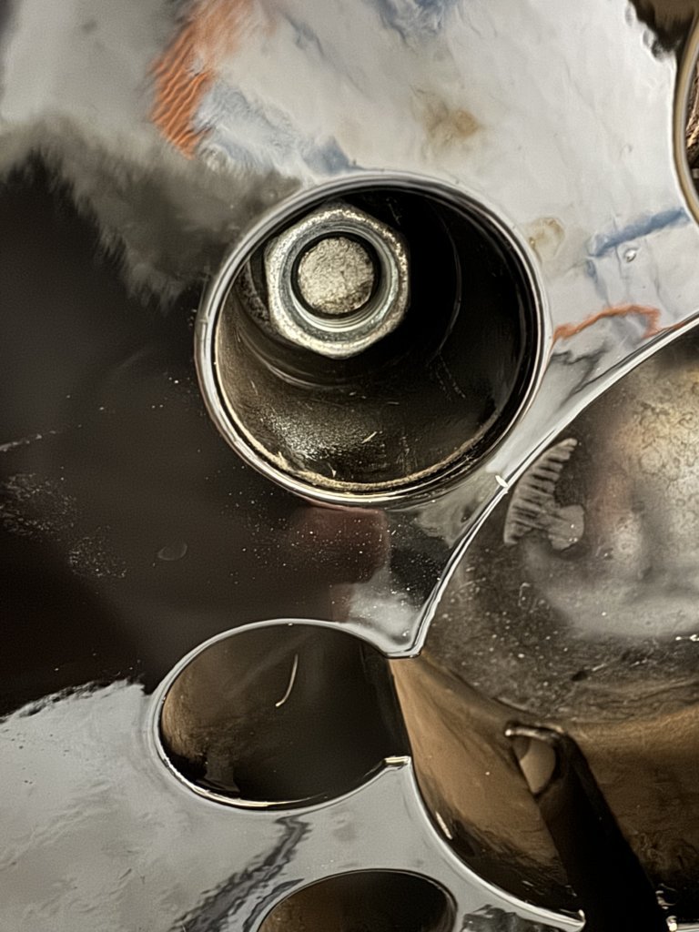

    5000 miles ago I had new wheels and tires put on. Yesterday, at 30k, I did an oil change, swapped air/cabin filters, and did a brake fluid flush. When I was putting my tires back on, I noticed just how short the wheel stud is with the new wheels. Should I get longer studs?
    Also, is the normal? These are Fuel wheels and I can't imagine that this is something every Fuel owner (or any aftermarket wheel) has to regularly fix.

    Not normal. Not an expert but thinking you should have 1-2 threads of stud thru the nut.

    I’ve added longer studs to the front and would recommend it. Never liked the small amount of engagement. Two options eBay lugs ran by a few myself included or ones from Japan also good which I’ve ran as well. Both longer than stock
