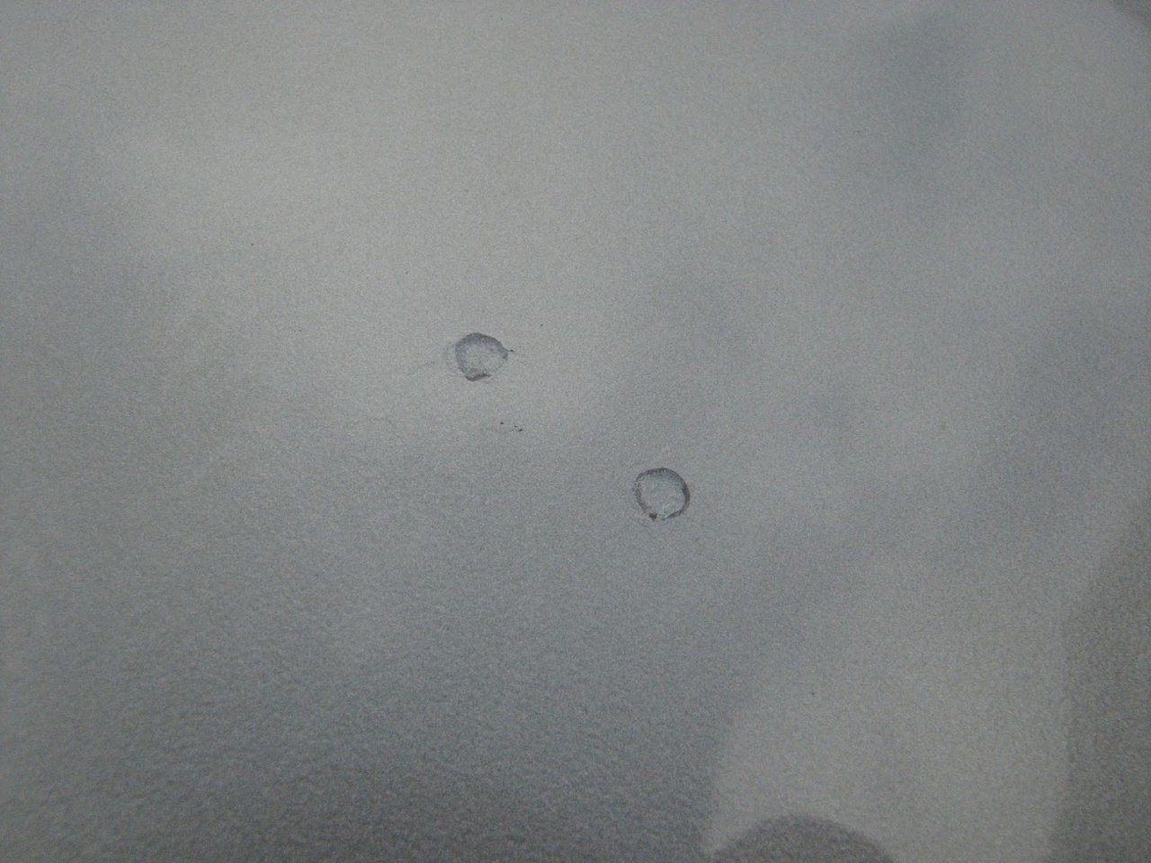

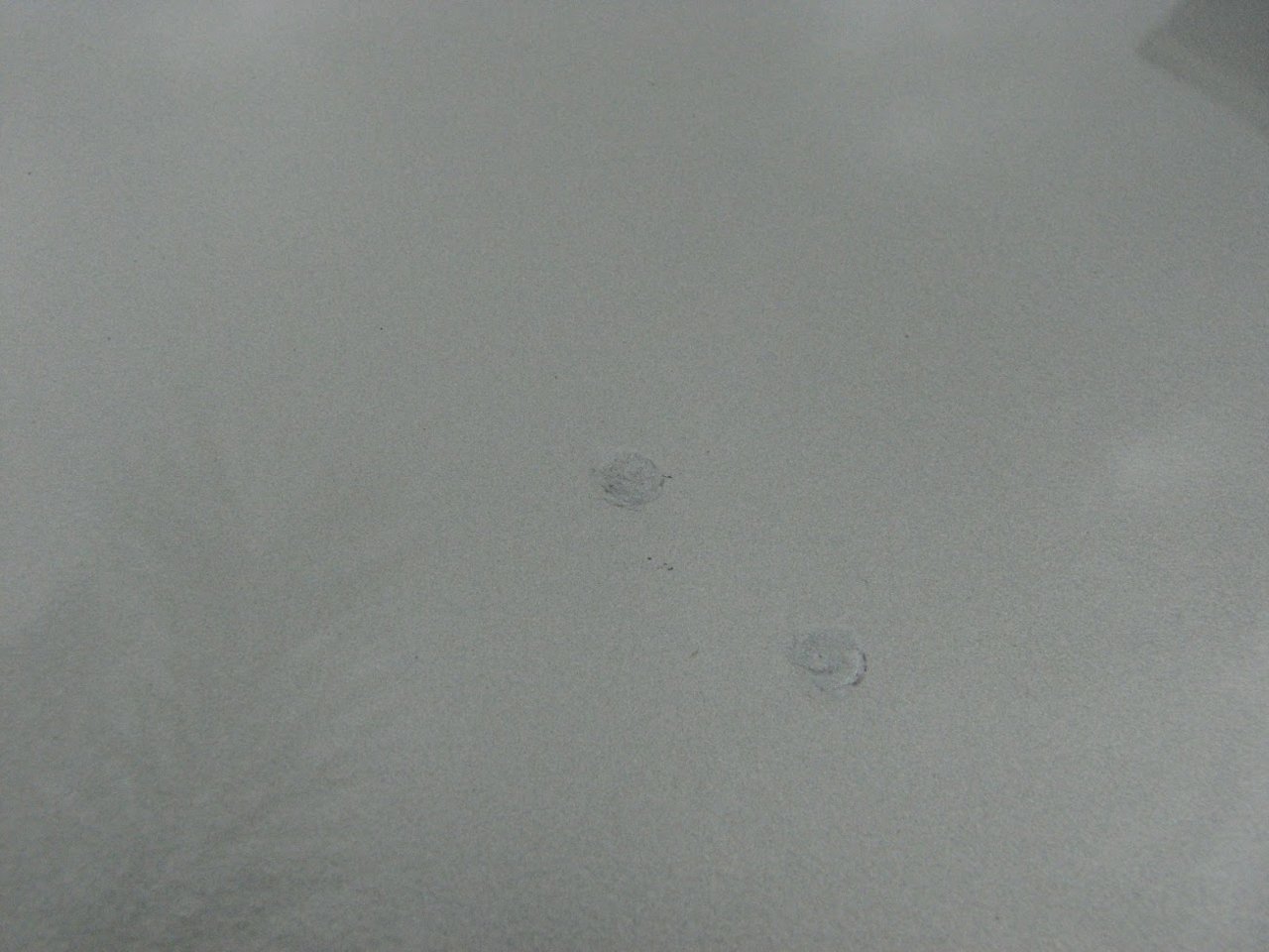

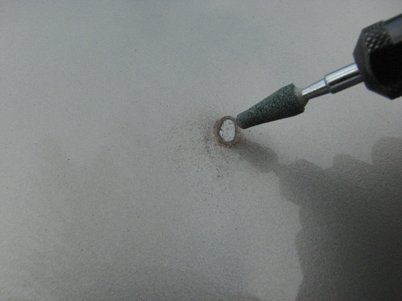

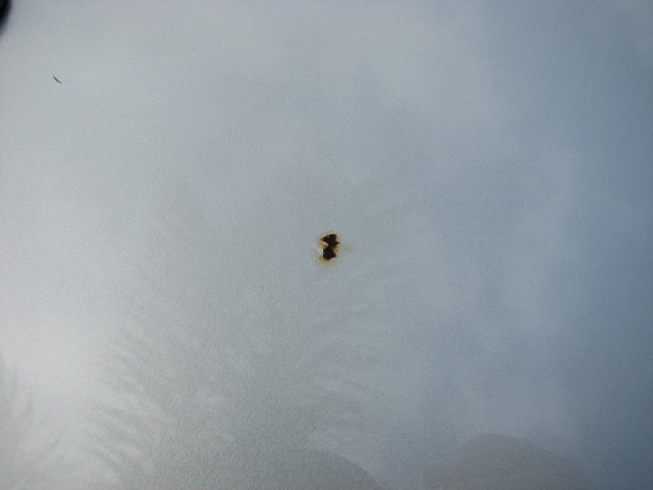

    I see OP has done the right thing and have it professionally repaired, however, if you don't want to spend that money or effort, this is how I had fixed a previous truck. I had a few rust spots from rock chips or something that developed in short time after the rocks(?) hit it. There were several similar spots on my roof. I used a dremel to clean it all the way to bare metal, and then applied touch up paint in layers, and then clear coat, and wet sanded it. This was in 2013, and when I sold the truck in 2018 it still looked like the day I fixed it. I am sure if I did not do anything it would have been a totally different picture 5 years later.

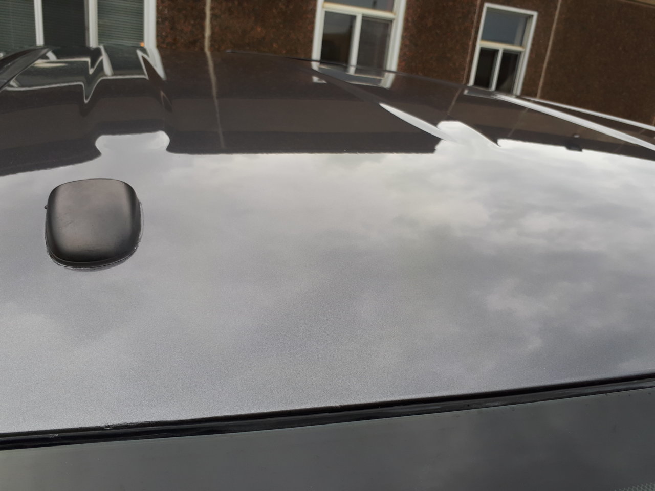

    Here's the results...raining pretty good so didn't microscope it but looks good to me.

    Not trying to be critical bur that edge should look smoother for $600.00 Just my .02

    I wouldn't be happy with that edge above the gasket. You're not going to like this recommendation, but they should have pulled the windshield to do it right.

    Weather was crap when I picked it up...after I blew up he picture noticed the edge so I went put to touch it. ..yup it's rough
    Going back Monday to see what's up, wish I could say I can't believe places would put out stuff like that...but I can.
    Should of keep my old 05 tundra, few dents and scratches but no bubble rust....I hate bubbled rust

    As mentioned, my windshield was pulled to treat it correctly. It may be difficult to get right without pulling.
    Do you know if it was pulled?
    The paint looks good. :thumbsup:

    When I was talking with the adjuster before the fix , he said if they could fix it without pulling the windshield they wouldn't....I'm guessing it wasn't pulled. I'll see what he thinks on Monday, as long as the thing doesn't start to rust , I'll probably just walk away with another life lesson but I want to hear him say that is as good as they could do. I like to know if people are honest, I've bought 3 and still have 1 vehicle from this dealership.
