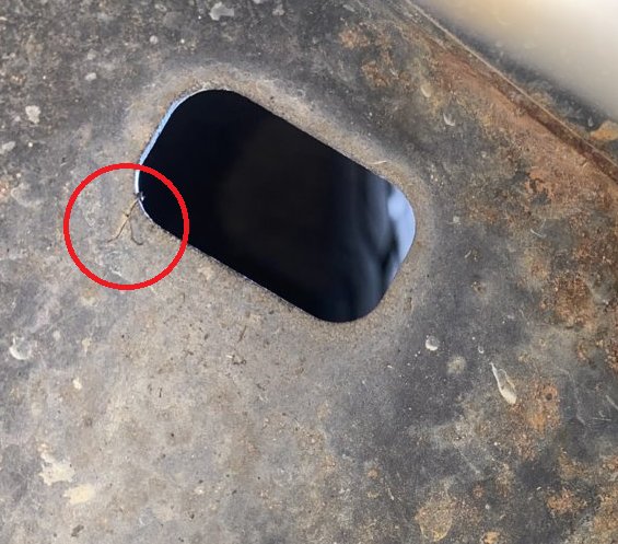

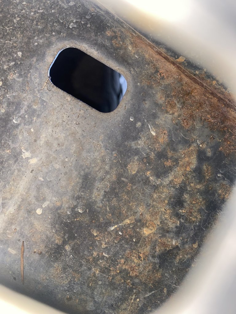

  9. May 27, 2025 at 11:03 AM

  10. May 27, 2025 at 11:13 AM

    That's nothing for rust. It's just surface rust. I recently sold my 2020 tundra and bought a 98 GMC Z71, 27 years old. Engine is 185-190 compression all a round. Transmission, rear diff, front diff and transfer case all work perfect. Everything in the truck works. But, older trucks take a bit more maintenance than say a 10 year old truck. With that said, I love tundras, have had 4 of them, but like others have said, they require attention. When I recently bought my truck, it didn't require much other than breaks and change all the fluids. Eventually I will do some suspension work, replace ball joints, tie rods, shocks, etc. My truck is a bit less complicated than the tundra and I know my way around a Chevy, so it's easy for me to work on them. The tundras are a bit more complicated as far as electrical stuff but mechanical wise, it's about the same. Price doesn't seem bad, I haven't really look at older tundra prices but they do hold their value. I would say that if you aren't to mechanically inclined, have someone that is looking it over.

    shifty`
    shifty` All my rowdy friends have settled down
    Jun 20, 2020
    #48239
    29,070
    ATL
    '06 AC Limited V8/4WD
    What am I looking at/through? That amount of rust doesn't look god-awful but ...
    I only ask because this is either a basic scratch, or a crack in the steel.
