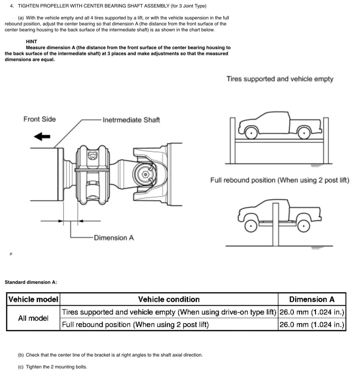

    Honestly the only thing that reduced the shudder dramatically was getting the angles as close to spec by measuring the angles of the drive lines and flange on the differentials

    Also, I checked this and I’m off by a bit (3mm). I’ll have to readjust it and see what’s up!
    ZPhilip[QUOTED] likes this.

    Do you know what are the ideal angles are?

    This is awesome, thanks.
    drew.c.114[QUOTED] likes this.
