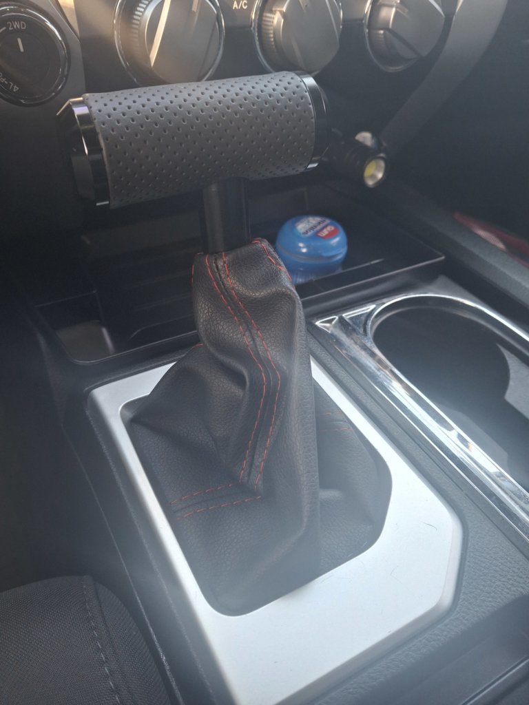

    not trying to sound sarcastic... just really explaining it. it was really easy ... i think
    bought faux alligator leather, made a template on scrap fabric from old t-shirts and tested out till satisfied, then cut and sew it together. for the shifter, found one i liked, looked old school. none of the included adapters fitted the tundra shifter post so i went to the hardware store, found a bold that screwed onto the trd shifter then i found a nut (two actually) that matched the bolt.
    screwed the two nuts onto the bolt very tightly then grind them round and smooth till they fitted into the shifter where the adapters would have gone. filled the hole with two part epoxy and put the bolt with the two nuts still on it into the shifter. let it dry, removed the bolt and installed in truck.
    these are the only additional pictures i have of when i made it.
    if u have any more questions, i will be happy to answer.

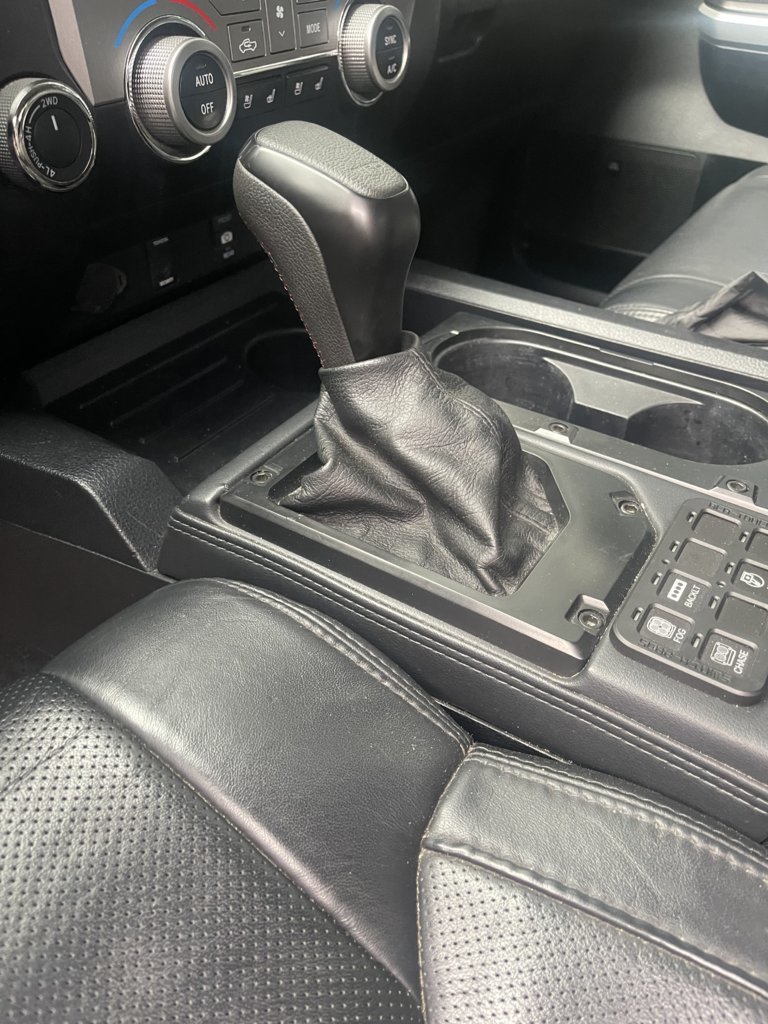

    Looks good, with the longer TRD knob, did you trim the top of the boot or just fold it over?

    Nope just fold it in.

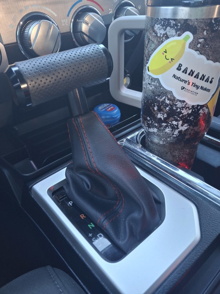

    Slightly modified Temu shift knob (pit the thread adapter in from the top instead of the bottom to lower it by an inch or so) and an Amazon boot.
