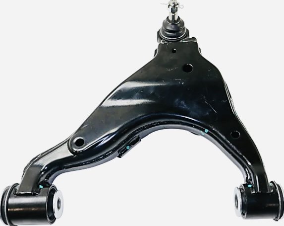

    I know post is old. I had the same issues with shaking around 55mph on my older Tacoma and now on my TUNDRA.
    Started happening around 80k miles on each truck as I actually use my truck for a truck and off-road here and there like a maniac!
    After doing the easier stuff myself 1st, u joints, carrier bearing, alignment, rotation, balance, etc. didn’t resolve the annoying vibrations at 55mph.
    The fix for me was replacing the lower control arm bushings and ball joint.
    A lot easier and faster when doing these fixes in my back yard then paying a shop 300% more!
    Easier to replace the arm with the bushings installed. More cost affective.
    I did replace the bolts also because the old bolts were hurting.
    You will also have to get aligned afterwards.
    Later I have the time to rebuild the old arms if I wish.IMG_6308.jpg IMG_6308.jpg
    Although I’ve had no issues so far 50k later. Hope this helps!
