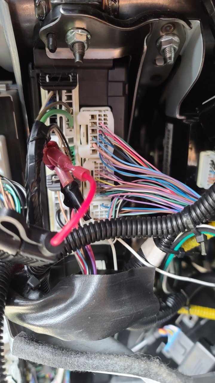

    Well, you guys couldn't have had a more incompetent guinea pig. Can any one tell me where connector 3H is referenced on page 24? Trying to get this installed today.

    It looks like it's in the clusterf*ck of connections behind the panel to the left of the steering wheel. I'm out of town at the moment so can't go out to my truck to verify.

    That's what I was thinking but my clusterf*ck looks nothing like theirs.20201017_114242.jpg
    Thanks for the response. Safe travels, man.

    Looks like the directions are split depending on whether your truck has memory seats or not.

    Yep, I did determine that. I do have the memory seats so I wanted to tap into that harness. I did figure out which harness I need to tap into but now the question is which one is the Rear Window Defogger wire that would be the 2017 equivalent.

    Okay, got a good news/bad news scenario for you folks, or at least until someone does it better because I still couldn't figure out the 3H connection.
    I think I got everything else down. So, the good news is, it works! The bad news, it won't lock the truck from the keypad and when it unlocks, it unlocks all doors and not just the driver. So, you don't have to hold the last number to unlock all doors. I don't know if I tapped into the wrong wires or if there's a different equivalent for pre-2020.
