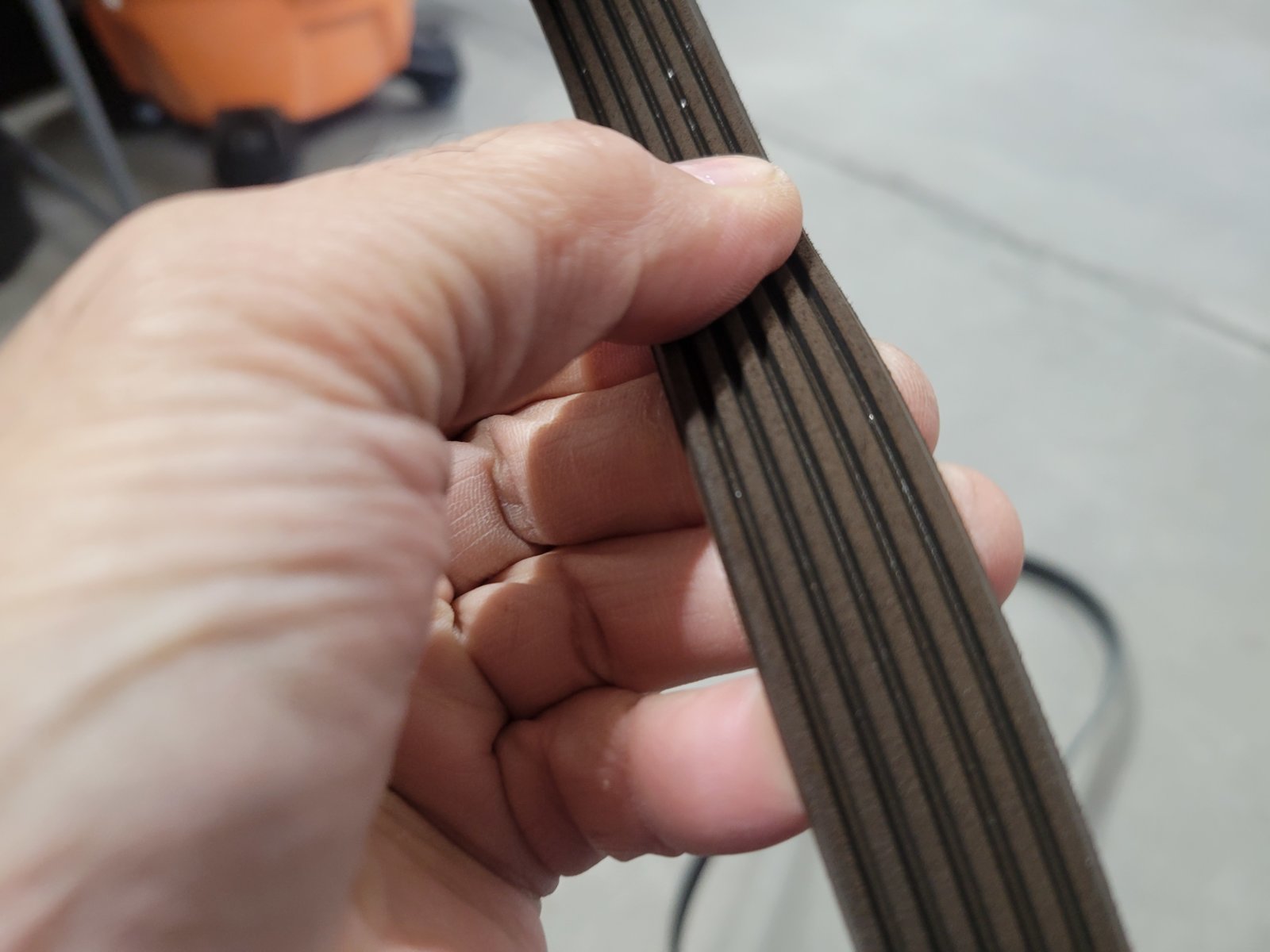

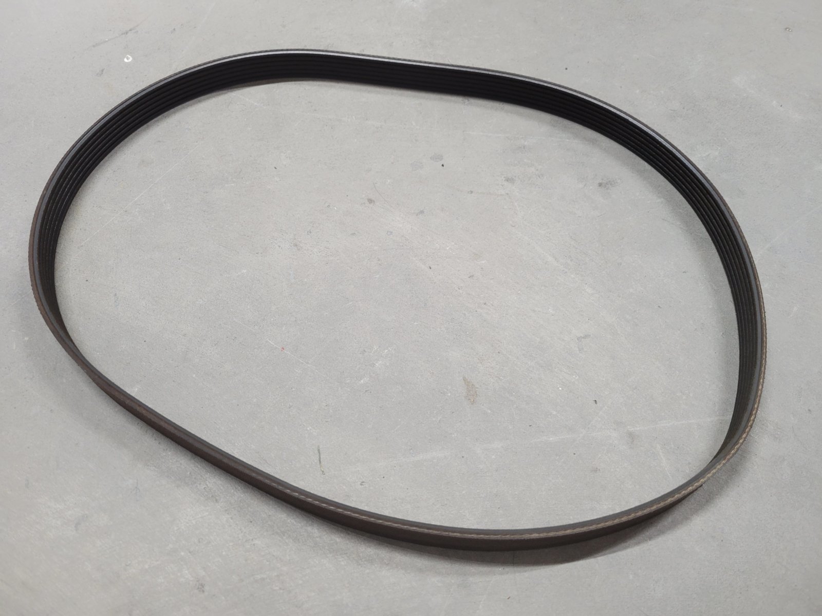

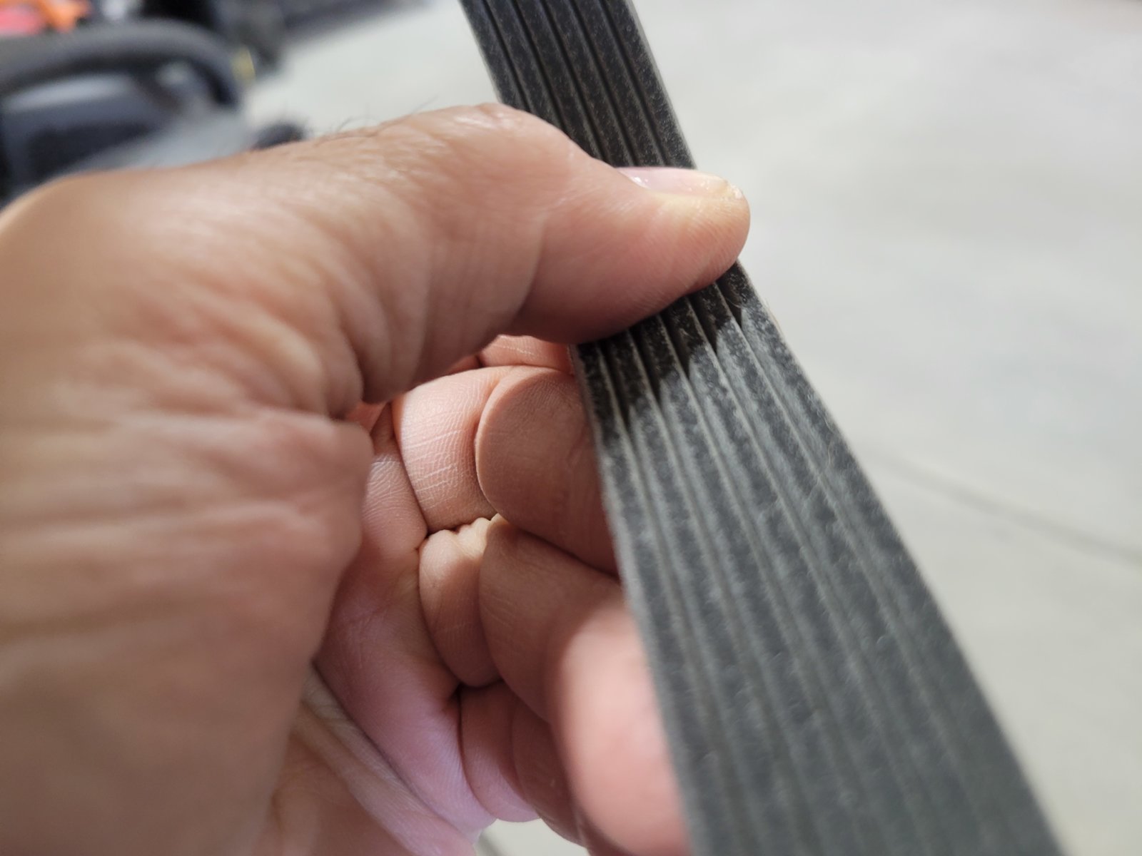

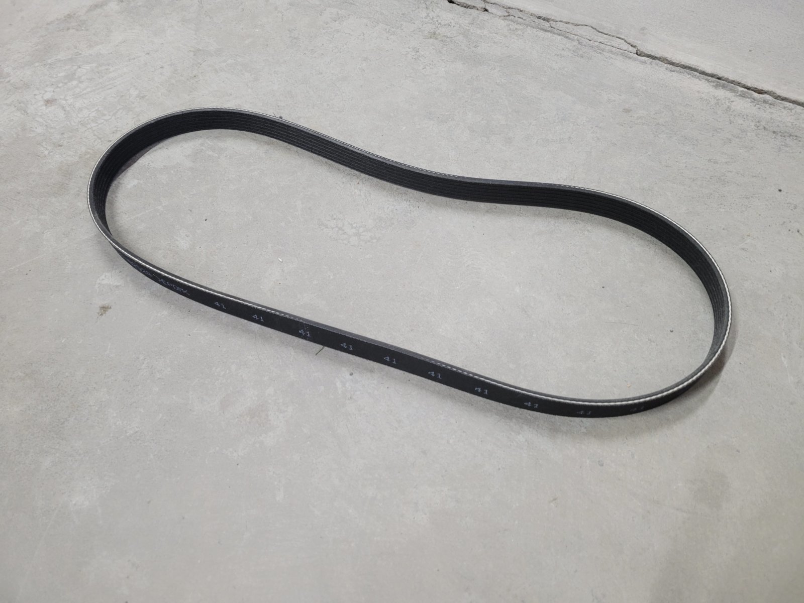

    B&A pics....
    (1st two are the old one)
    20240414_133319.jpg 20240414_133301.jpg 20240414_133314.jpg 20240414_133305.jpg
    Sadly, I began to install the new one, I noticed a 2nd belt!
    Gotta order that & circle back to this as It seems you need to remove the front most belt to do the 2nd belt
    So I will need to remove what I did today & reinstall after I get to the back one!!!
    Took about 15 mins to do
    Remove the skid plate for easier accessibility
    the tensioner pulley is on the top right side if you are facing the motor from the front (most easily accessible from the top)
    I have not confirmed the tensioner for the 2nd belt, but i believe its only accesible from below (im going test the lower pulley i found as soon as i post this)
    Note- it's some tight clearances on these belts, heads up if you are doing it
