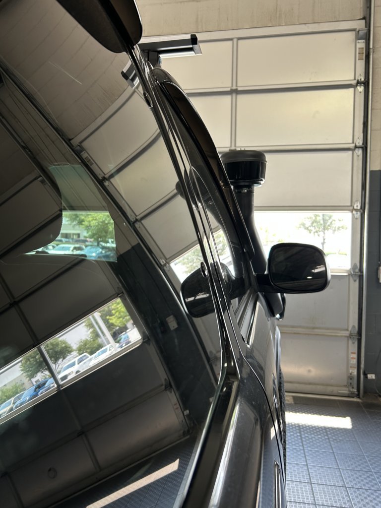

    Today I took a ratchet strap to the snorkel head, pulled it towards the A pillar and took a heat gun to it. We will see how well it stays…

    Heat gun for the win

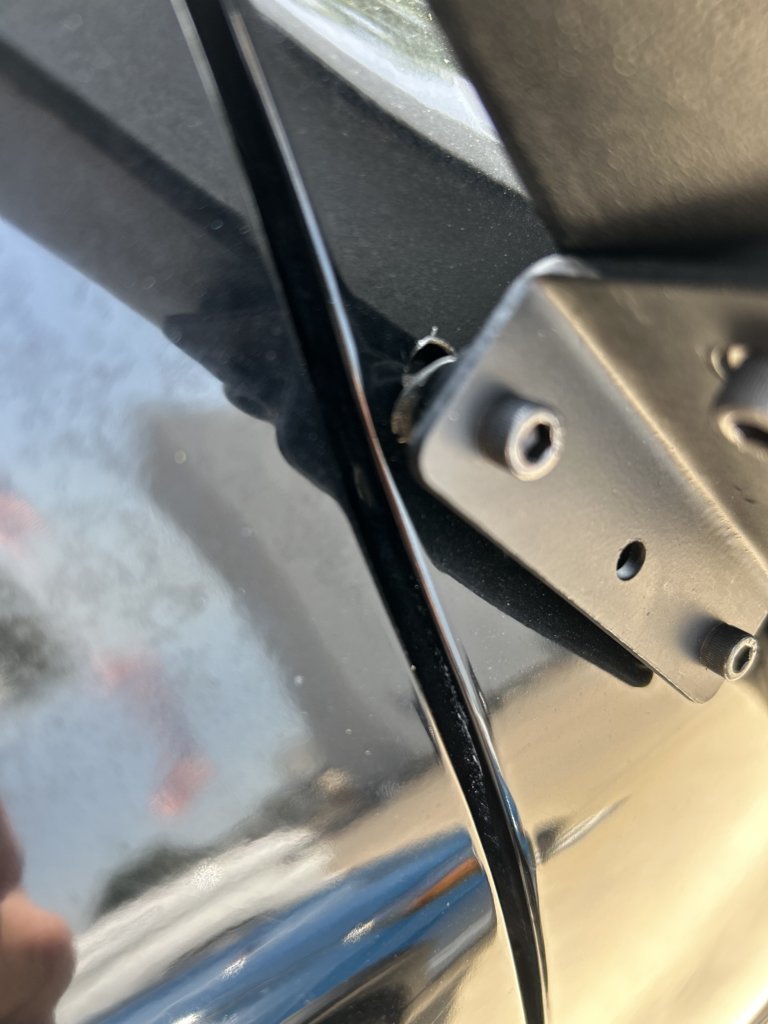

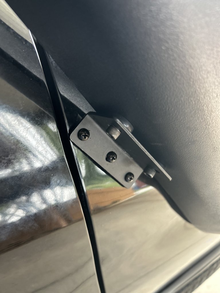

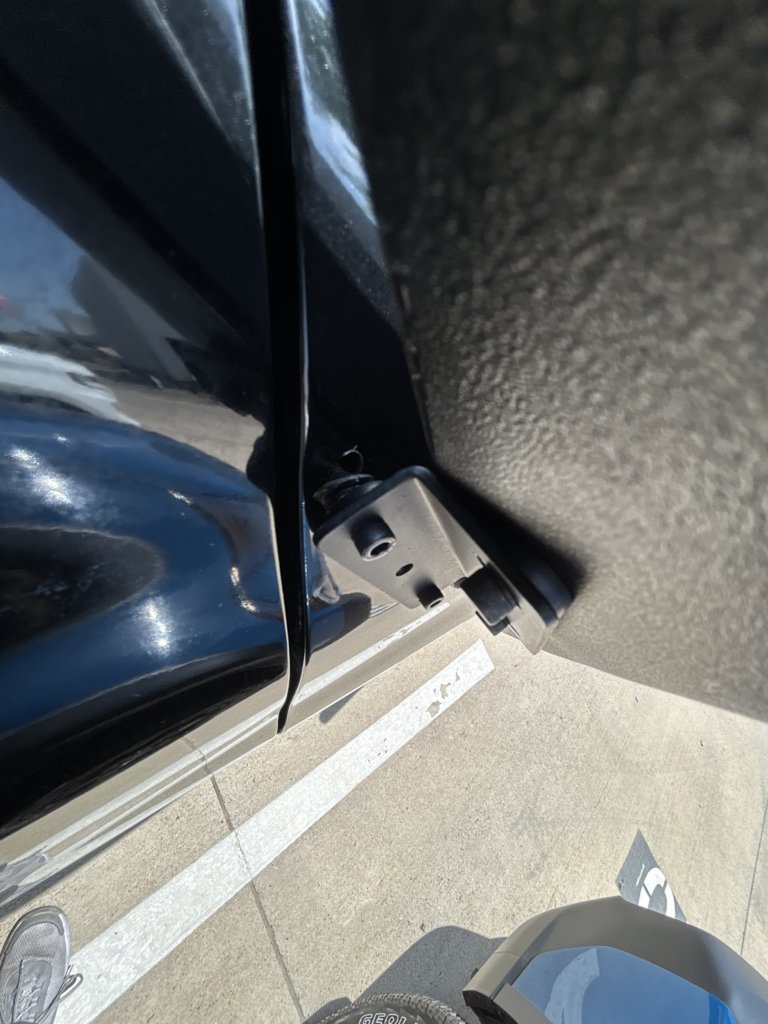

    So, here’s the deal… When I first installed my snorkel, I kind of did it half assed. Yes, I did attach it to the airbox so it’s been drawing air and has been watertight this entire time (before you ask).
    Because this design is for a LC and not for our trucks, it requires a little massaging to get it right. (I now understand why the guy in the video took his fender off to do the job the first time)
    There are five studs on the backside of the snorkel base that attach to washers and nuts on the backside of the fender. I was only ever able to get 4 of those to attach. The stud furthest to the rear never had a nut on it and I was never able to get a washer on to the stud farthest forward. This is something that only I knew about and has always bothered me since install.
    After taking the heat gun to the snorkel and since it has been on long enough to have molded itself somewhat to the fender from the weather, I felt that it was now time to attempt to secure it properly.
    Fender liner off, apply pressure to the area where the studs are. Attach washers and lock nuts accordingly. Tighten to enough arm strength to feel that it’s secure and not to rip out the studs on the snorkel base.
    Job done!
    I don’t know that any damage would have ever been done had I left it the way that it was. But for my own piece of mind, I know that it’s as secure as possible now.
    While I was at it, I figured I would ratchet strap the snorkel closer to the A pillar (again) and take the heat gun to it to see if I could mold it any closer. I believe now that this is the final product.

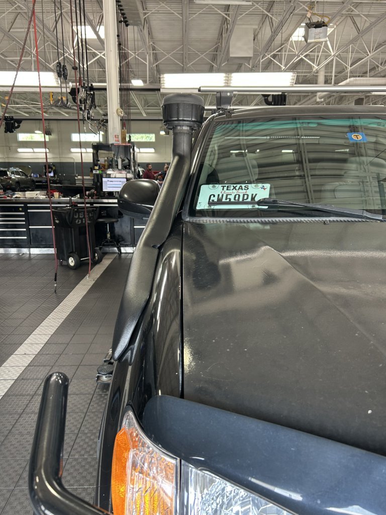

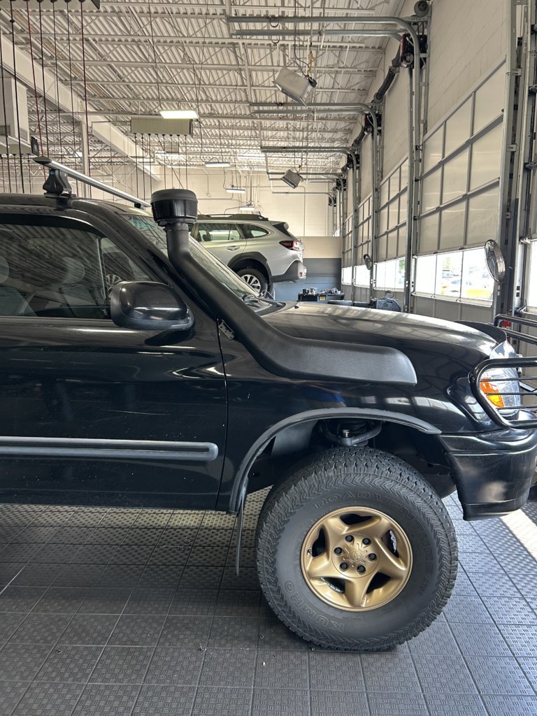

    Here’s the before and after shots with the heat gun

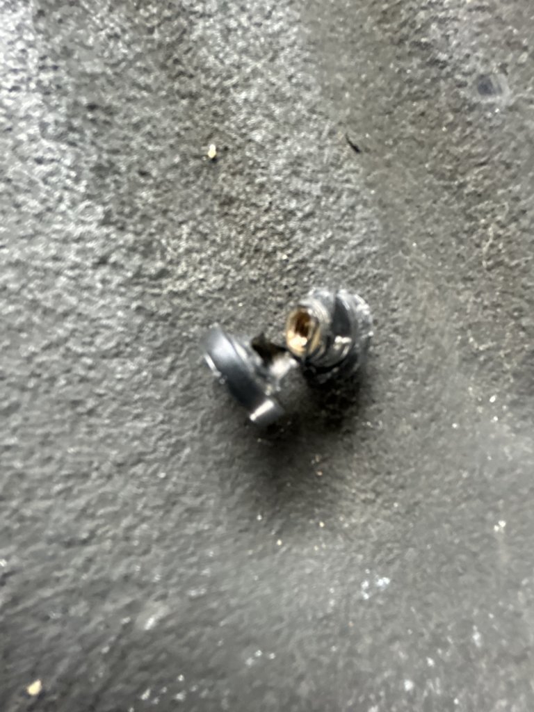

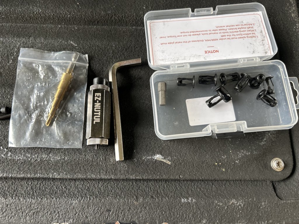

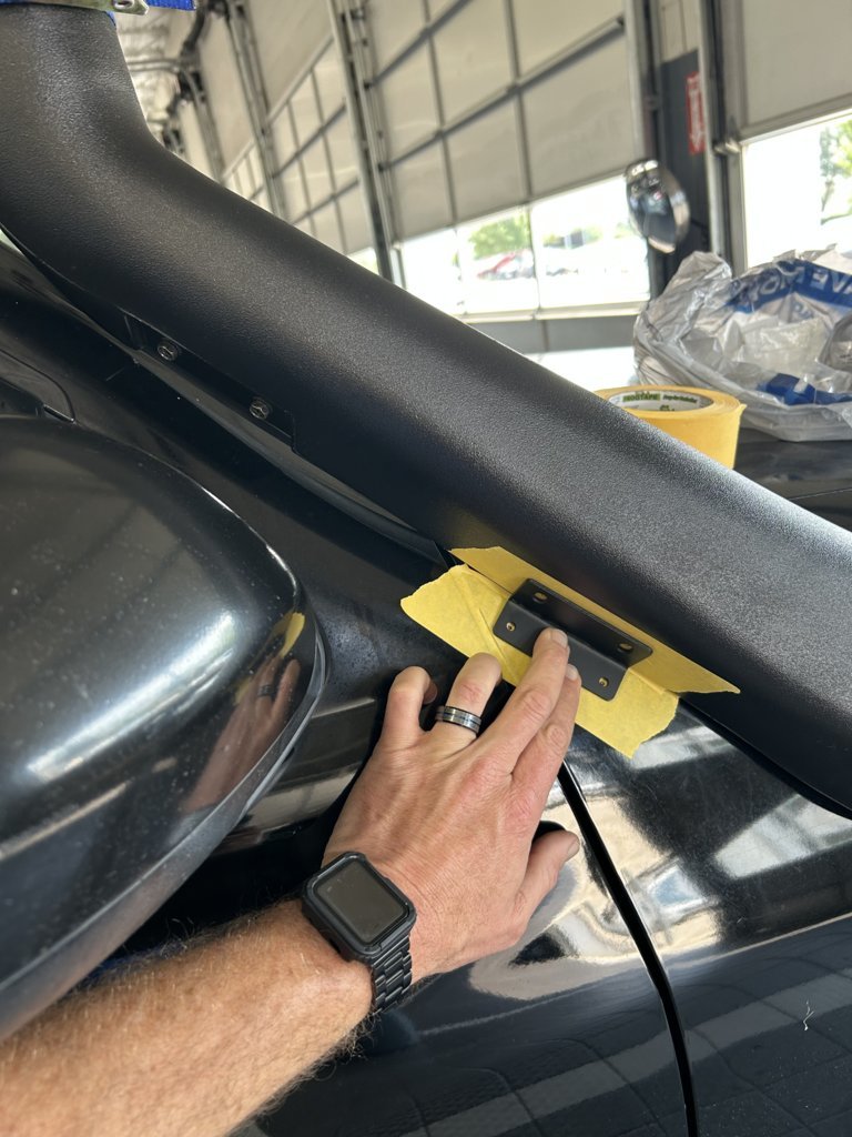

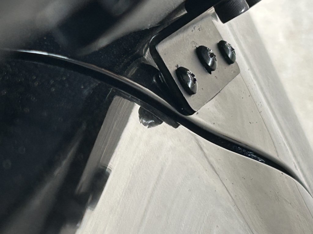

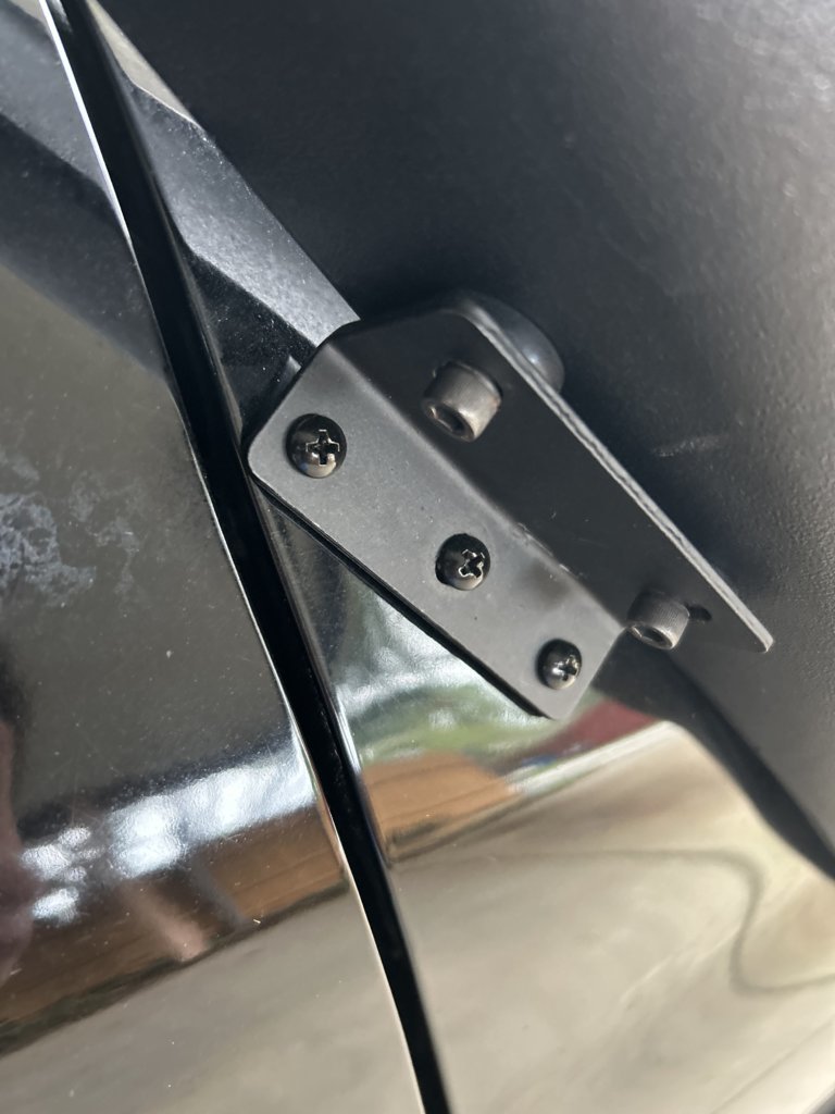

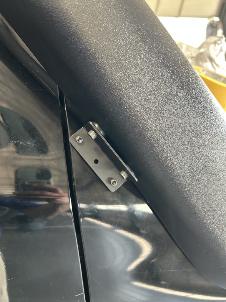

    UPDATE: The well nuts that I sealed and attached the snorkel head itself are holding great. The well nuts I used to hold the snorkel head to the fender pulled out after about 6 miles.
    I replaced those with jack nuts and also used the middle hole this time. If 2 wouldn’t hold it 3 never would.
    1 week and 60 miles later, they are still good

    Is a rivnut not the right thing there? Or is the frame too thin?

    I thought of using rivnuts. That would have been option 3 if the jacknuts would have failed.

    makes sense. I’ve used rivnuts on my kids bikes. Had to go with aluminum ones for carbon frames.
