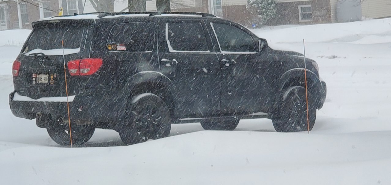

  15. Feb 4, 2022 at 6:07 AM
    Adamdsgn
    Adamdsgn [OP] New Member
    Jul 2, 2020
    #48773
    178
    2018 Toyota Sequoia
    I tried avoiding the platinum as well, but combing the US for a reasonably priced 2018+ Limited, white, 4wd, 2nd row captains chairs and lowish mileage was tougher than bagging a unicorn in the wild.
    Would have much rather had a limited. I do love all the bells and whistles of the platinum. I just wish the rear suspension would have matched the Limited with an addition of air bags from the factory. Also, the dial for adjusting the shocks... completely pointless.
  16. Feb 4, 2022 at 6:13 AM
    e30cabrio
    Oct 20, 2017
    #10410
    4,796
    West Valley, Phoenix, Az.
    Boosted 2013 Sequoia TRD FAUX
    Took me almost 6 months to find my 4x captain's chairs Limited. I lived your pain.
    I'm doing the bags now.
    SprinterAE86 likes this.
  17. Feb 4, 2022 at 6:34 AM
    SprinterAE86
    SprinterAE86 New Member
    May 19, 2018
    #15447
    1,065
    Ian
    Charlottetown, PE, Canada
    2012 Toyota Sequoia Platinum
    Bilstein 5100 2.3/1.5, TRD sway bars ft/rr, Cooper Tires Discoverer AT3 XLT 295.70.18, Vision Manx 2 18x9 +12, APS side armor steps, TRD-Pro Grill and Bulge, de-chromed, blackout emblems, OEM mirror caps and flares, TRD shift knob, Leather wrapped steering wheel, All weather mats
    Unfortunately, I needed a vehicle that can tow my camper up to Canada after selling my Tundra during the pandemic. This is what was available that was close enough for them to deliver it to my home.
  18. Feb 4, 2022 at 6:39 AM
    SprinterAE86
    May 19, 2018
    #15447
    1,065
    Ian
    This is the max adjustment on oem wheels.
    S. Equoia and e30cabrio like this.
