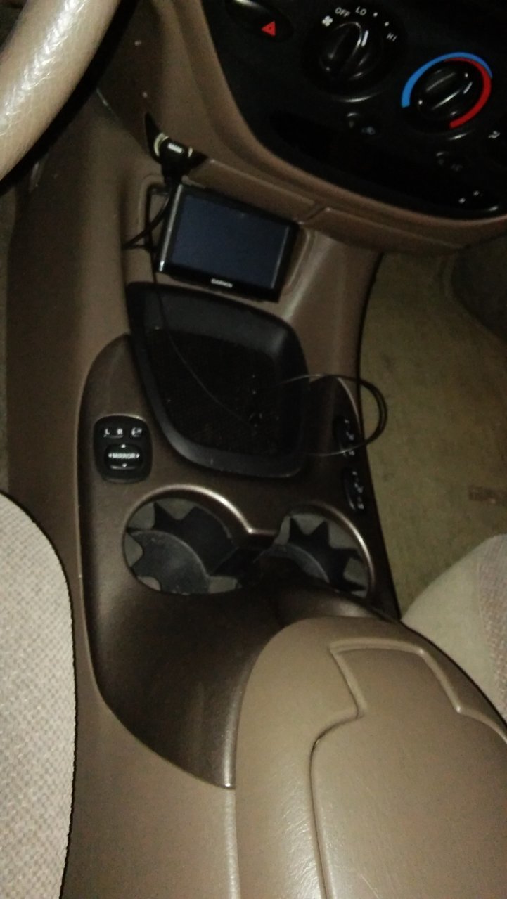

    There's a local guy parting out an 04 Sequoia with some good prices, contemplating trying to retrofit the center console and power seats into my 02. I found one old tundrasolutions thread about it but all the pics are dead. Any thoughts?
    Here's the console

    it physically fits. but im still trying to figure out the bracket situation. its likely not a true plug and play swap from what ive seen in my 05 reg cab

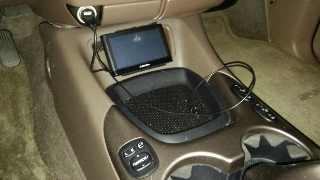

    I did it...Found a console from an 04 sequoia and replaced the small console in my 01 SR5. Found the brackets on line. The rear bracket went in like a champ but the front didn't. The carpet was covering where the mounting holes would be. I didn't cut the carpet to find out if the holes were there but its solid with the rear mount

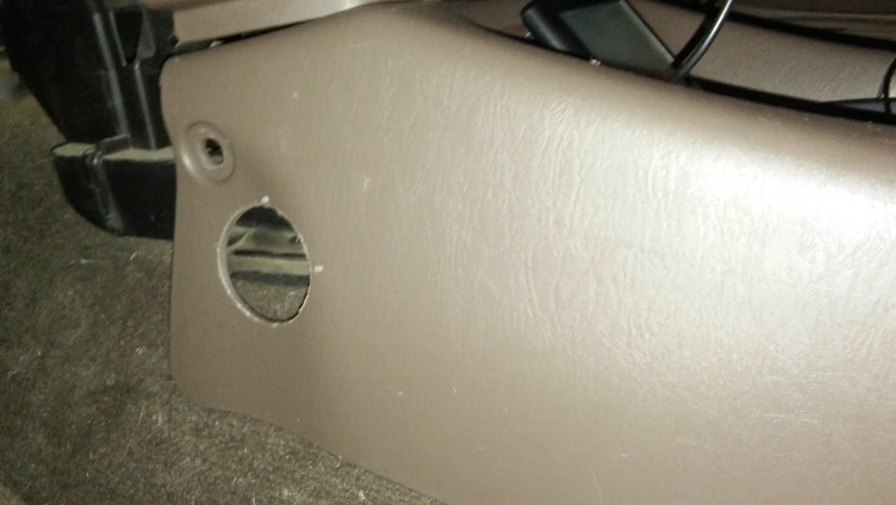

    Here ya go...I made a hole for the floor vents up front. Thought about small speaker covers but found they restricted the air flow.
