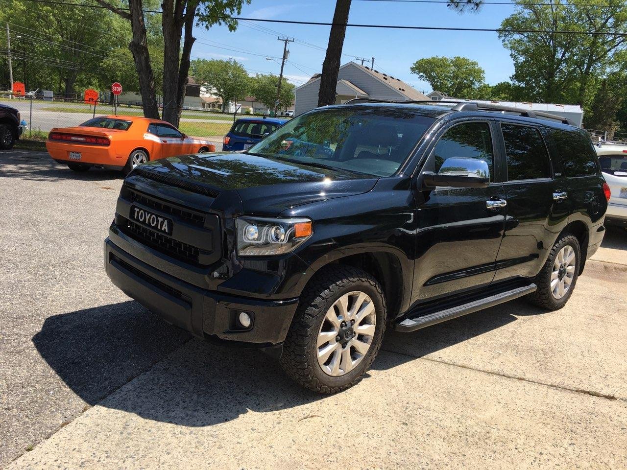

    @SequoiaGuy , Hi. I bought the whole front clip of a tundra. I understand the core support and aprons are the same as the Sequoia. Hood struts had to change and there were two small brackets on the top of each apron that need to be welded onto the Sequoia aprons to receive the tundra fenders. Other than that, you'll need to do some electrical work to get your headlights working. Hopefully that helps.
