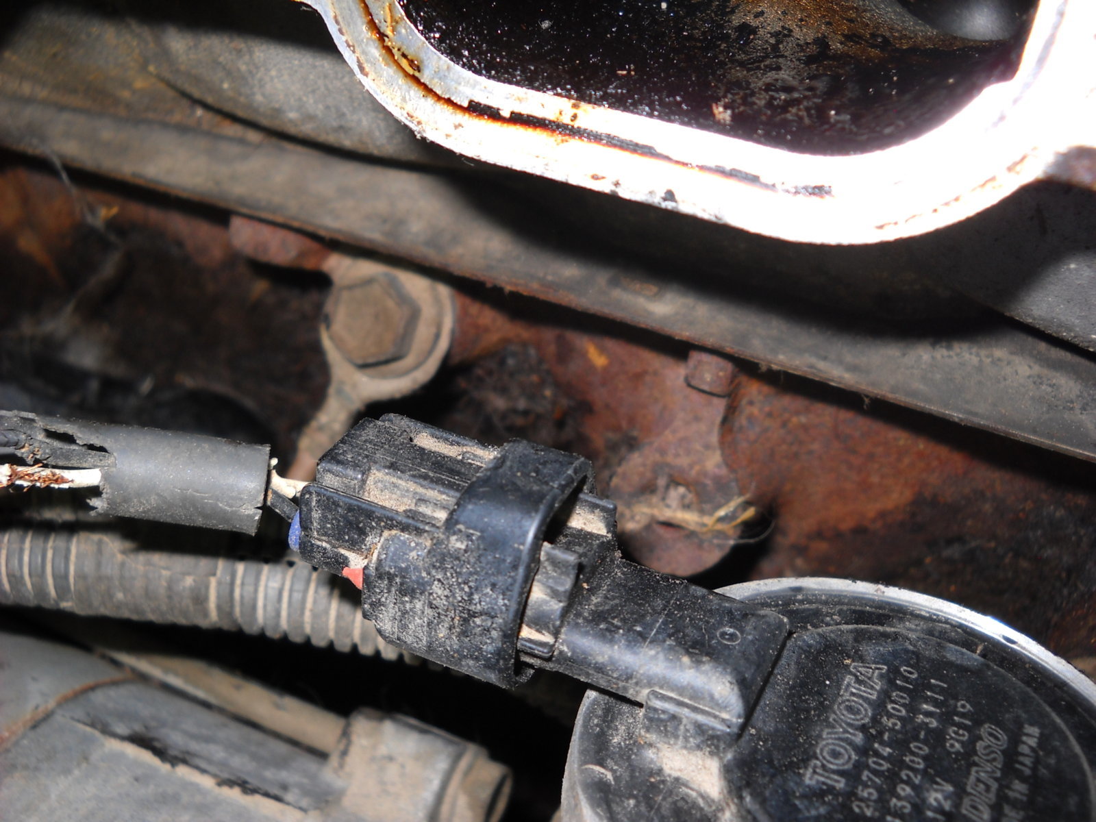

    I called Hewitt and told them the details. They told me to pull the intake to check the wires. Sure enough a rodent had chewed up the wires.

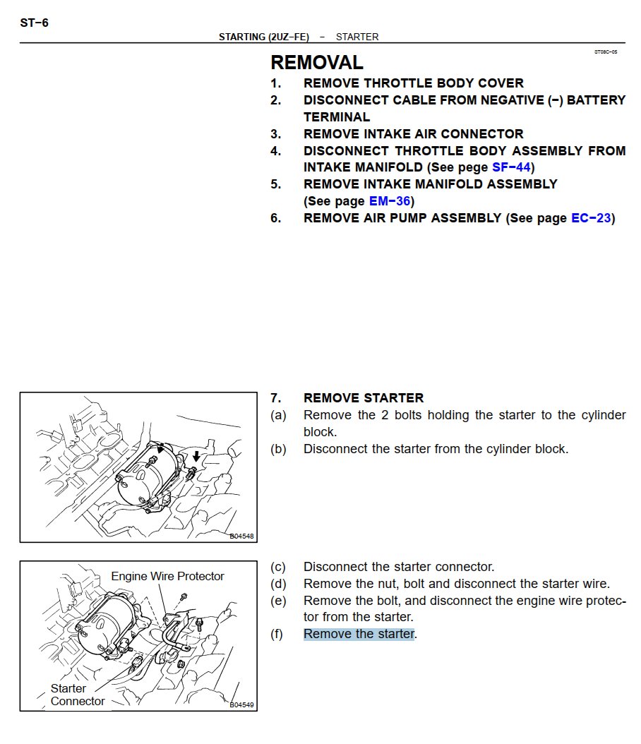

    I'm confused, why do you need to remove the SAI pump to remove the starter?

    And yes, though, I see it shows doing it in the FSM (step 6), but I'm not seeing why it's necessary based on the pic. I would consult the YouTube University to see someone else do the work in a couple videos to deem why/what you'd need to remove.

    I'm the one that's confused. Maybe I don't need to remove that stuff. I imagine those hoses would crumble if I touched them and they want about $50 for the pair.

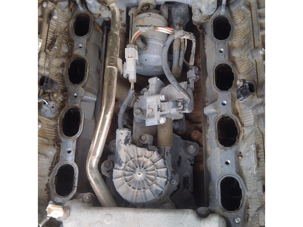

    This is ridiculous. I ordered intake gaskets for my 2006 4.7 from Toyota Parts Express and finally got them 10 days later and what did they send? One bank. How can you replace one side intake gasket? They apparently sell them separately. You can't fix stupid. Now I have to wait another 10 days and pay shipping again.

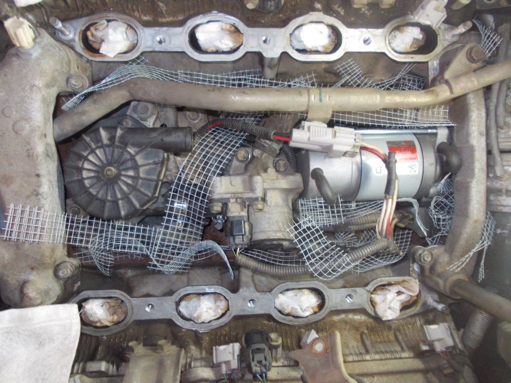

    I found the gnawed wires and soldered them. I bought a factory rebuilt 2KW starter and put the intake back on. As you see in the pic, the 2KW cold weather starter is longer. To make the valley less hospitable to Norway Rats, I made some land mines out of 1/4" hardware cloth, cut into strips and twisted. Now they can chew wires that are easier to get to.
    Getting the SAIS check valves out was easier than I thought, the flange bolts were not siezed in the aluminum. I also replaced the O ring on the water tube while I was in there.
