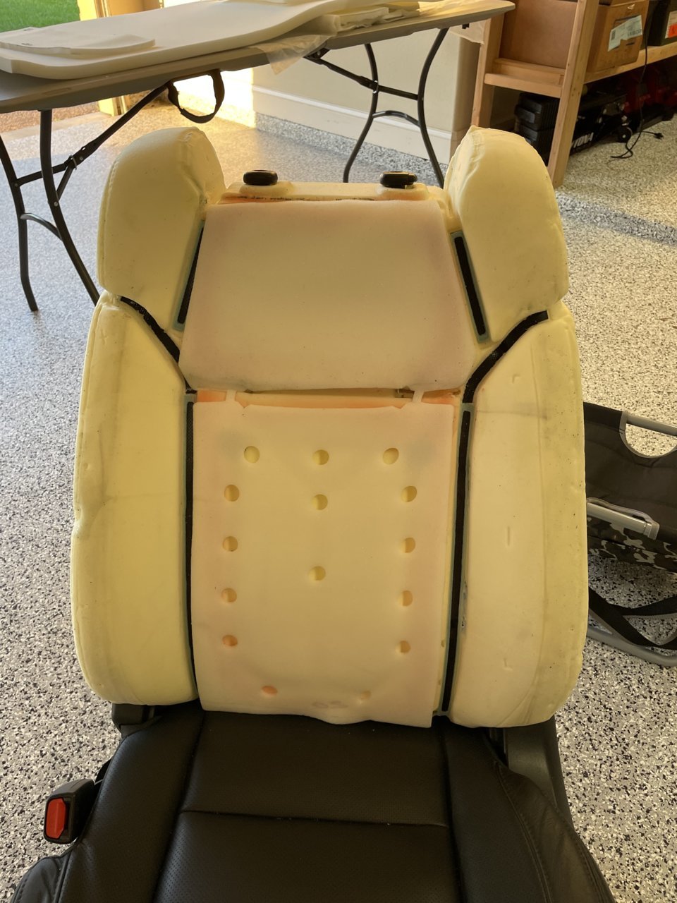

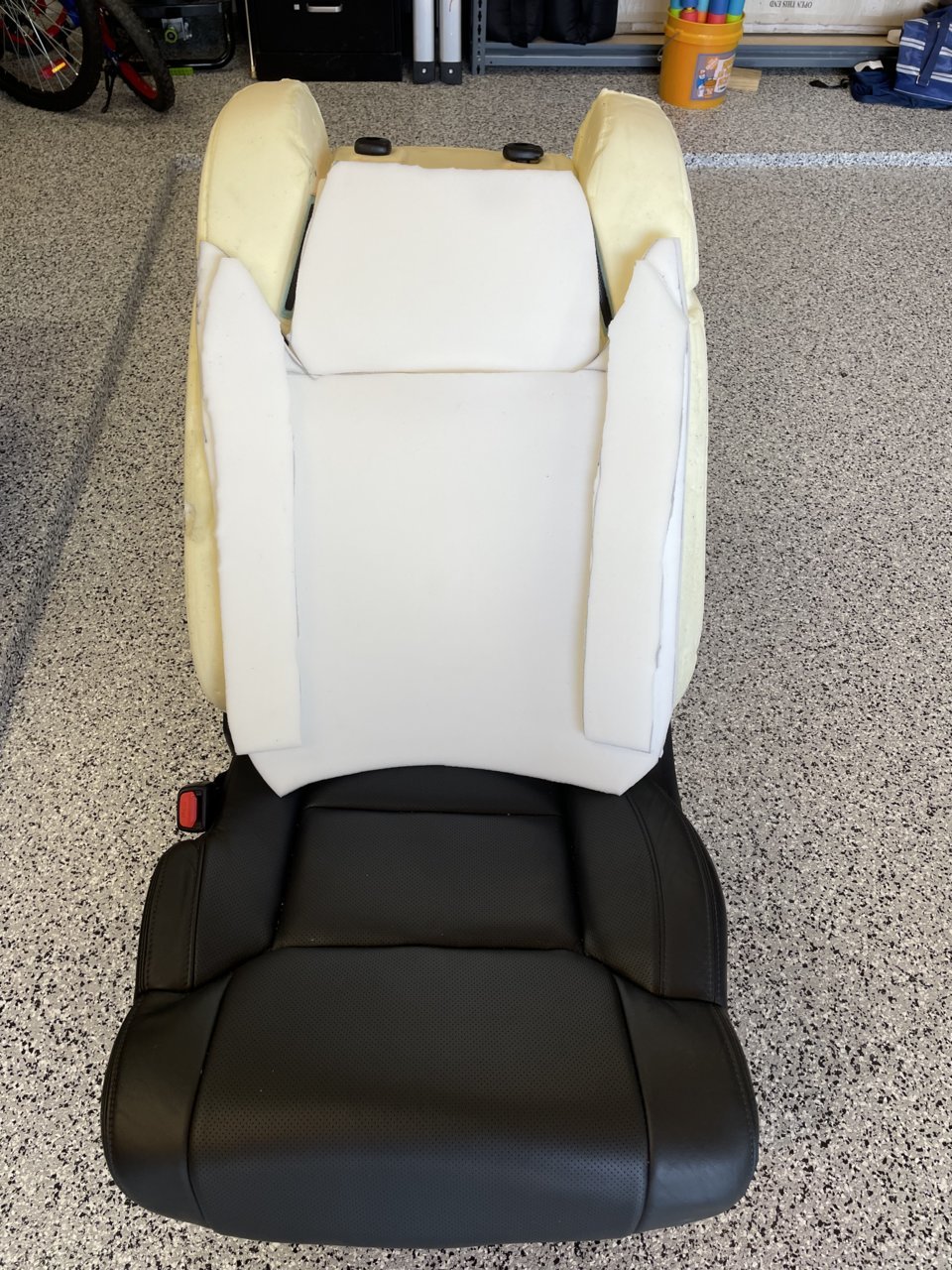

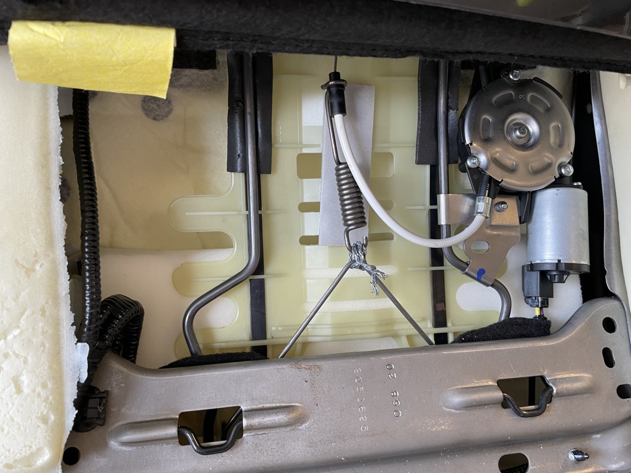

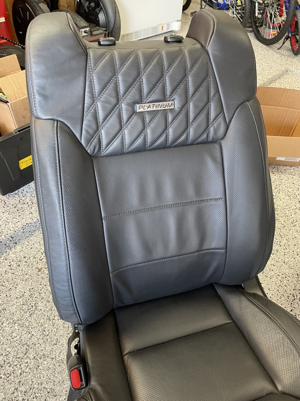

    After having my drivers seat apart MANY times, I think I finally found a technique that will give me some comfort. I bought a huge sheet of 0.5” foam off Amazon and cut it to cover the entire front of the seat. Then I cut two additional strips to build up the side bolsters some more. Now I don’t slide around in the seat and don’t feel like I’m always leaning in toward the middle. Oh, I also added a small little loop of picture frame wire to the lumber adjustment spring, which allows the lumbar support to be more flat in the most relaxed position.
    4F9E0D5B-A8E9-44E6-B01B-48B2D0C8AA75.jpg 5BEFFA16-C8D5-4B97-9B02-088A6255916A.jpg 9F143420-F258-4B6B-A130-D7150DC82585.jpg

    Dedicated work and looks much more comfy!

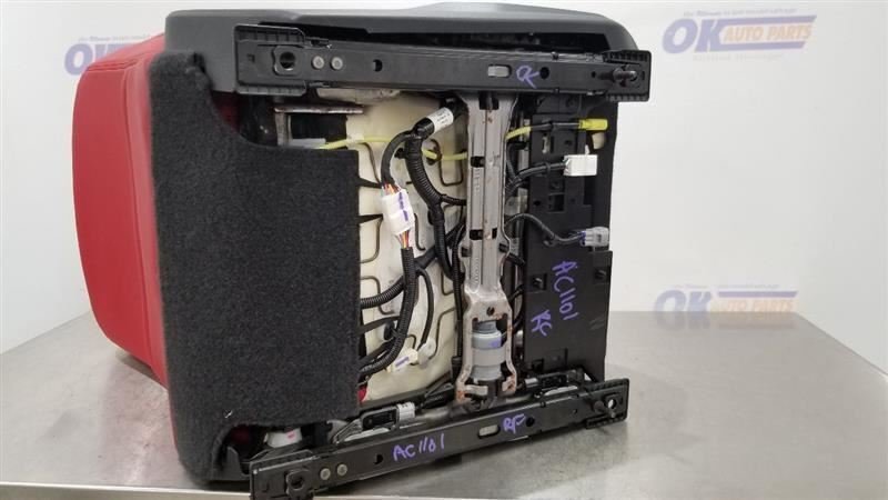

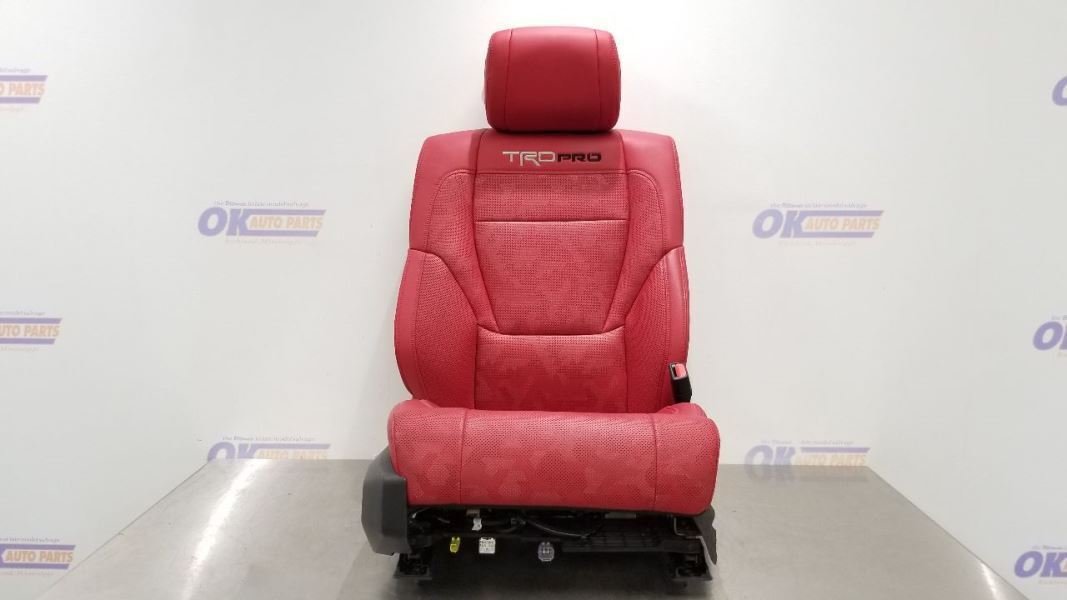

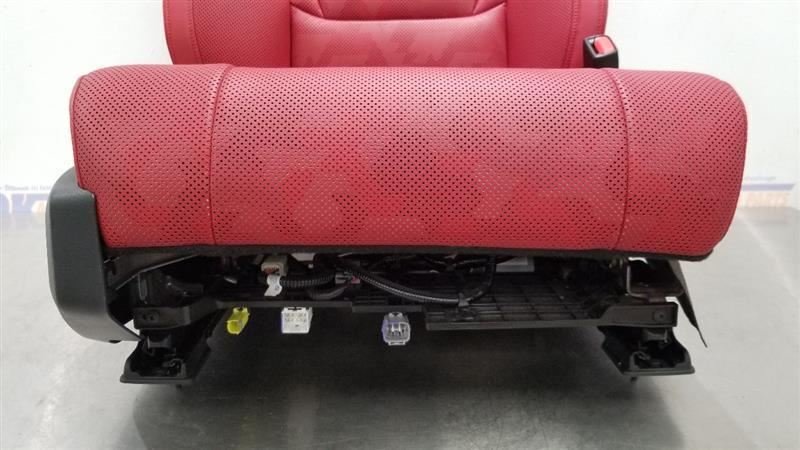

    Bumping this. Anyone thought of putting 3rd gen seats in a 2nd gen?

    Hmmmm! Would it be a direct drop-in? Both from a mounting and an electrical standpoint? If not, not worth it.

    Here are a few pictures from some TRD PRO seats I found on ebay. I've never taken my seats out so I'm not sure how they mount but maybe these pictures can help if someone if more familiar with the process11.jpg 22.jpg s-l1600.jpg

    I guess another question would be if the 3rd gen seats are any better than the 2nd gen. I've never sat in one. They could still be the same seats for all I know.

    I'm going to bet money they won't drop in. Different cab dimensions, different seat frame dimensions.
