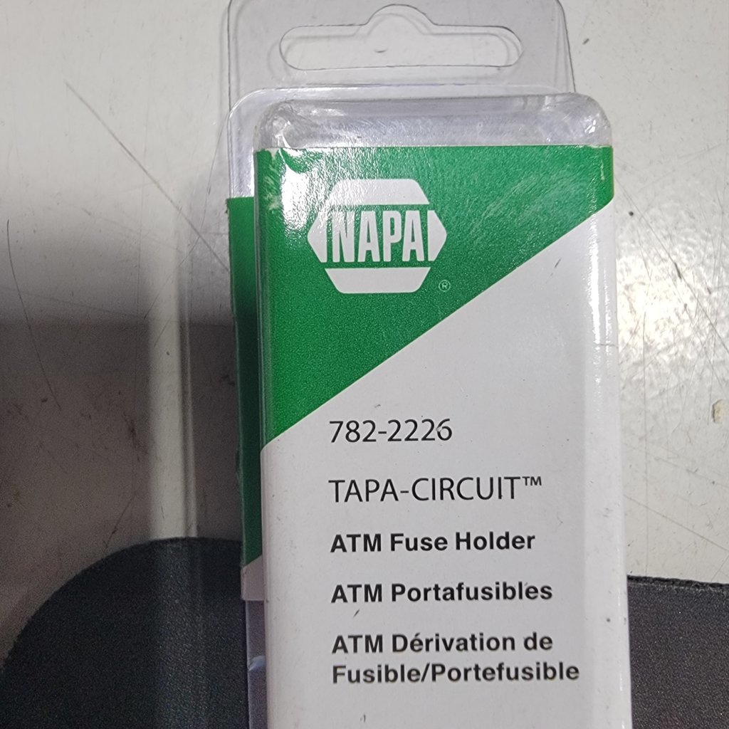

    I use these adding fans, blue safety lamps on fork trucks. These work perfectly as to not splice into factory wiring.
    Don't bother trying to find a (wire) in the cab, can-bus is no fun to mess with or F up.either.
