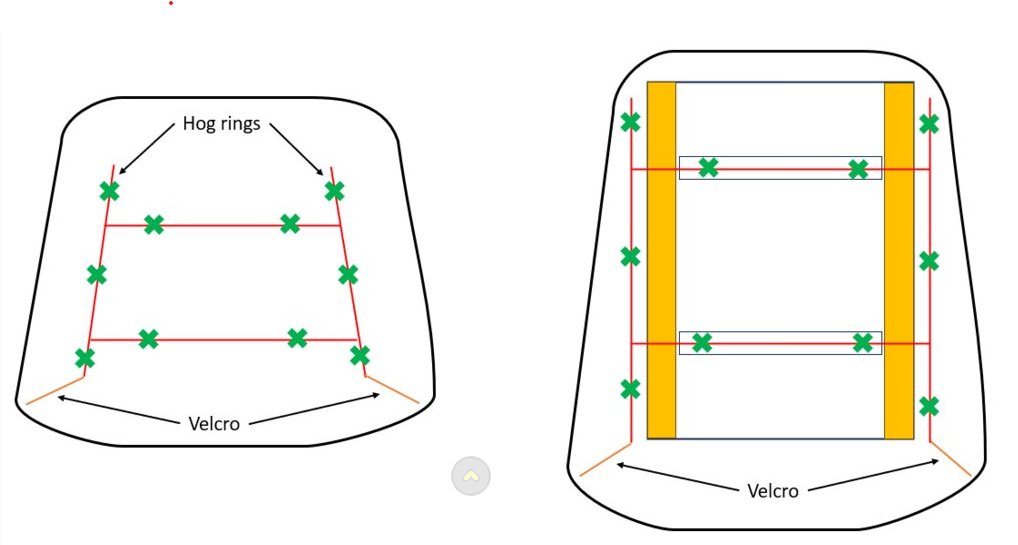

    2) The heating pads require some trimming and I was a little confused at first because the way you have to trim them to work (at least in my 2021 seats) sort of contradicts the instructions. Their video instructions say to lay them out flat and mark the center of the listing(learned that's the term for the valleys in the seat foam), and then cut windows, which doesn't work. The paper instructions say to lay the heating pads out and fold them into the listing to trace windows, but that the heating pads shouldn't be folded into the listing. Without folding them into the listing they won't fit. I did sort of both, I folded the pads into the listing, marked where the hog rings attach, and then cut a "max 7/8"" wide window that goes from the inner edges of the adhesive on both sides. The tricky bit is that to make the pads fit, and to be able to reattach your hog rings, you have to have the adhesive part folded into the listing.
    The seat bottoms with covers removed from a top down perspective look like this:
    The red lines are where the listing is. Embedded in the seat foam in the listing valleys are little wooden dowels, and then on the seat cover there are metal rods that run more or less the length of the red lines above. The seat heating pads are narrower than the vertical listing, but wider than the heating pads, which means you have to put the listing rods over top of the heating pads. The inner rectangles above are the "windows" you have to cut out so that the listing rods can attach to the listing dowels. If DIY'ing, I'd try not to detach the velcro at the front corners of the seat. I put one of my covers back on and I'd say it looked ~85% as good as before I took it off after a lot of trial and error with the hog rings, but I ended up taking my seats to a local auto upholsterer to have him put the covers back on to get them factory snug. He charged me $80 per seat to put the covers back on.

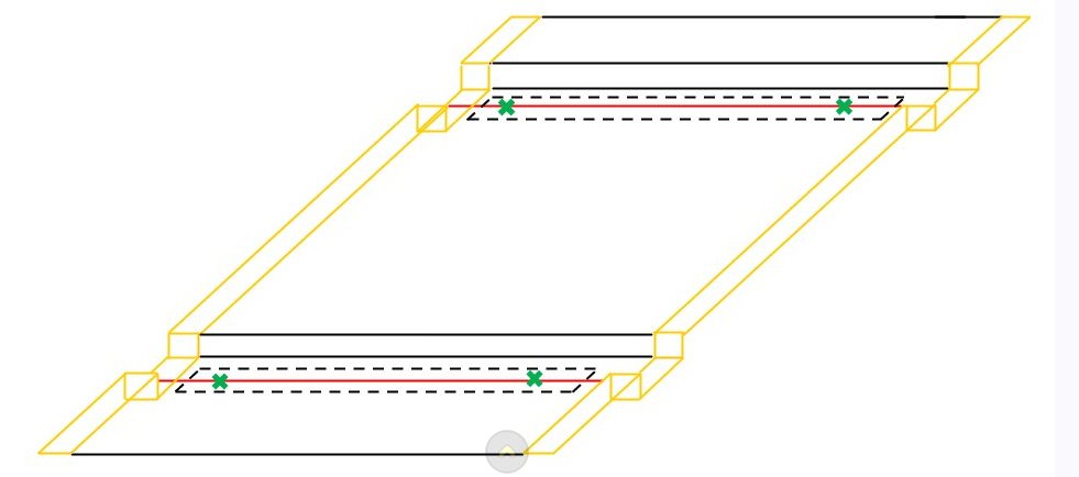

    From a 3/4 perspective to try and illustrate how the pads have to fold down into the listing valleys, the heating pads look sort of like this:
    The yellow lines are the adhesive strips along the edges of the heating pads, the dashed lines are the "windows" you have to cut out, red lines are the listing dowels, green x's hog ring attachment points like above (not showing the vertical listing/hog rings). Kind of hard to illustrate how the listing rods are wider than the windows you cut out/they're more or less the same width as the heating pads.

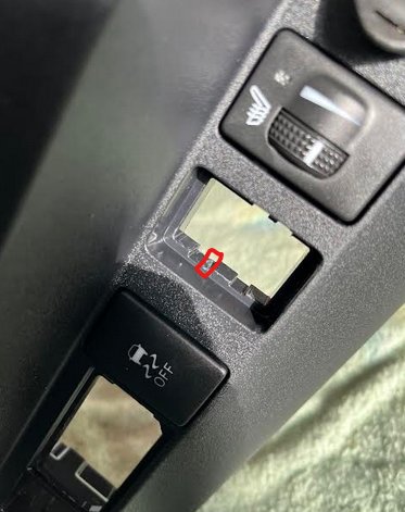

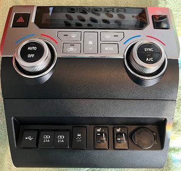

    5) Installing the switches. I had 2 open slots on my panel under the AC controls. One switch fit perfectly, the other I had to notch a little bit of plastic circled below for it to fit correctly
    Switches installed look like this:

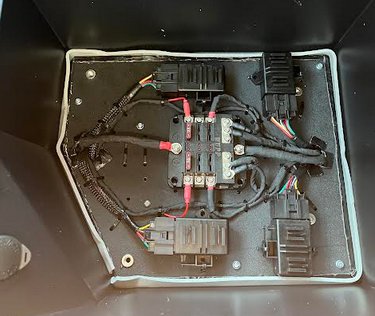

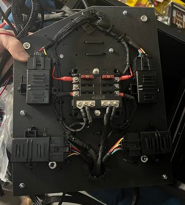

    6) This next whole part is optional. If you want an easily accessible interior accessory fuse panel, this is a good option imo. If you just want to do the seats, you can bundle all the wires/relays and find somewhere in the dash to secure them. Remove the center console, 4 bolts inside under the carpet, 2 screws attach it to shifter column trim area. Run your 8 gauge power from battery, through driver side grommet, and route to center console area. Plenty of videos on Youtube for this. I used some scrap HDPE to remake my fuse holder panel in the engine bay, 4x6" panel to mount both my fuse holders to (larger wire is for audio system).

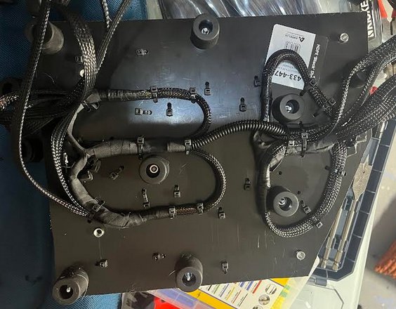

    7) Take the carpet out of the center console, trace it onto your HDPE, and cut two panels of the same size. Measure/mark where the center console bottom bolts go, and then drill 9mm holes on the 4 corners of your two HDPE panels sandwiched together so the holes line up. Insert m6 rivnuts into the 4 corner holes on one panel. Lay your "bottom" panel with rivunts into the center console. Use a step bit to drill out ~1" holes through the HDPE panel and bottom of your center console to pass wires through in front (and back only if doing rear heated seats too). Mount your fuse panel, and relays to the panel. Route you wires, secure everything. Should end up looking something like this from the top:

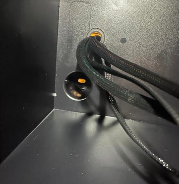

    You can see the 4 rivnuts on the corners that match up to where the center console as valleys where teh factory bolts go. I was lazy and didn't depin/shorten anything, so I ended up with weird slack underneath that I secured. I added rubber feet to keep the panel up off the bottom of the center console but if you trim the wires to length you wouldn't need to. Bottom side:

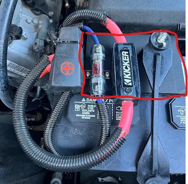

    8) From here, it's just routing your wires and making connections. On the panel above, my power comes in at the top of the panel, ground comes in at the bottom. The front seat wiring comes in on top, as well as the accessory circuit wires and the illumination wires. On the kit instructions, it's kind of confusing on which wire is which. The big red fused wire is your +12v power, the yellow wire is your illumination, the small red wire is the accessory wire, and black is ground. I routed the front seat switch plugs to the AC area along with the illumination wires. Continuing on from there I routed the accessory circuit wires along my power wire back to the interior fuse panel area. For illumination, I de-pinned and cut wire #5 on the flat black 8-pin connector after testing for illumination. @RainMan_PNW confirmed this is the illumination wire for the parking sonar switch which I don't have. If you do, you could instead t-tap this wire. I soldered all my switch illumination wires to it:

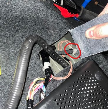

    I routed the ground wire out the back of the panel, to the factory amp ground point under the passenger seat here:
    I routed the connectors for the seat heaters under the carpet, coiled up the slack, and left enough sticking out from under the carpet to match the length of the existing factory wiring.
    Reinstall the center console, pull your power/ground up through it/your panel, bolt the center console back down using the factory 10mm bolts, trim the wires to length, crimp your lugs on (lug crimpers work easier than a hammer crimper for this), and attach your power/ground to the panel. Some more pics:
    I put some adhesive foam around the edge to stop rattling.

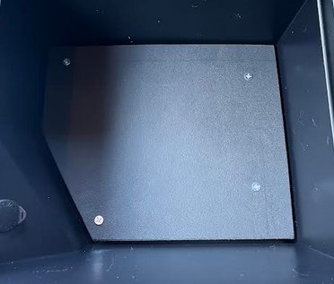

    Install your "top" panel using the 4 M6 60mm bolts:
    and then reinstall the carpet piece over top of everything. You've essentially got a false floor/switch panel sandwich.

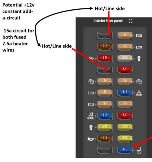

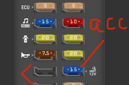

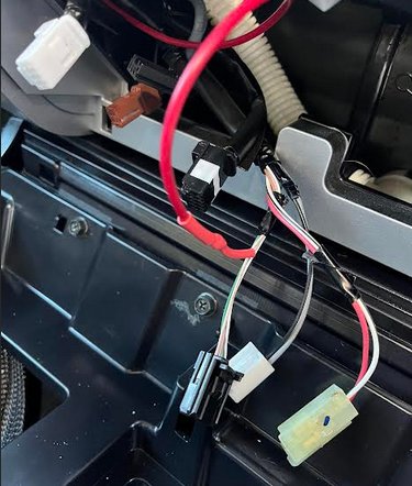

    EDIT: I realized in retesting things that the Cig. No 2 circuit is constant. Connecting the accessory wires to this circuit drained my battery. I ended up using a test light to re-check things and found a couple empty ignition fuse slots.
    Be sure to orient your add-a-circuit correctly, on my truck the "hot"/line sides are like this:

    Got the rear seat heaters installed. The process was more or less the same as the front seats but the covers are a little trickier. I ended up cutting all the hog rings I could reach and peeled the covers back just far enough to install the heating elements. Had local upholstery shop reinstall the covers as they do a much better job than I can lol, found out from the wife’s car leather seat covers are much easier to reinstall than cloth.
    The good stuff, 3 switch panel courtesy of @RainMan_PNW. I cut the plug off the cig lighter wires and installed a dual type-c outlet using deutsch connectors. Here’s the switches and outlet lit up:
    As for the switches, if you install them in the rear of the center console and route the wire harnesses straight back from the center console along the trans tunnel you’d be able to reach to underneath both seats. I wasn’t comfortable with that and having people stepping on the wire harnesses all the time even though they’d be under the carpet and padding. I routed to the passenger side, under the rear passenger door sill and popped out by the passenger side c-pillar. I had to make an extension harness for each seat to reach the seats.
