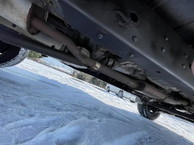

    Hello, I am new here and currently searching for my 1st Tundra ever! I came across shifty's post and it was incredibly helpful. I'm using that along with the other posts here re:frame rust and the Early 1st gen FAQ to help in my search. I checked out my 1st Tundra today and will look at another tomorrow. I am still learning how to recognize if a frame is in decent shape or not. Living in the DC area, we get a lot of salt. A good frame (along with the other factors in the guide above) will be my ultimate deciding factor in purchasing.
    These attached pictures are from a dealer about an hour away from me that they sent to me today. I plan on going to get a closer look tomorrow and hammer around to check integrity, but could still use some input.
    Its a 2005 DC SR5 4.7V8 4WD. It came from Kentucky and is now at the dealer in VA. Per Toyota service records, it was coated at 45k miles(currently at 134k). Appreciate all and any input/advice.

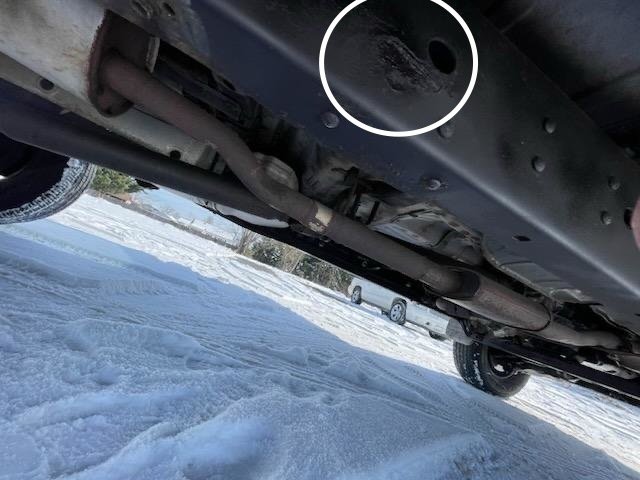

    Be very careful with this one. Clearly there is some concerning degradation of the metal due to rust since the dealer sprayed over everything to not make you look closer.
    If you really want to go there, tell them you’re bringing a creeper so you can look underneath in great detail. Also take a small hammer or screwdriver you can use to test the strength of the metal.

    Meh. Some questionable spots on there. Body mount areas, spring bucket etc. The spare tire brace and rear frame overlap stiffening braces are the real fail points. Also front frame rails under the firewall. That spacer lift and rear blocks with no bumpstops is a bummer too.

    Someone has obviously sprayed the frame to make it look black again, and it's fresh which makes it suspicious as fuck, and sadly it makes it more difficult to see what's going on with it.
    All of the above makes me leery, I'd want to really get under it to figure out why someone would want to freshly spray the frame. And I'd ask them about it too, and see if they give you an honest answer, "So the frame looks freshly painted, any reason why you chose to paint right before selling?"
    The answer may tell you what you need to know.
    I don't see anything scary in those photos, but I also don't see half of the areas I'd be worried about.

    Definitely look at the parts he mentions; if you aren't sure what those are just search this site, there will be other "is this frame ok" threads with photos. One other thing guys have issues with on rust buckets, fuel tank straps--those seem to look okay from what photos show. If you can get an engine bay photo that's always nice. Also look inside the skid plate to see what the underside of the motor looks like.

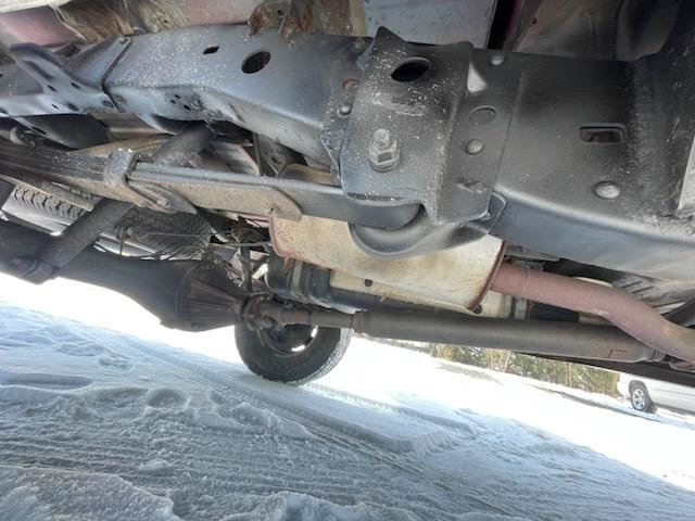

    Man, check the frame below the brake booster and master cylinder also, where it upturns on the driver side leading up to the fender. Seems they love to crack in half between the upper control arm bolt and the firewall. I think I linked a pic to an example in the megathread.

    Yeah that exact part is what caught my eye and gave me pause when I first looked at the pictures. The Tundra I checked out today, had several spots similar and what drove me away especially because the black bumpy surface just kind of flaked off when hitting it revealing a bit of rust underneath (maybe just surface rust since it wasnt too soft?). But I'm having trouble differentiating between what spots may have been coated by Toyota and what is just sprayed on by the dealer--specifically when I don't see any noticeable overspray or if it's not shinier sheen of paint

    If it’s flaking of metal, it’s more than just surface rust. It’s actually starting to delaminate. A good frame even with surface rust should be relatively smooth.
    If you’re talking about the frame treatment spray Toyota did, that will be fairly obviously when you see it. More of a bumpy black coating when you look at it.

    ! hour drive? Go check it out in person. Take a ball peen hammer and a screwdriver and check it everywhere. It's not bad enough to walk away sight unseen, but caveat emptor.
