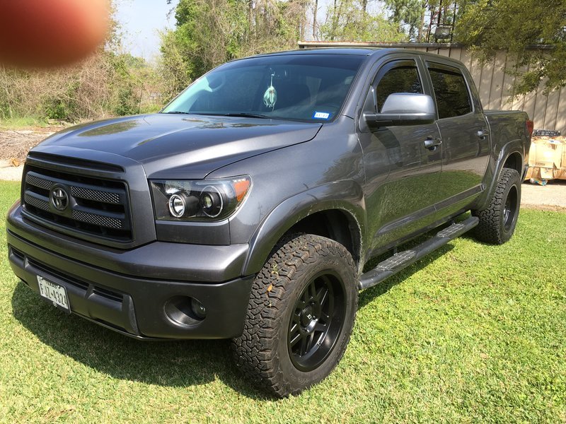

    Just installed the SCS Stealth 6 wheels. 20x9 with +12 offset wrapped in 285/65/R20 BF Goodrich T/A KO2. Had to trim the front fender plastic splash guards and trim the frame because of rubbing when turning. I took off my 1.25" wheel spacers when I first put the wheels on and the wheels didn't stick out as much as I wanted so I put the spacers back on. I like how it turned out. I would like to give a shout out to Vin at SCSPerformance for helping me with ordering these wheels. Had her washed last night but I guess I hit a few puddles this morning haha.

    Those are the best looking black wheels made for the tundra, in my opinion.

    VERY nice!!!! Ya those might be the best looking wheels for the tundra.

    Trimmed the frame? Ummmmm...wut?

    It looks great but Im also wondering what you meant by trimming the frame?

    Assume he meant cab mount chop.

    Haha i yall know what i mean had to cut the body mount a little near where the front mud flaps were to avoid rubbing.
