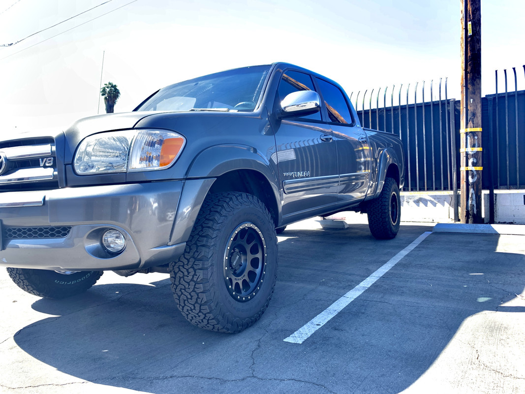

    Hey,
    I did a lot of research to find someone running this setup on Instagram with the same truck/color as me. I really wanted these rims but they are always sold out. I went with Method 305nv with the updated cap on 285 ko2's. I say go with 17's to clear the breaks.
    Below is the link to the guys IG running these, im sure you can DM him and ask questions.
    https://www.instagram.com/lukebarnhart26/

    @jerryallday nice looking rig! Are those 17x9? Offset?

    17x8.5 | 6x5.5 | 0 off set /4.75" backspace
    I also just ordered spidertrax 1.25 spacers
