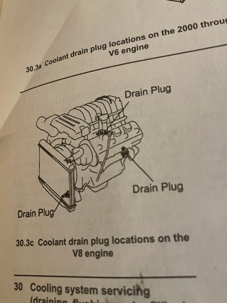

    Thanks to bfunke, shifty, and others for the tips. Very straightforward. Most difficult part was locating the coolant drain plugs in the block. My Haynes manual showed them at the locations indicated in the illustration. Not sure what they were smokin'.....must be a first edition. o_O

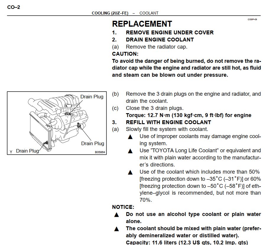

    Identical image to the FSM, so more like, "what Toyota was smokin'"
