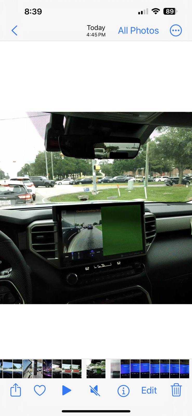

    Yesterday I saw there was a software update so I applied it. The update finished after a few minutes.
    Today when I turned on the cameras I noticed half the screen was green. I hit the camera button a few more times which resulted in… working, working, broke, working, broke, working, etc… I could still use touchscreen buttons “behind” the green. When broken, the green was always on the right half. The green only appeared when the cameras were active.
    Has everything there been any other reports of this? I see there is a recall for the camera system. Could this be related?

    I had that once, push the volume button in will cause a reboot or you can turn off the truck and back on should clear it up. Seek help from dealer if it continues.

    So I bought a Limited Sequoia Hybrid 4WD last week. Today, I had a similar issue like yours. My whole screen went completely green. Then, returned to normal. I am not sure what I pushed.
    Then, while driving. The cameras turned on display once the vehicle is below 10 miles/ hour. However, the entire right side of the screen turned GREEN. It is happening sporadically. What was the fix for your Tundra?

    Im having the same issue in mine. Took it to the dealer, they said it's most likely the camera. So that got replaced. Then couple days ago, same thing. Toyota is saying it's the parking assist ecu. Kinda strange its that. But lets see how that goes.

    This happened to me after an online software update. Every time the camera turned on at a stop half of the screen was blank, but not green. Turned the truck off, restarted it, and it went away. Hasn’t happened since.
