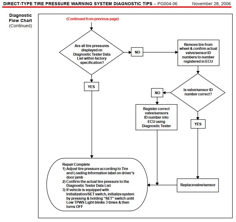

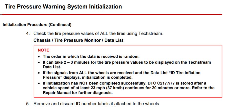

    C2177, I think, is flagging because you pushed the TPMS reset button under the dash but likely didn't complete the required drive cycle. This is taken from Toyota's NHTSA docs on that code, note all bullet points but pay attention to the last one - you pushed to reinitialize, i.e. reset all TPMS codes and data, but the vehicle didn't receive enough data to complete initialization within 20 minutes of driving at 23mph+
    Restart the initialization - i.e. start the truck and immediately hold the reset button on the dash until you see TPMS light flash 3 times. Then go drive around at speeds over 25mph for at least 20 minutes. See if that resolves the issues.
    I think what you've done here is, the shop installed new sensors, they programmed in the sensors, but either (A) they failed to know they needed to TPMS reset using the button, (B) you failed to drive around enough to allow registration to complete and sensors to initialize/send enough data, or (C) some combo thereof.

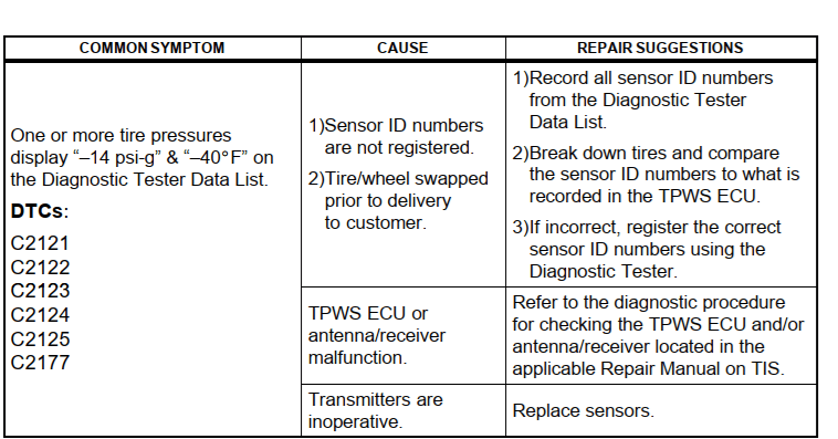

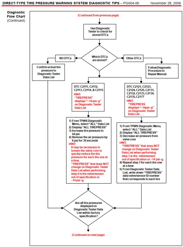

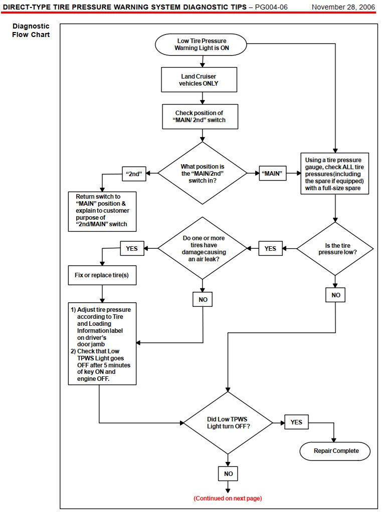

    I'm dropping some more info that may help from another Toyota TSB, and it also mentions the elusive "-14" on pressure output. Here's some snippets taken from their TSB PG0004-06 published back in 2006.
    First is Toyota's notes on cause/repair for codes C2177 you're seeing, along with C2121, C2122, C2123, C2124, C2125:
    But more important here is the diagnostic process they recommend to deal with TPMS errors of all types.

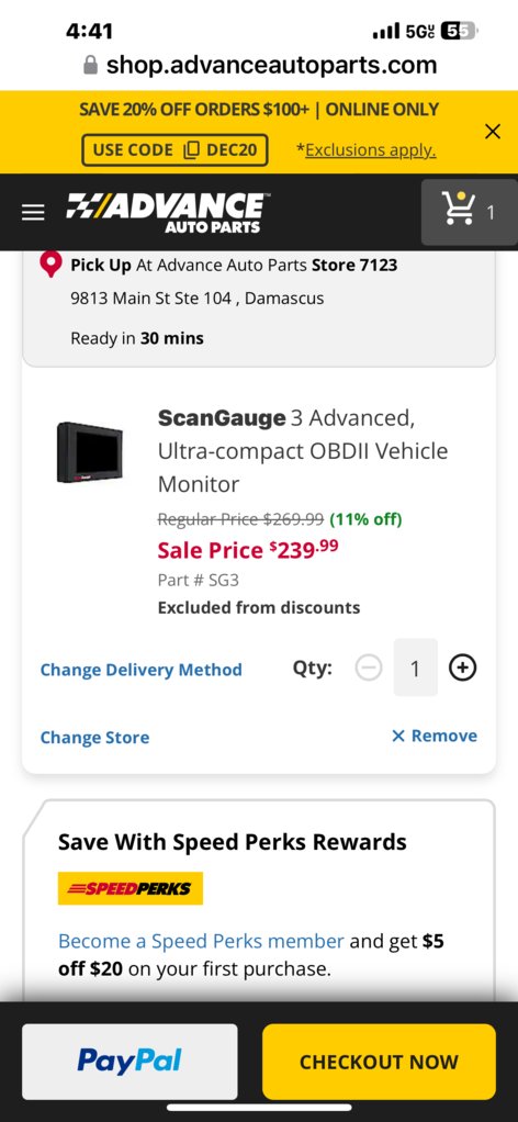

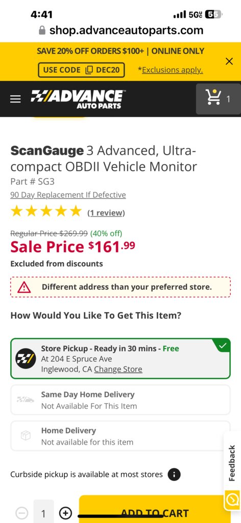

    I have been looking at scangauge 3’s for a bit…..was doing a search while waiting for a flight at the airport and saw this.
    Went to order and change stores to my local advance and got this:
    I suppose I could try to get my local store to price match and show them the website, but why the huge discrepancy in price from one store to another?

    interesting; I was able to search the surrounding stores closer to me and found one for $162!!!!
    SCRATCH THAT - order was canceled
    Edit - found one in a store 10 miles from me. Ordered it online and waited for them to cancel the order too. Got the email that said it was ready for pick up! I will get it tomorrow. $171
