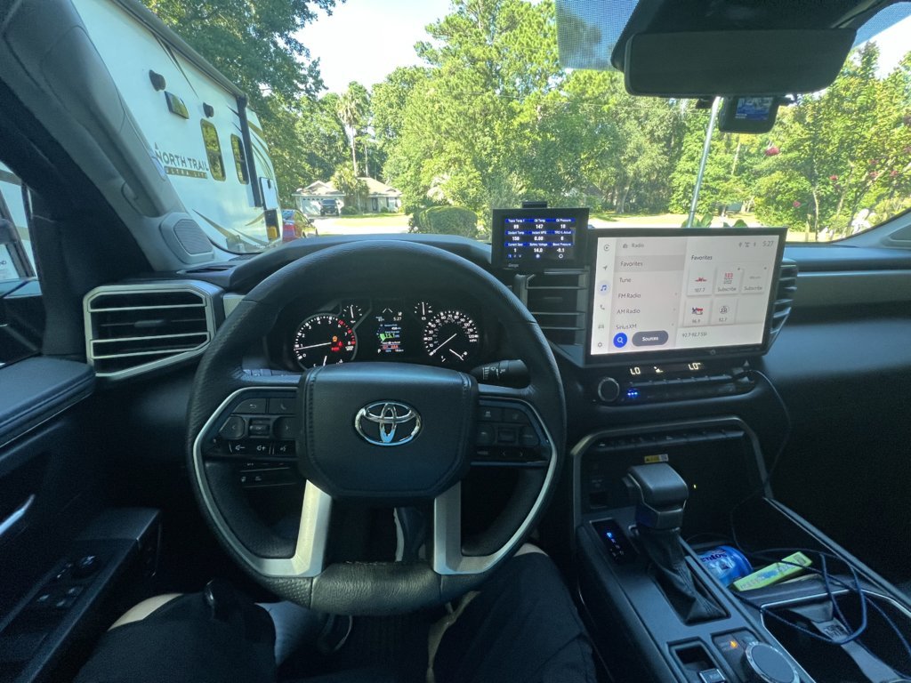

    Could be and my understanding of the discussion. Gen 3 absolutely has a numeric value available.
    Here is a picture of how I mounted the ScanGauge III in my truck. Oil pressure is top right. I really the SG3 for giving me 9 PID values on each of 3 pages to select and modify data displays on.

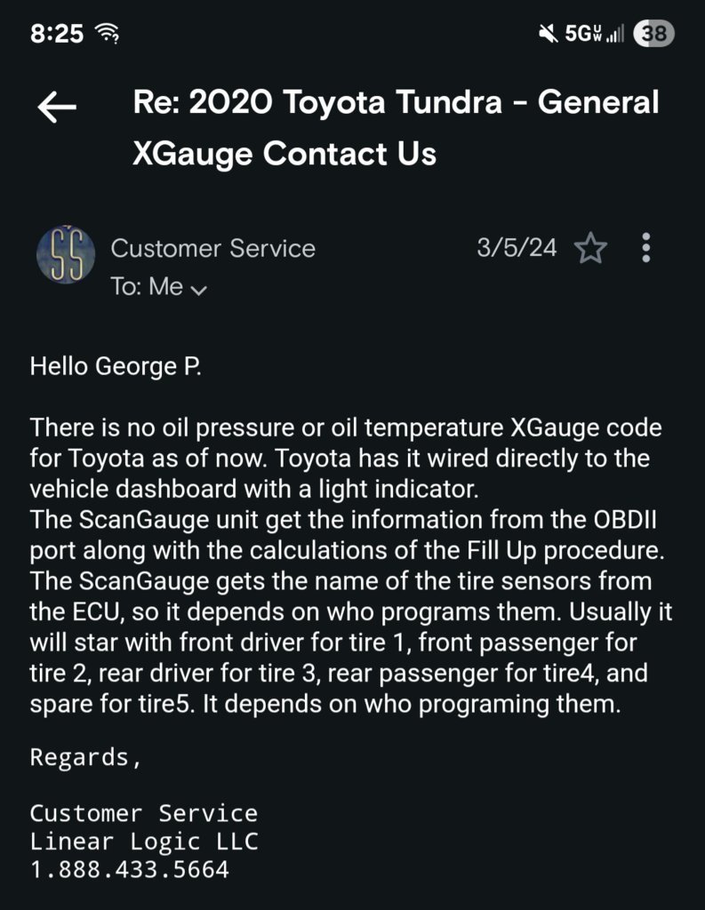

    I'll find the email and post it but they confirmed that there is no PID for oil pressure on the 14-21's.

    Here is the email from March 2024. I just emailed them for an update.

    Right, wasn't doubting you George, but just stating that their website is alittle, ahem, out-dated.
    Some newer stuff might can be had if asked, I am not sure why they don't just update it....

    What mount is that and how did you hide the wire so clean? Been trying to get a better look than the suction cup above the left vent.
