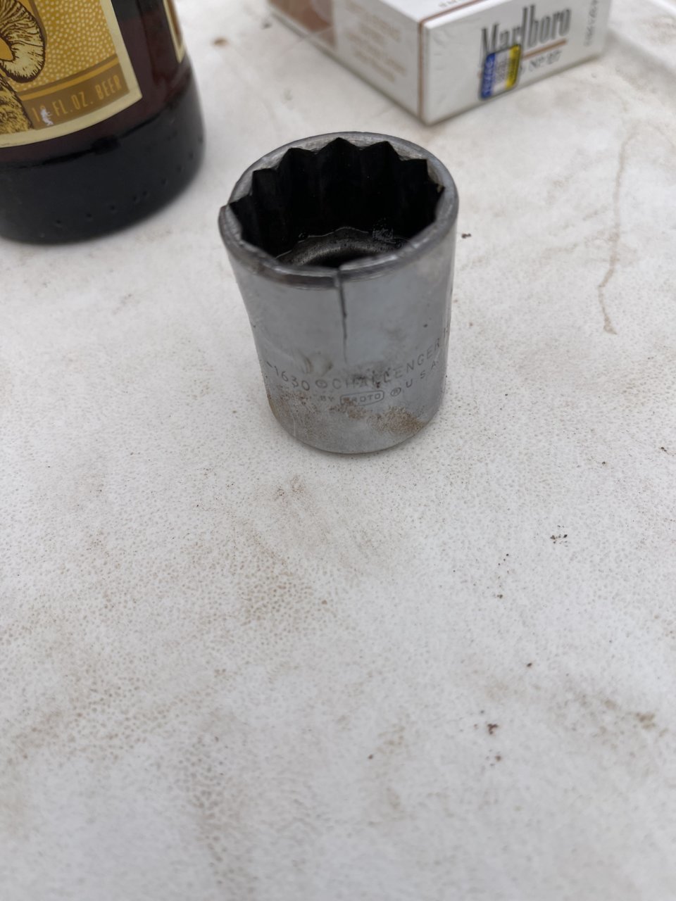

    The mangling might have gotten out of hand.

    The only 15/16” we’ve got. But 24mm fits.

    What’d you guys crank on?

    That was from removing the driveshaft flange to change the carrier bearing.

    I hate 12 pts; they round off nuts too easily. I always buy 6 pt. instead.
