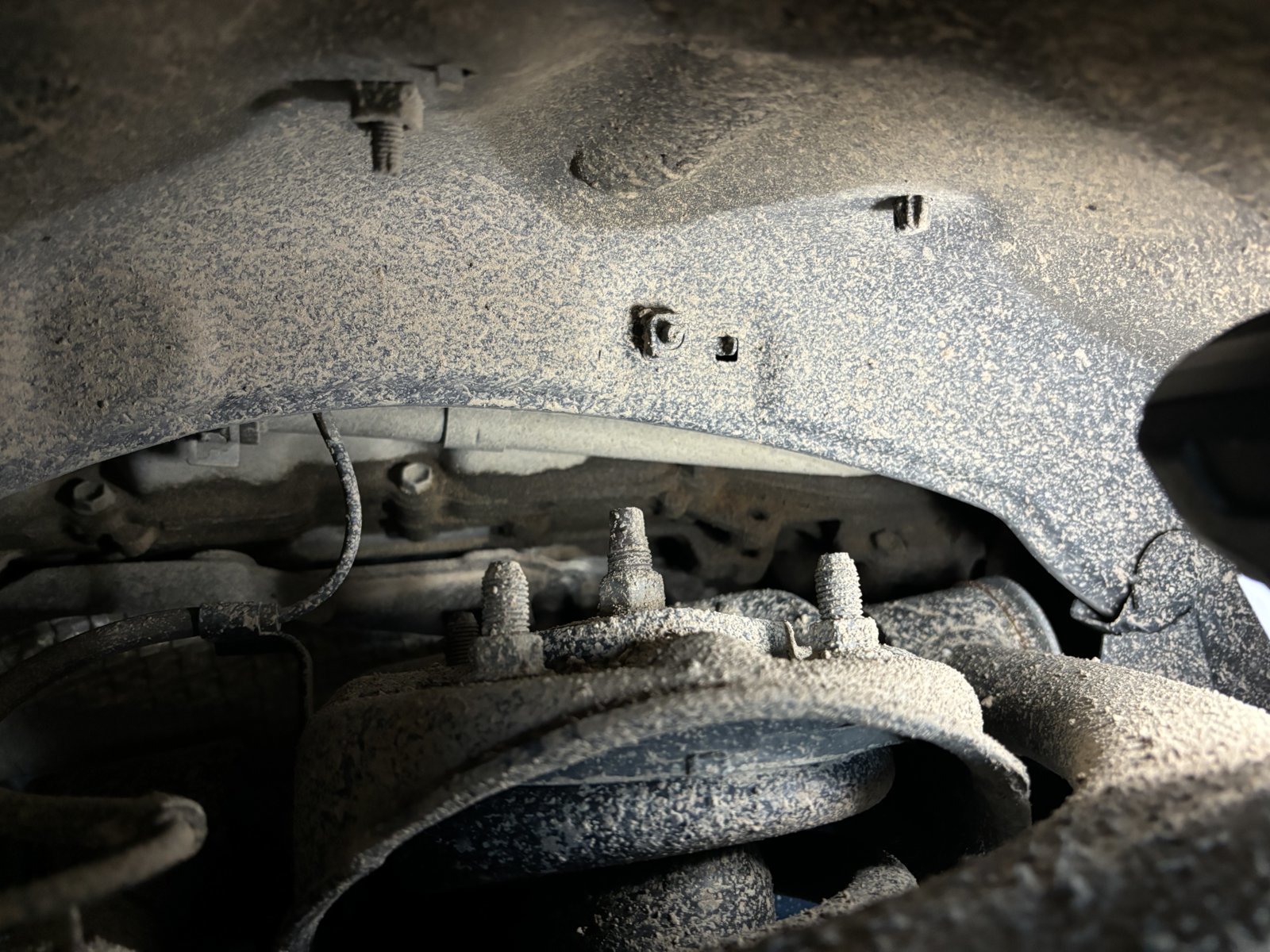

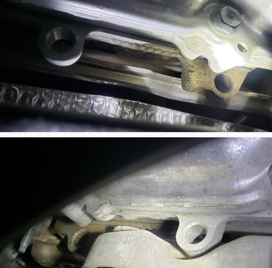

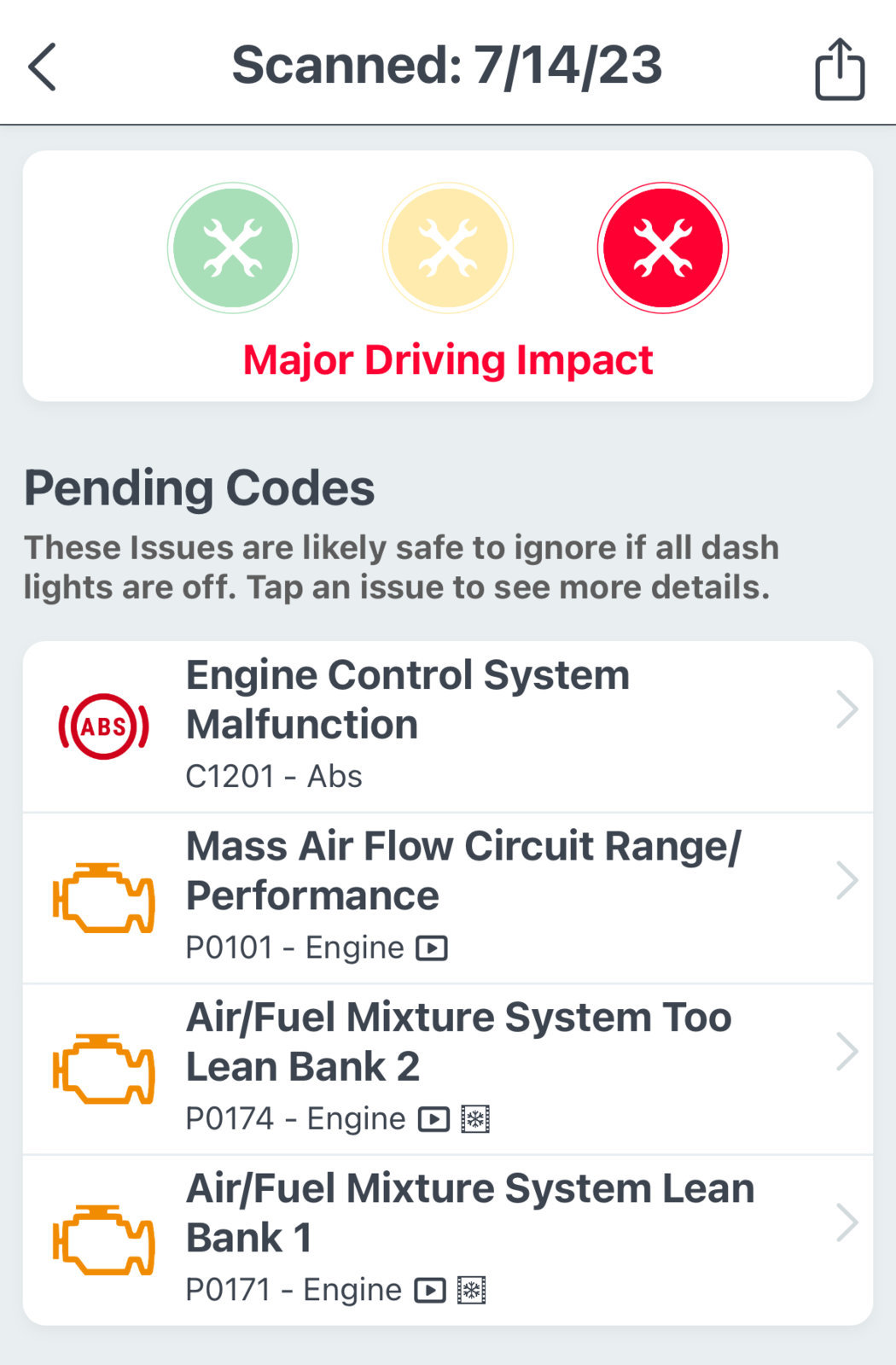

    Tend to agree that the valve cradle leak is not causing massive power issues. Injectors are definitely a good thought. Plugs look stock (I was going to replace them when I found engine oil on the outside of the plugs.) Attached is a picture of the cam cradle leak from the passenger wheel well and the historic codes. IMG_3849.jpg IMG_3850.jpg

  6. Jul 10, 2024 at 3:39 PM
    42,964
    That cam tower seal is only seeping. At least on that side.

    Hard to see from your pictures, try to get in there a little better.
    https://www.tundras.com/threads/cam-shaft-tower-seal-leaking-please-read.20102/
    Here's mine, both sides fixed under warranty at 17k miles.

    Test your oxygen sensors. Maybe clean or replace your MAF sensor. See if you're going into closed loop or remain in open loop.
